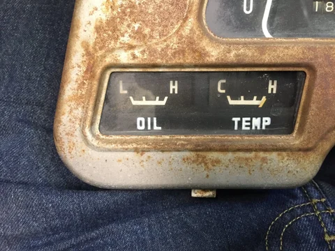

If the needle is beyond the H at rest, the guage has already been shorted at least once.

Damn, well i suppose i will be checking out your shop as well. When the 40 is off, key out and the wire to the sender unplugged the temp needle buries itself past the hot, so i guess i screwed it up. But it does react to battery grounding. Could i have fried it and my spare sensor be ok, but its just not registering in the guage because i fried it? I did go ahead an order an aftermarket temp gauge, but i like my original ones also. Its just nice to have a backup to these old units. I just want to avoid buying a $40 sensor, plus a gauge (which i havent priced) if only 1 needs replaced. Guess i need to start somewhere....

This is where the needle rests on a 'normal' early guage.
If real-world info is what you're after, aftermarket is the way to go.IMG_1067.webp
Nothing wrong with that gauge. It shows H when the key is off.
Touch the TEMP sender wire to ground and turn the key to "on".
If the needle starts moving, the gauge is OK.
Don't do this to long or you'll burn up your gauge.
