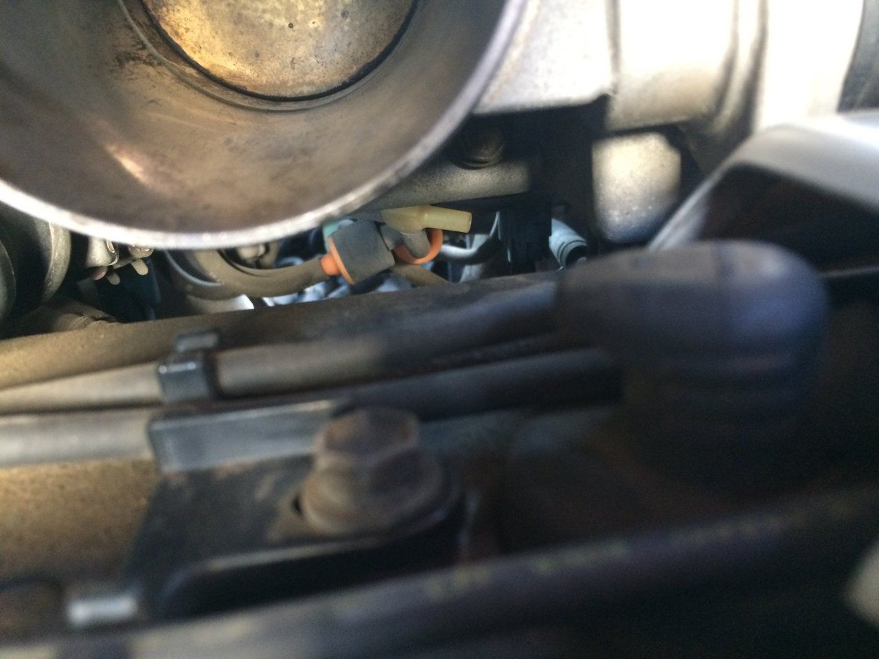

I have done some research and have checked all vacuum lines and everything appears to look good. I also checked break booster hoses and intake hoses and I do not see any cracks. However, when I removed the intake hose I saw a "T" for vacuum line exposed with no line attached underneath the throttle body. There is orange connectors and one side is not connected but I do not see any hoses to attach to it. But it is very tight and I don't want to take apart the throttle body. I will attempt to add picture of what I saw. Any help is appreciate.

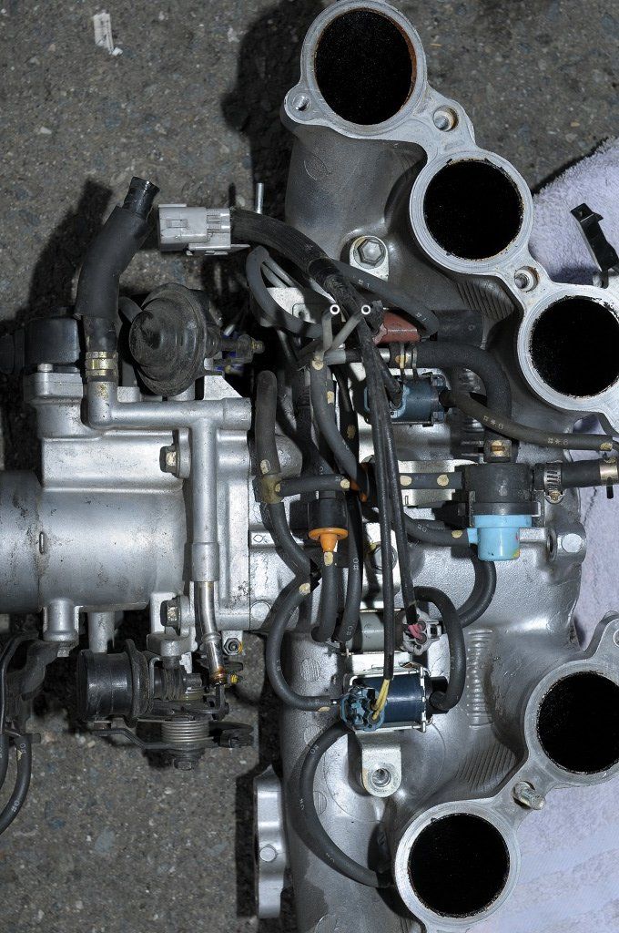

Not sure what you are missing exactly, but attached are two photos that may help.
Awesome I see where the missing goes, not if I can figure a way to get to it. Otherwise I'm going to have to do some wrenching
Will most likely fix it completely. A missing bolt in my egr made it run so bad, I had to time the lights to get home.
Replaced the bolt, all good.
Throttle body is 4 bolts that are easy to reach. You don't have to undo the throttle cables either. Just take the 4 bolts out and move it out of the way. You'll be abke to see it.
Good news.
