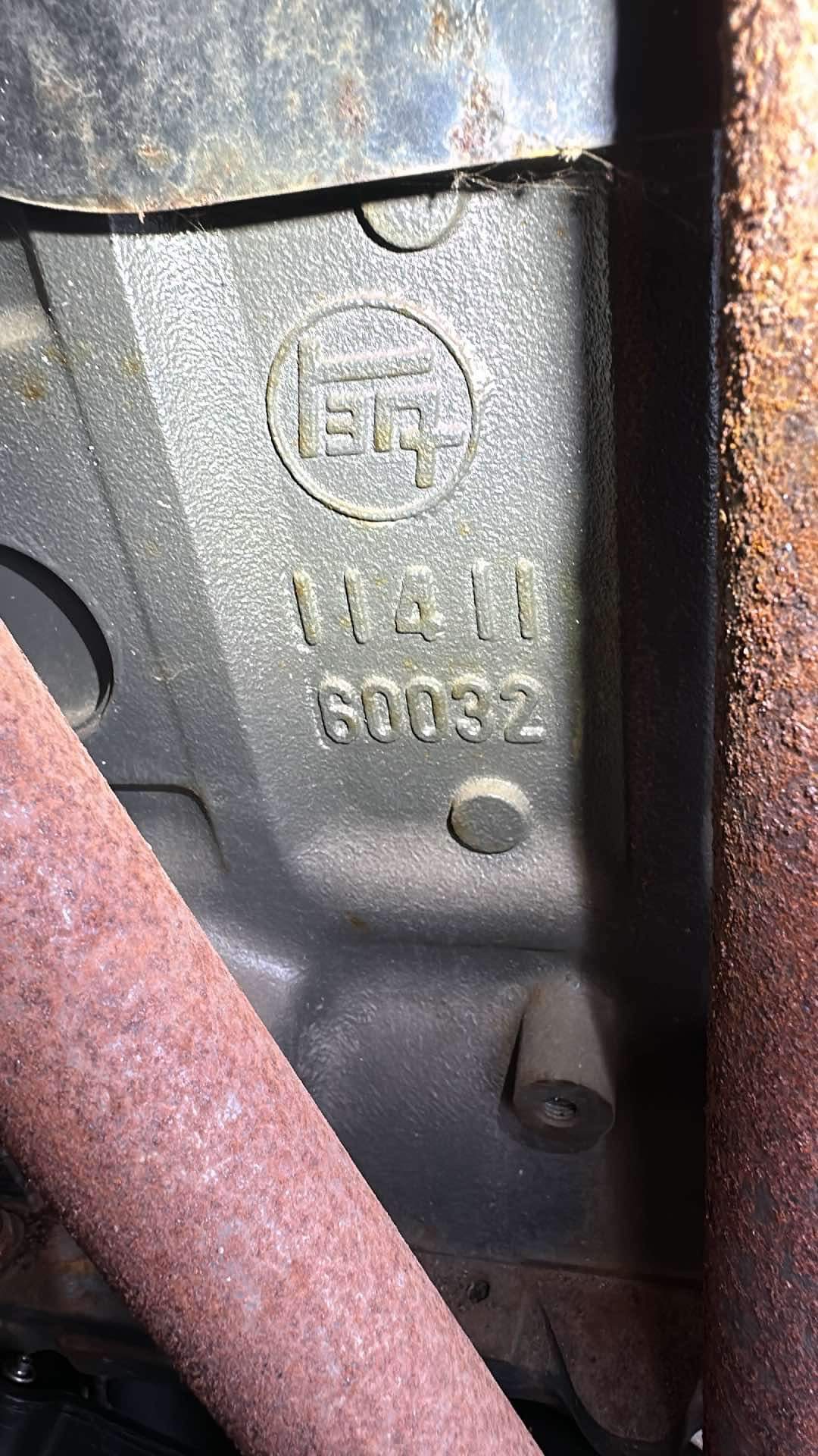

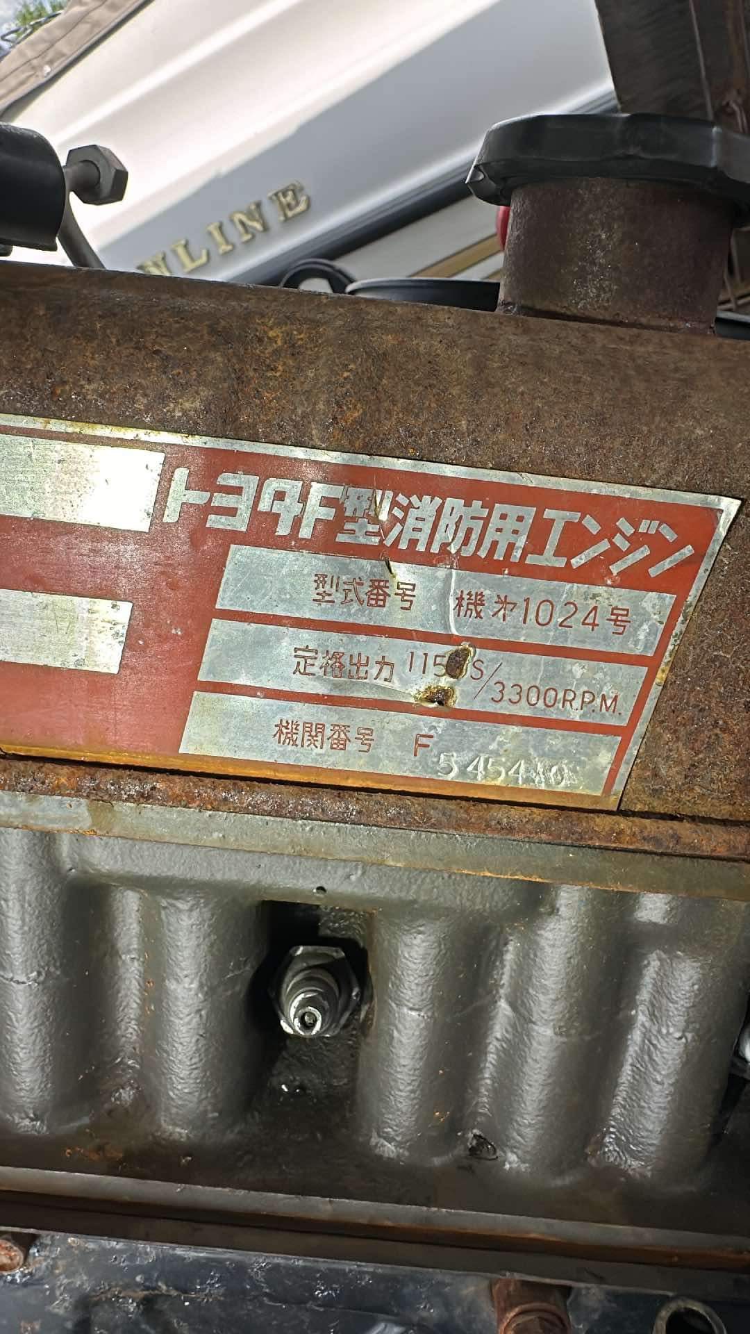

Looking at buying this engine as a replacement for my 78 fj40. Being advertised as a 75 2f.

$1200, no comp numbers or oil pressure numbers. the motor was pulled for a ls swap. All new gaskets installed painted just a light refresh. Comes with trannys and t case.
Just trying to confirm it’s a 2f and the year. Still learning very new to the 40 scene.
I think that is older than 75. My guess (and purely a guess) is because that is a 3 speed bellhousing and clutch, F intake manifold and stamped valve cover. All of these things are changeable between the years so could’ve been swapped on. The oil filter on the passenger side makes me think it’s what some refer to as the F.5. Would need to see that stamp pad number.
It’s also the older vacuum actuated 3 speed t case and column shifted 3 speed. Could be 75 out of South American or other import?
Not a 2f. Maybe a late F, (F.5).
I would be suspicious of some selling that as a 2f.

As Shreddy said above. So many parts are interchangeable. It woyld be unusual for someone to put a bunch of F engine parts on a 2F.
It is common to see 2F parts on an F engine.
May 28, 1974
Your first picture, 40528 is the casting date code. So the block was cast May 28, 1974.
What I’ve found looking at several 68 through 74’s comparing the casting date to the chassis number, the block casting should be 2 to 4 months ahead of the chassis.
Example, my 68 had a build date of February 68 based on the chassis number, the engine casting date was December 22, 1967. I have a spare F block that was cast November 12, 1967.
Those casting dates make sense…..as compared to the chassis build date.
