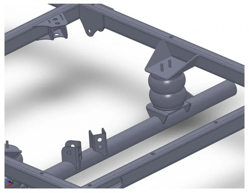

I finally have a decent design of the suspension I have planned. I scrapped the ITS suspension and went with a 4 link setup as was recommended. I attached some pics of the design (missing all the links, but you get the idea.) I still have some messing around to do with cleaning up some details and playing with the geometry but I think its pretty close.
What do you guys think? I know you must think I'm crazy for building a 4-link, airbag suspension for a glorified beer trailer....cause I certainly do.

Any particular reason that you went with a 4 link over a 3 link? I see plus' and minus' for each, just wondering why you went the direction that you have.
FWIW a better tongue design is for the diagonals to go under the main frame and meet the outer longitudinals about where the frame bracket for the outer/lower links are. This doubles the bending strength at the critical point in the frame - at the front-most cross member. I know most people build their frames for this sized trailer as you've modeled it and it appears to work, but it is not a good design. Have a look at Trailers, How to Design and Build (GOOD GRIEF those have gotten spendy!!) for how to set up a simple Shear-Moment diagram.
