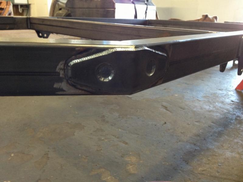

I started putting the brackets for the trailing arms on the frame rails. Feel free to call me out for fully welding everything before all the pieces are fitted up.....I sort of got ahead of myself. There will be a second bracket on each side mounted to the cross brace

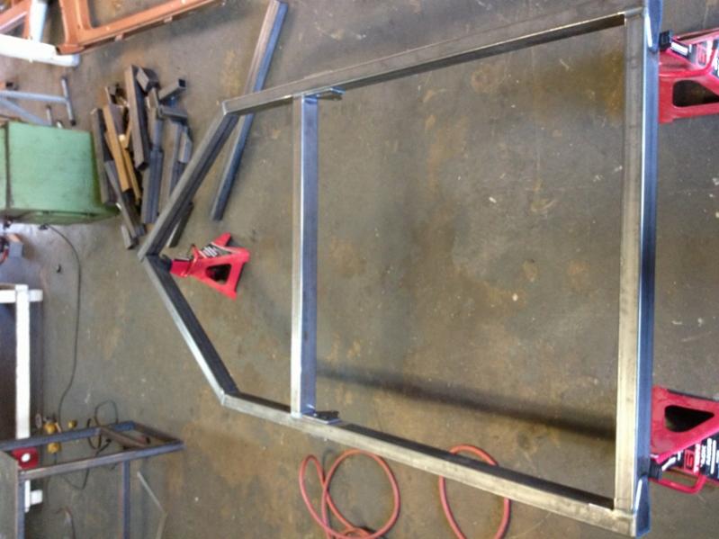

Here's Pretty much how it sits now. I've got the frame welded out. I added another cross brace right at the angled miter that is not in the pictures though.
I've been working on designing the trailing arms. I'm going to make them from 1.75"x.25 wall DOM, and use 5/8" Heim Joints on the ends. I figured that will give me some level of adjustment for both the length of the trailing arm but also for aligning the wheels. ....If the parts arrive today I might start piecing the trailing arms together this weekend.
