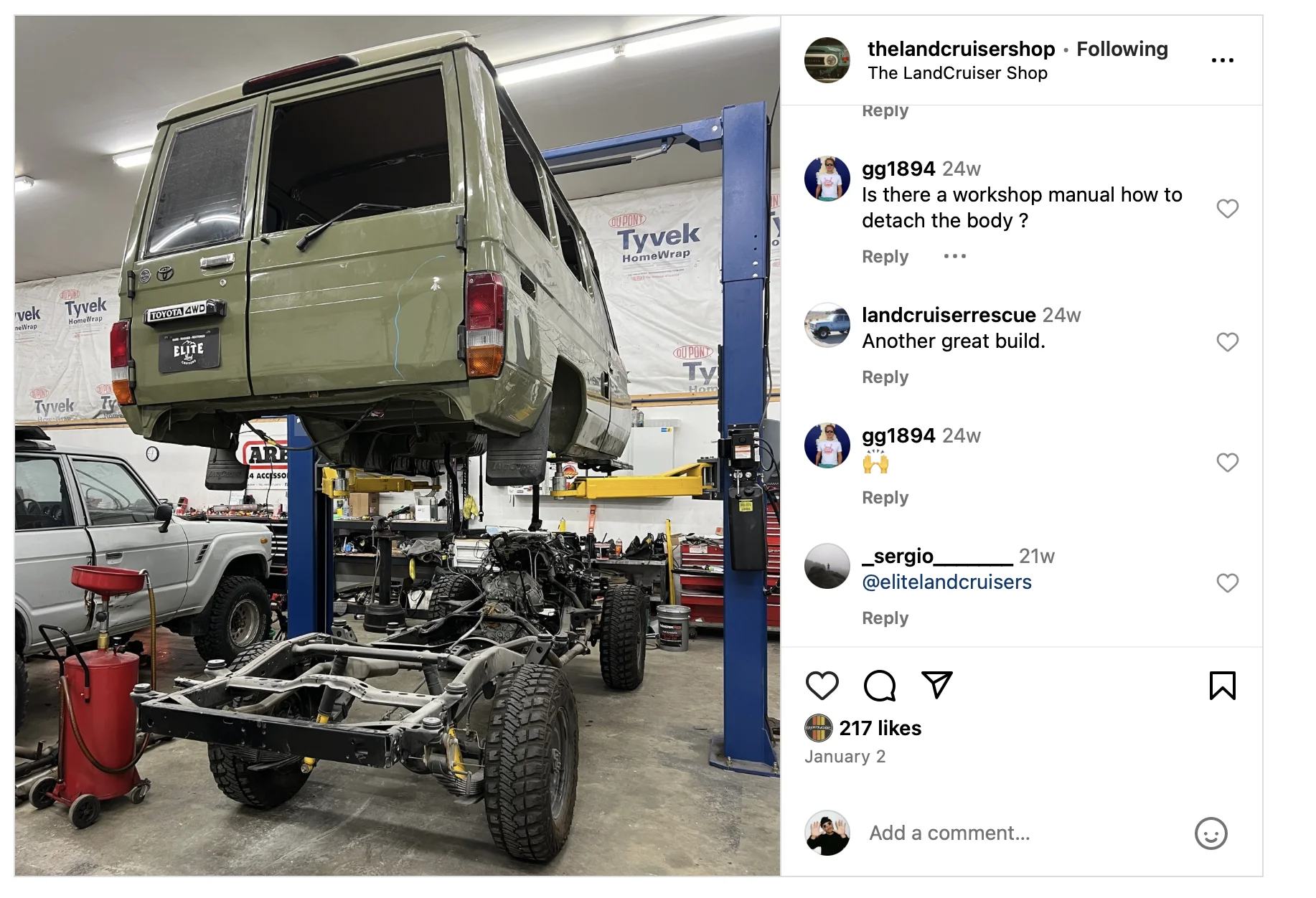

Check out: Land Cruiser shop in Idaho they do some awesome work. See them fixing an elite cruiser build in the photo

This cruiser was wrecked by the new owner on the first day of ownership before they even got tags. It was an icy bridge on way home through Texas to California on this HJ75 Troopy. The owners insurance would not pay full value since he had not asked for agreed value policy for full restored value before he took delivery. It has nothing to due with Elite Land Cruisers quality of work.

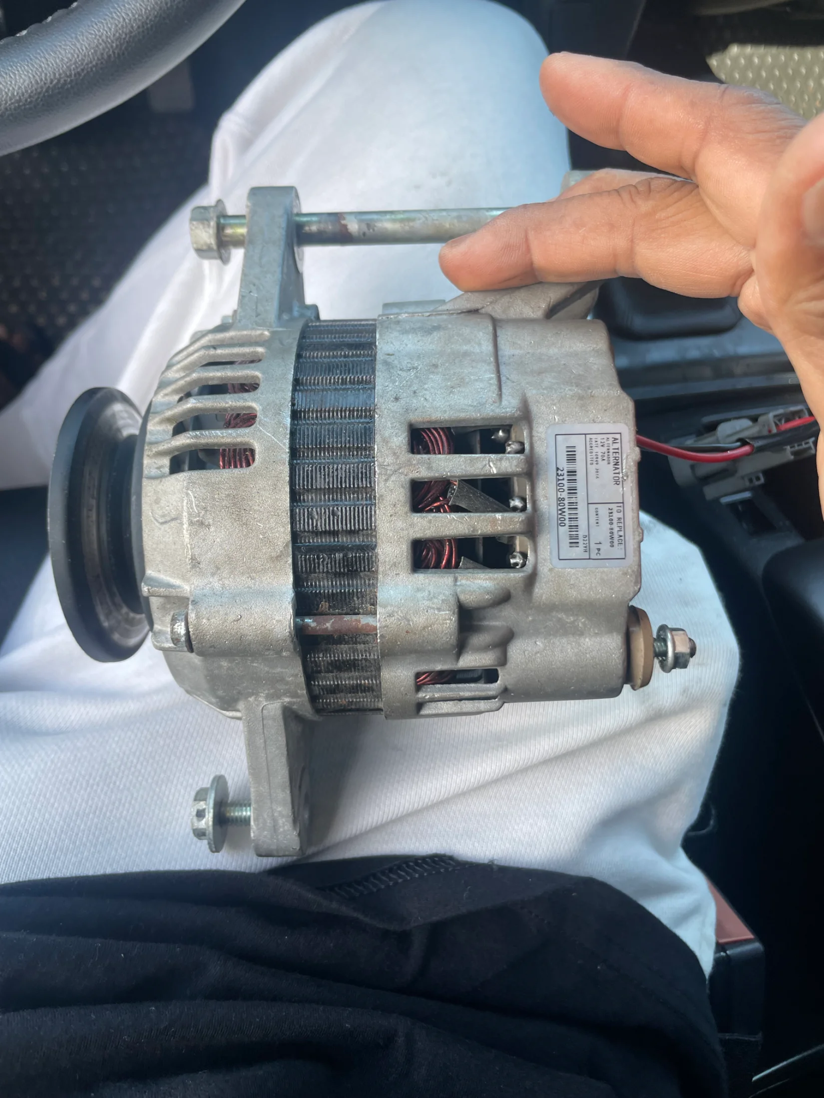

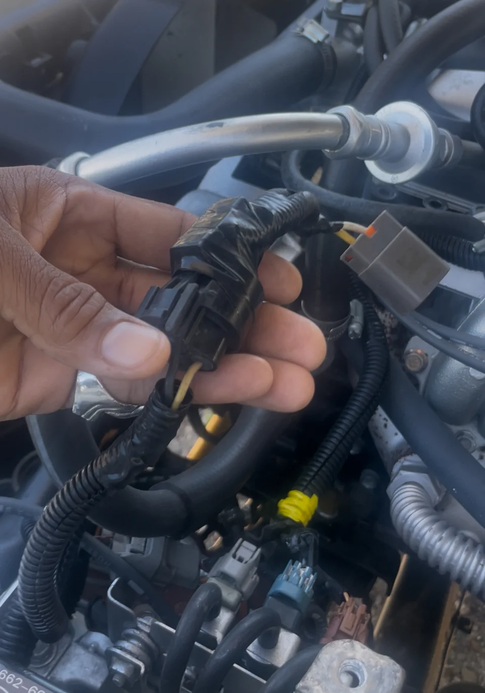

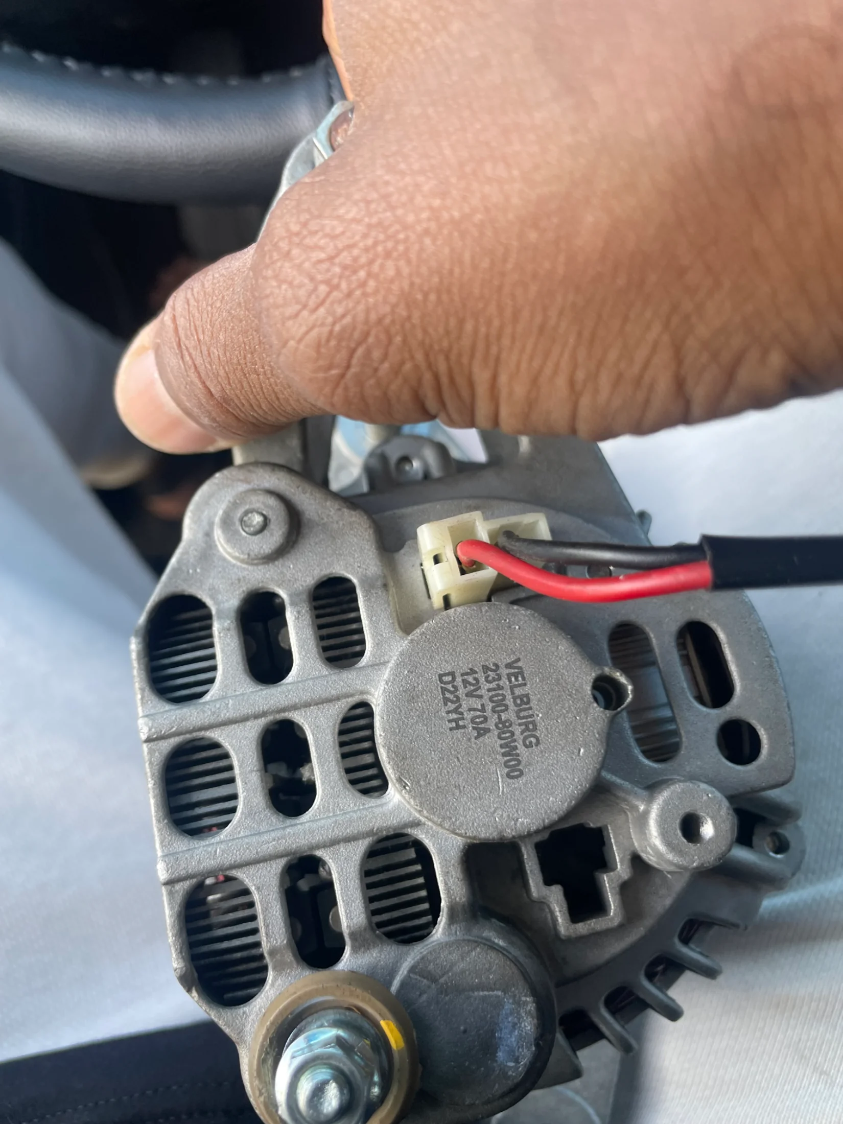

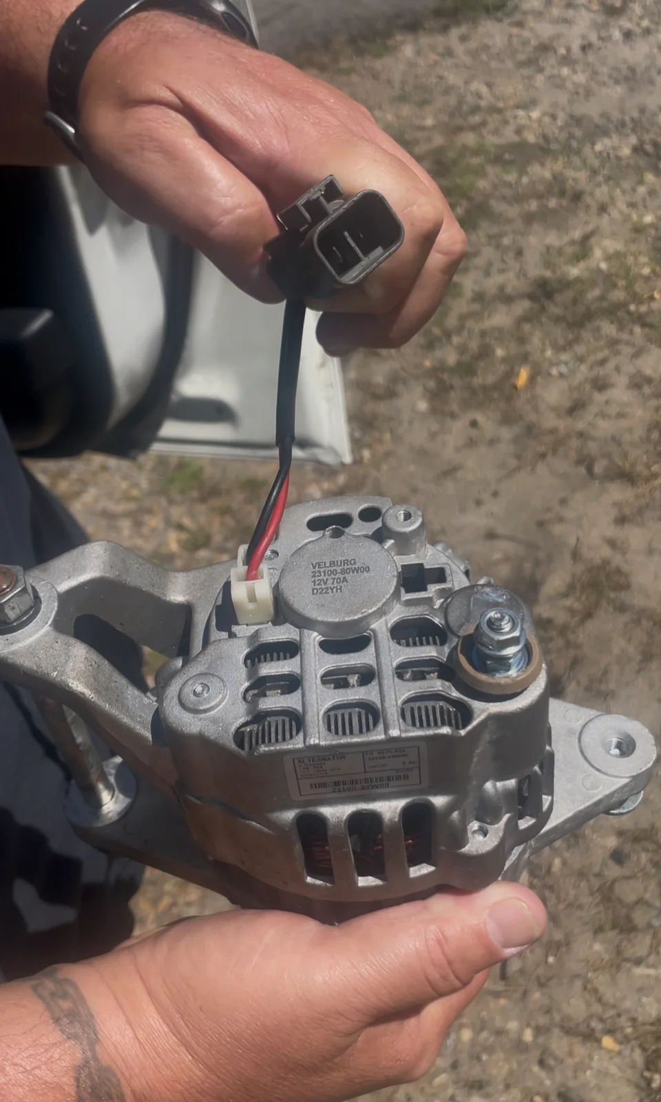

Im dealing with a full resto from elite… why theres an alternator that shows up as a nissan part and jimmy rigged tape to make plugs line up. Totally unelite. Alternator goes bad after 500 miles. Electronics like wipers and widows and radio all fail unexpectedly. Im gonna have to do a few more modifications to right some of these wrongs. Bad bad bad. Now there is also so much that is amazing about the truck but jimmy rigging alternators is just not cool.

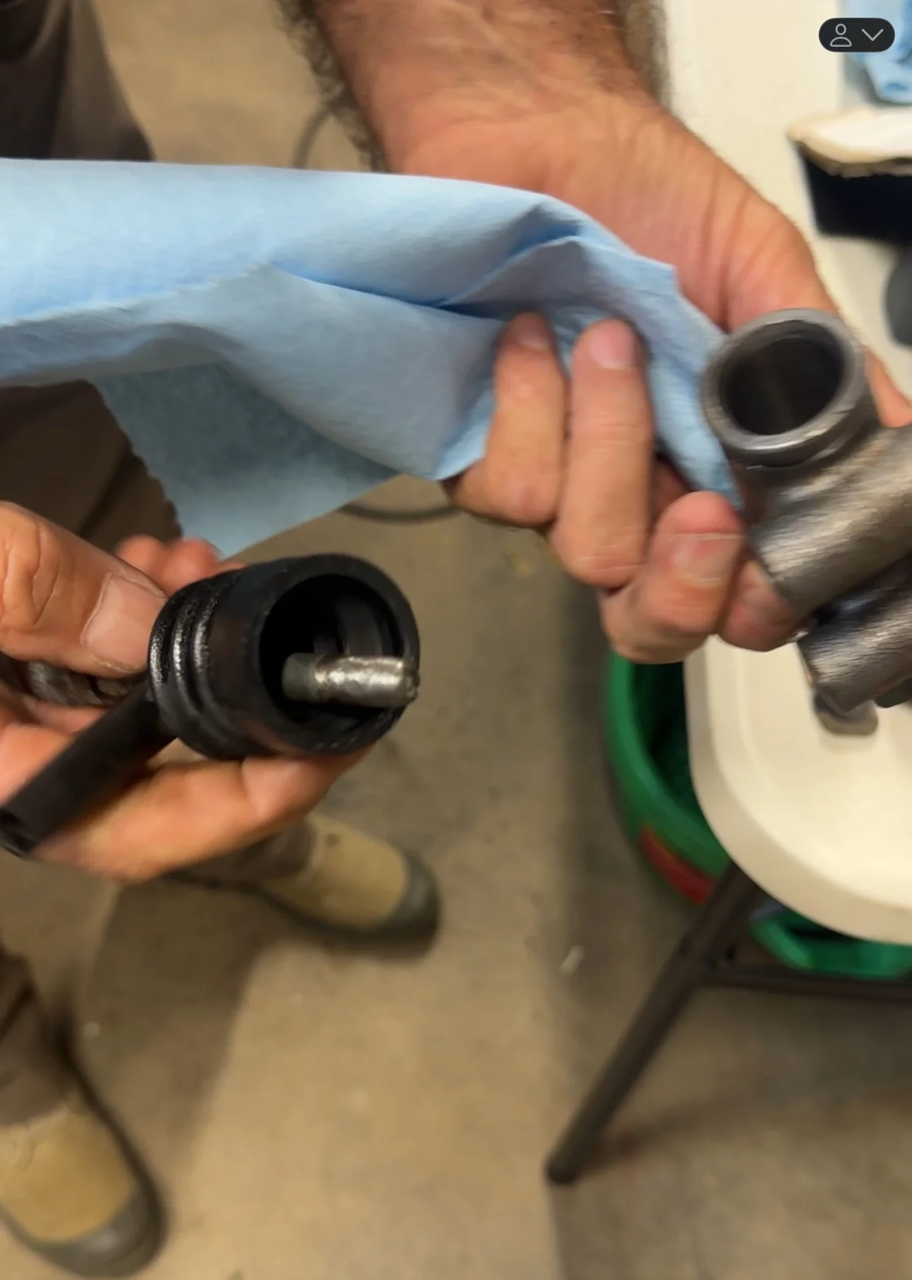

Yea moving forward here too unfortunately. One of many issues is the clutch. Just replaced the Clutch Release Cylinder....the one Todd used had no spring or piston and cap assy! Total BS. Photo documented. Didn't fix the clutch problem so expecting the Master Cylinder to messed up as well.
Wow. That's insane. New slave cylinders are readily available from Toyota.

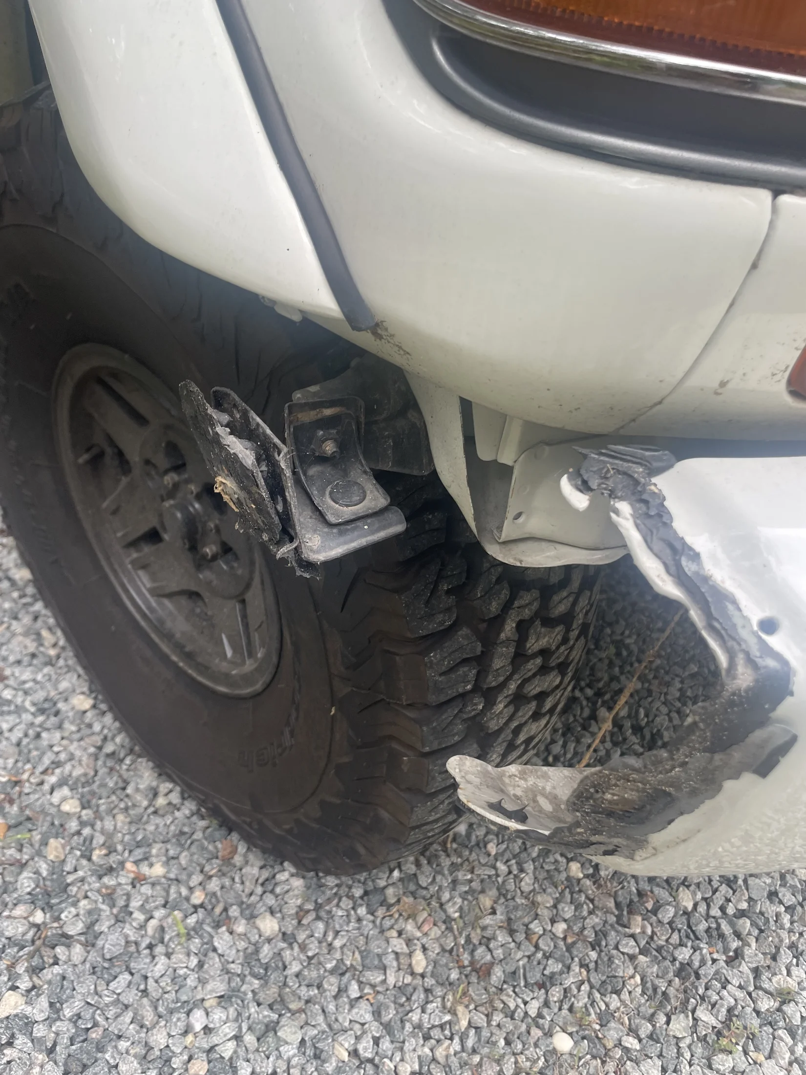

Yepp and official remanufactured alternators etc etc. Geez a nissan part and underpowered at that. The friggin corner rubber front bumper just falls off only to reveal tons of dried up glue that finally gave up. Its like all the pig’s lipstick is finally wearing off. Crazy
Yepp and official remanufactured alternators etc etc. Geez a nissan part and underpowered at that. The friggin corner rubber front bumper just falls off only to reveal tons of dried up glue that finally gave up. Its like all the pig’s lipstick is finally wearing off. CrazyView attachment 3980698

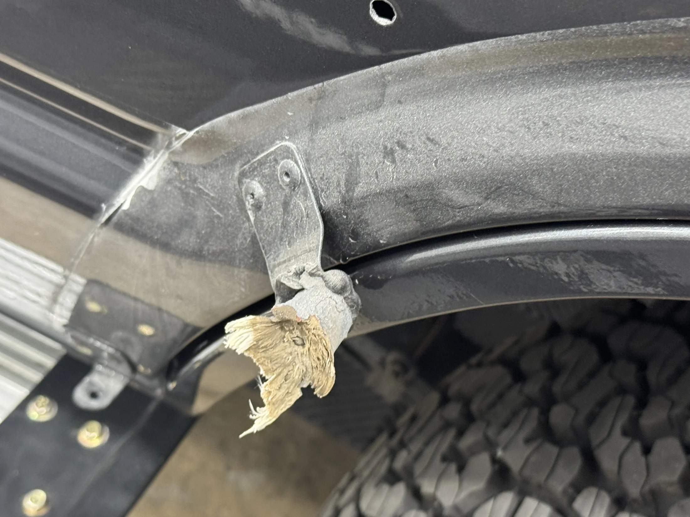

Omg! I had the fender flares glued on too! In fact they used a wooden door handle!

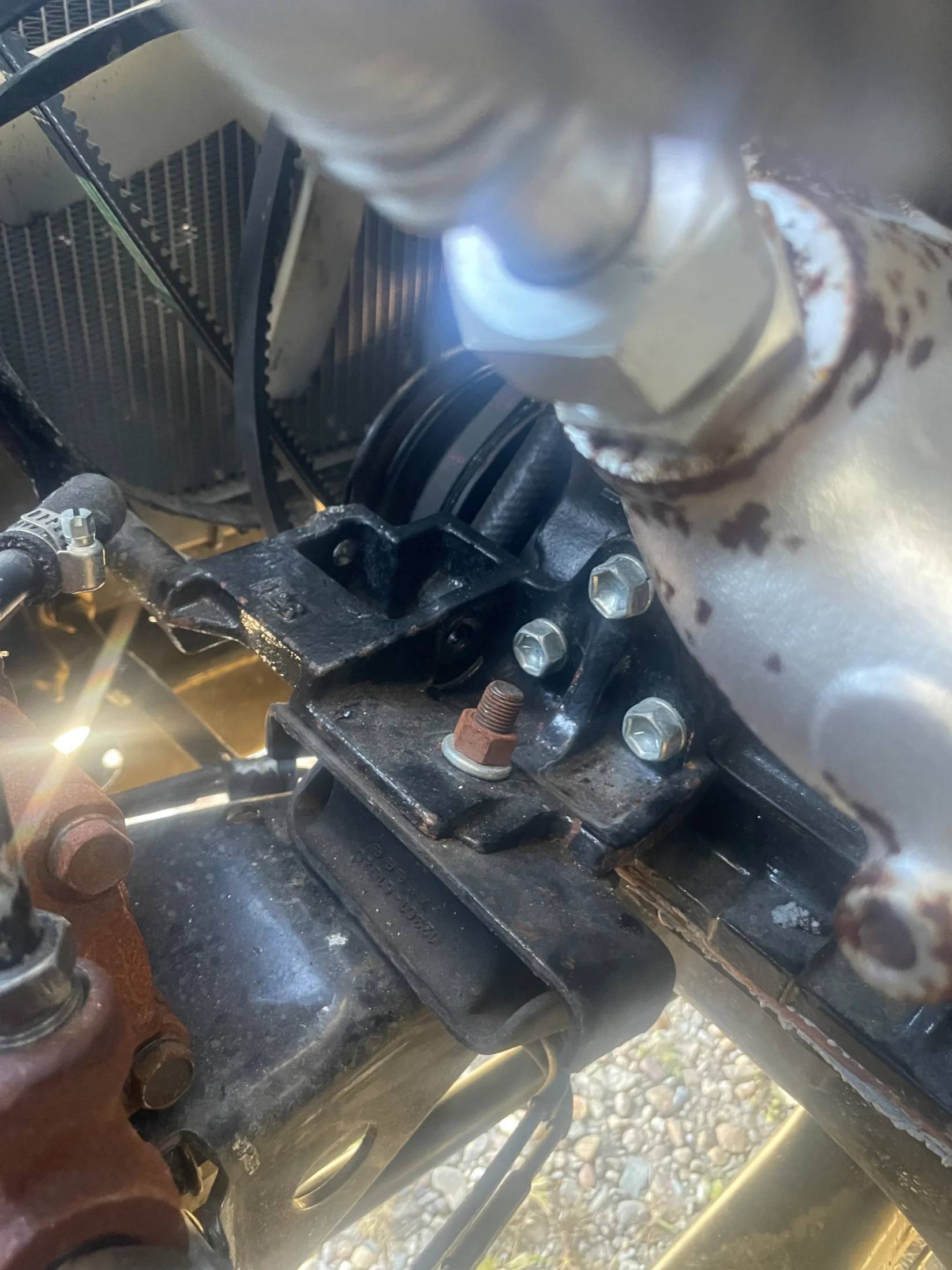

mismatched crews….it is like they used what ever they had laying around…..sad thing is all they needed were the correct bolts and everything is back to gather mostly despite only a few broken clips

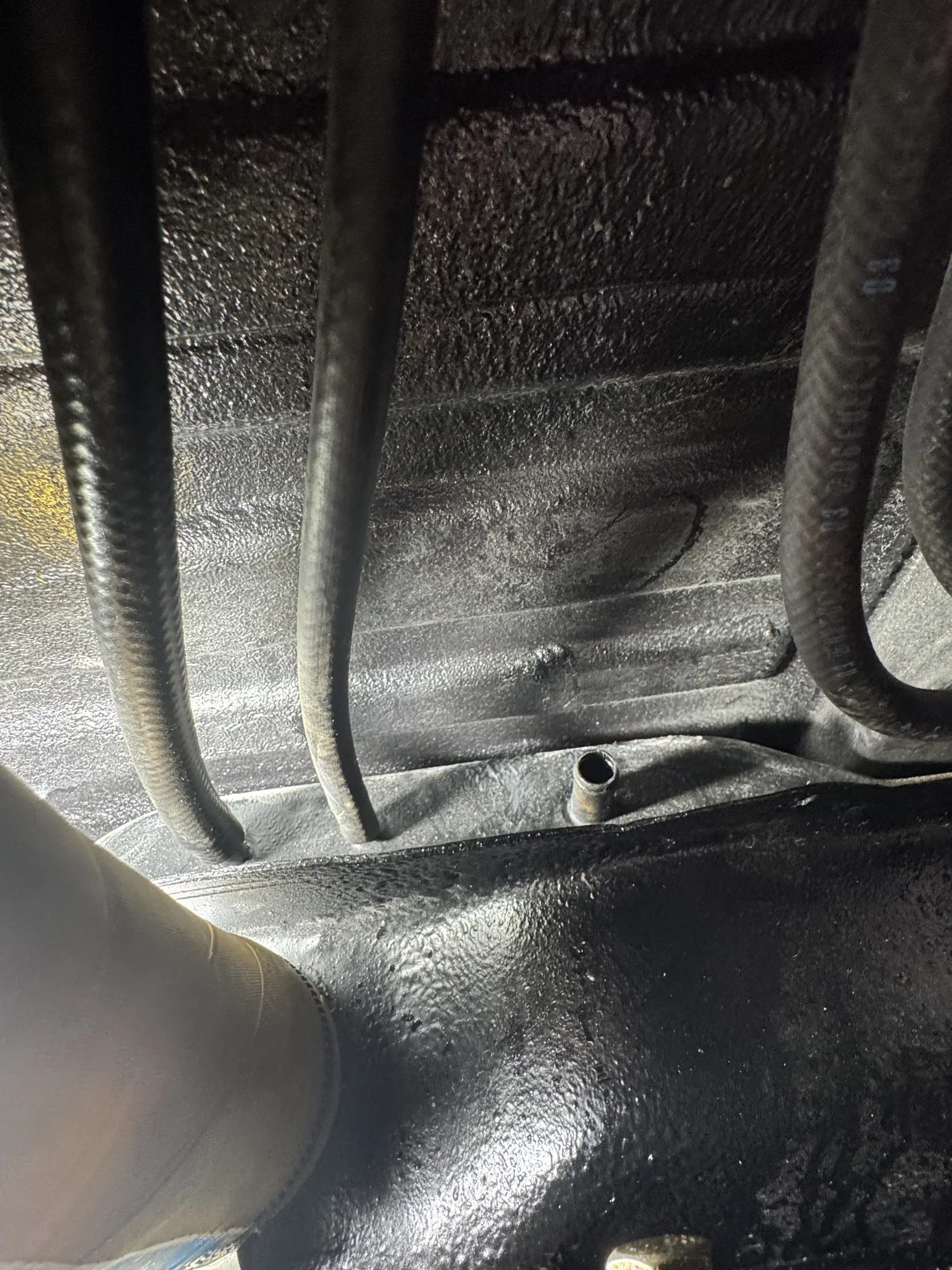

Truck was also delivered with a missing fuel vent line.....and zero hose clamps on the other lines.
