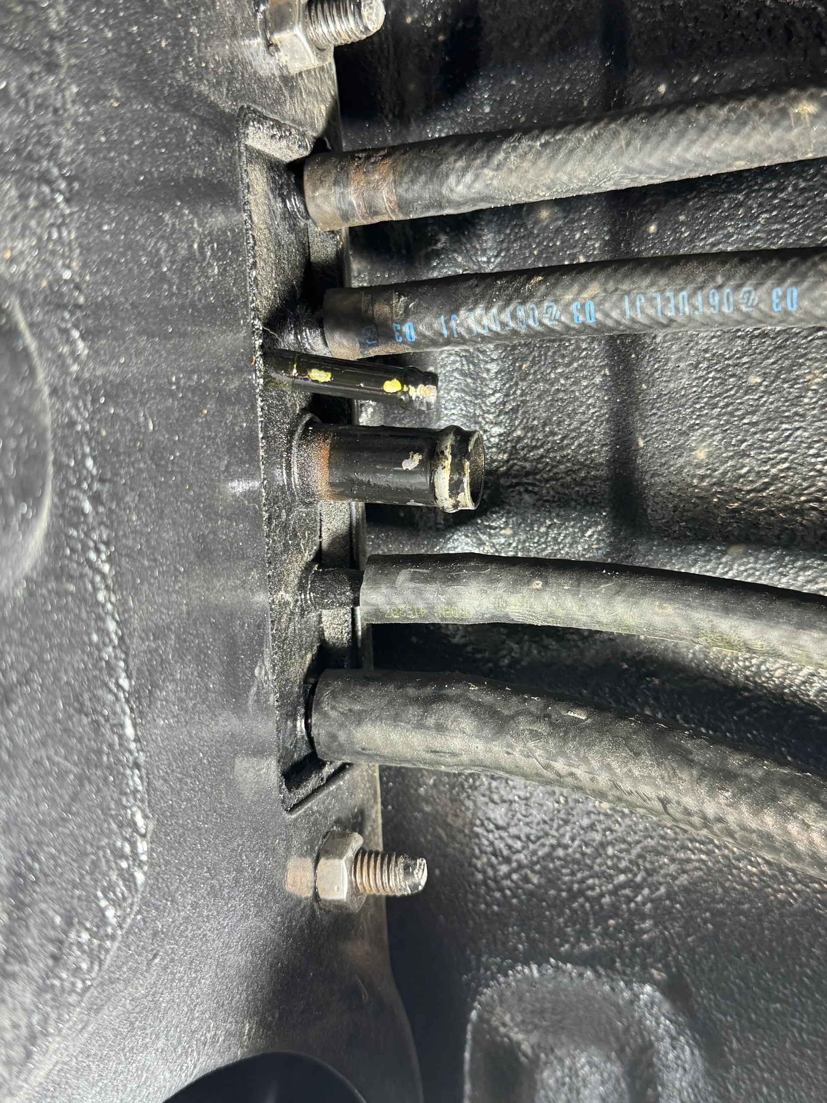

Truck was also delivered with a missing fuel vent line.....and zero hose clamps on the other lines. View attachment 3984353

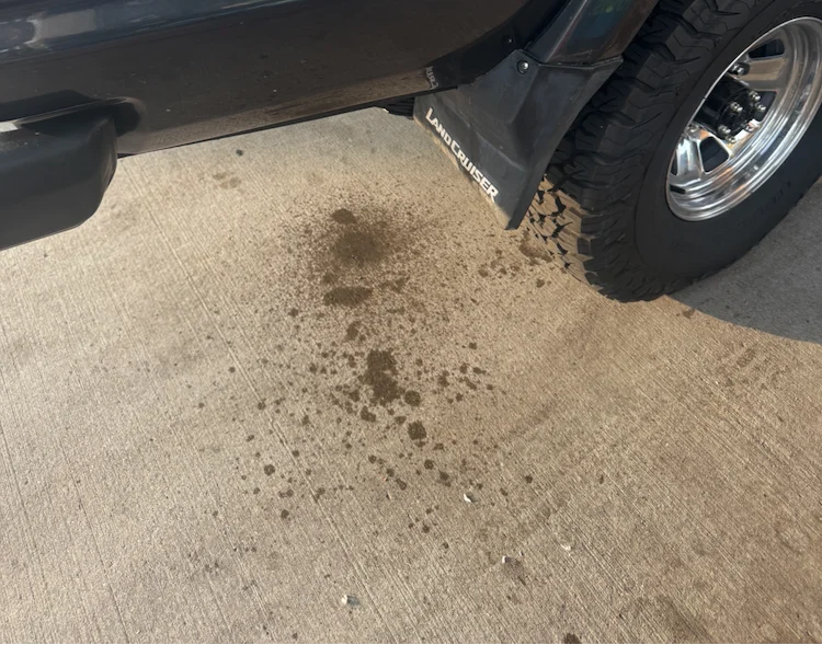

I fond out when filling with fuel right after delivery since it was sent on empty. ( You would think after spending that kind of money they would fill tank ) and diesel poured out from under the truck.....

It was sent looking purrrdy as can be... fuel lines not clamped or cinched down tightly... up comes a stream of gas pouring like an oil well... It was sent with a lot of lipstick guys. Paint and body lines and powdercoating and suspension and the engine bay and some of the interior look like it's prime time cruiser land.. but upon real examination, I have to ship this thing across the country to a real shop like Mudrak Custom Cruisers and when he gets done with it you will get the full unfiltered breakdown... point by friggin point. The network of real TLC fans and fanatics need to know how Un Elite the situation really is. This ish is unacceptable

The fuel tank vent hoses missing was just stupid miss and an oversight. The Alternator on the 80 should have been wired better. I am as surprised an anyone on the fender attachments- I’m furious about this as this work was contracted out. Clearly not visible for our team to know.
