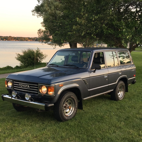

This is interesting
This is interesting
I like the idea, but wouldn't even give it a second thought until battery tech is vastly improved (nothing short of revolutionized).
This is interesting
Never thought I would see that! Yes very interesting that they have a kit for the 60 of all vehicles. It amazing that they jumped in value in just 10 years like they did. I used to pick them up for under 3-4k all the time in the 2000’s. Now they are in the $20k+ range. You can get fj40’s for less these days.
Similarly, this wouldn’t be a good application for my current use/need. But I’d bet some day battery tech will catch up to be a viable option for use beyond local commuting. If not battery tech, then some other power generation system will come to the forefront.
Either way, it’s cool that the potential exists to retrofit classic rides for continued use.
