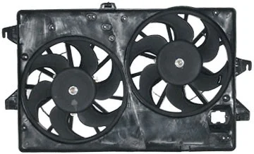

...the Contour v6 dual fan setup is the exact size of the 60-62 core and has 2 speeds...

I used angle brackets and bolted it right up. There is some trimming of the Ford mounting plastic tabs but no big deal. 1997-99 Contour V6

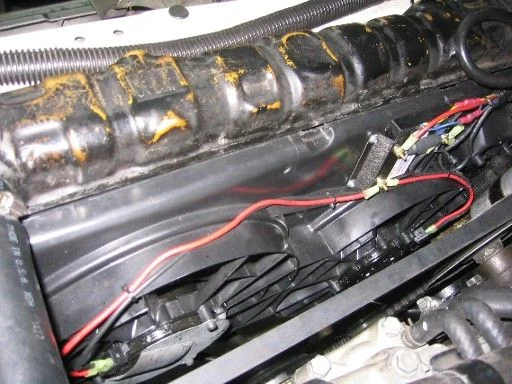

I justed finished dropping a Contour fan into my FJ-62 (thanks for the tip Gary!). Fits perfects. Lots of room in front of the engine now. I used 14ga angle steel to mount it. I had to weld spacers on to one to move the A/C piece out away from the radiator a bit to clear the fans. The only problem with this approach is that I have to pull the battery tray to remove the fan.

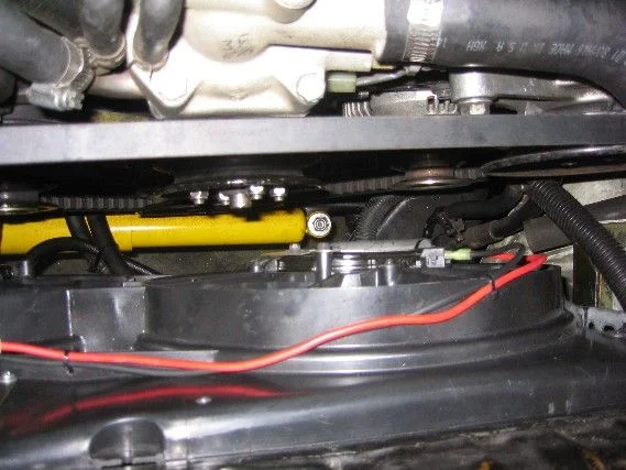

Not that deep. 3.4" per the dccontrol website. I set mine up so that the shroud is level with the radiator frame. It clears the 3FE pulleys with probably 1-2" to spare.

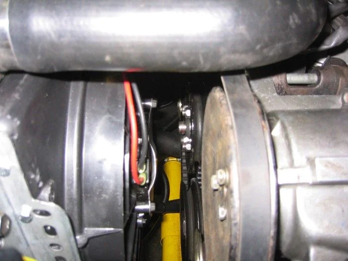

Contour fan install photos
Here are some photos of clearance for the Contour fan.

Couple more. In the second you can see the tabs I welded to the angle bracket to move the A/C dryer out away from the fan a bit. Unfortunately to thread the bolt through the tab I have to pull the battery tray. Oh well, at least everything is mounted solid.
