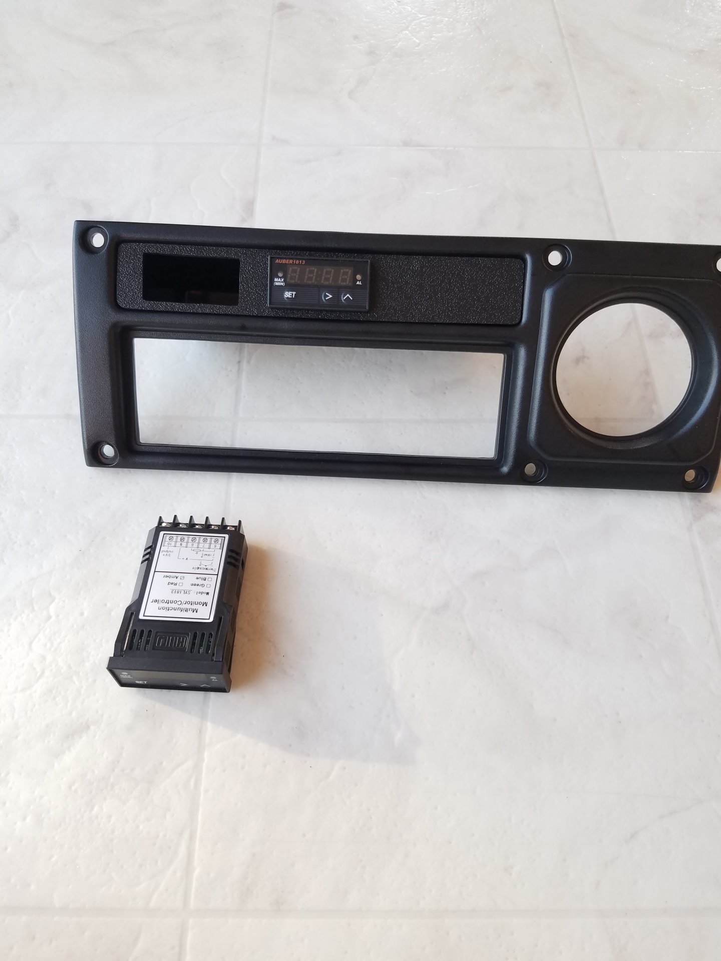

No doubt, the Redarc gauges a very good. Another option are Auber Instruments, about $90 per gauge and come with probes/sensors. They are low profile and seem period correct, and come in 24 and 12 volt. I'm using them for pyro, water temp and boost. I have had no issues with them in the 3-4 years they have been installed.

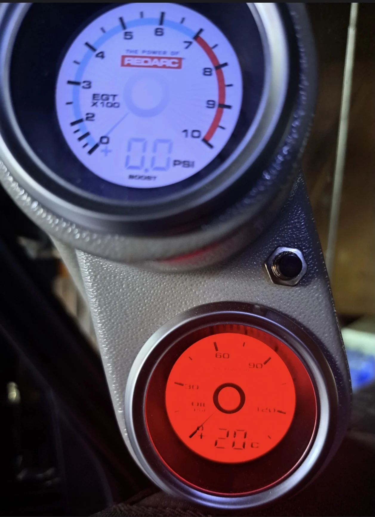

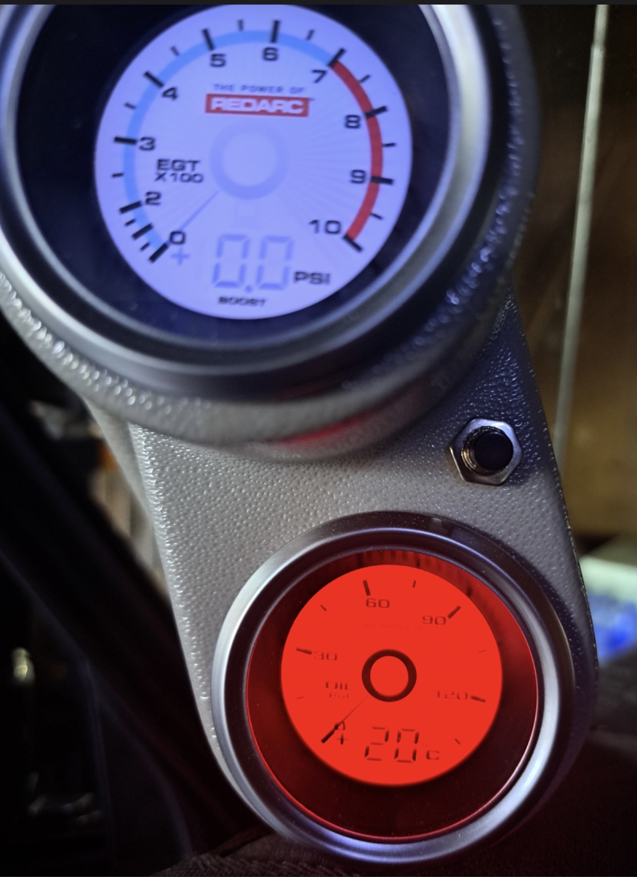

Here is an example of the “multi-function” feature. The top gauge has boost and EGT while the bottom is displaying oil pressure and water temp. The bottom gauge is displaying the “alarm” feature where the gauge turns red at a certain perimeter. (In this case, low oil pressure).

Here is an example of the “multi-function” feature. The top gauge has boost and EGT while the bottom is displaying oil pressure and water temp. The bottom gauge is displaying the “alarm” feature where the gauge turns red at a certain perimeter. (In this case, low oil pressure). View attachment 3593104
It’s really good looking and I love the alarm feature. It’s just high end of my budget for sure and as I kept looking after all the add ons it becomes very expensive. It is less than a cracked header though. Definitely a great gauge.

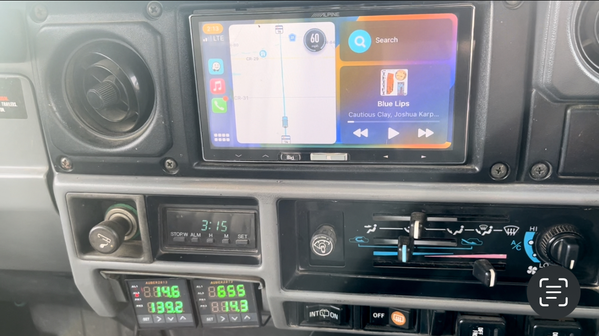

Another vote for auber gauges. I’ve been running mine for a few years. Boost/egt. I just added voltage and coolant temp.
Great price, they work good and you can use them for a ton of different applications. You can also trigger relays to start extra fans, trigger water/meth injection or even water spray to radiator.

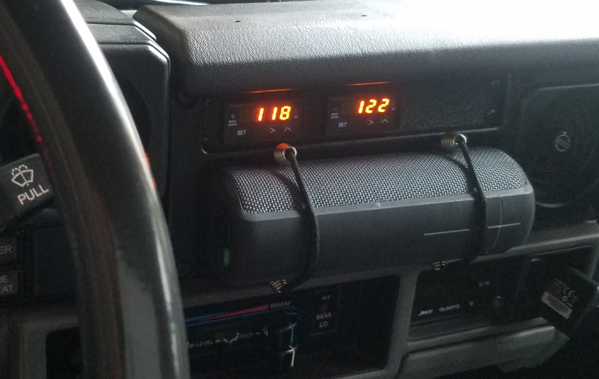

Here was my original temporary setup…that’s been there for years…
Right side is EGT/boost underneath.
Left side is voltage up top, thermostat housing temp on bottom.

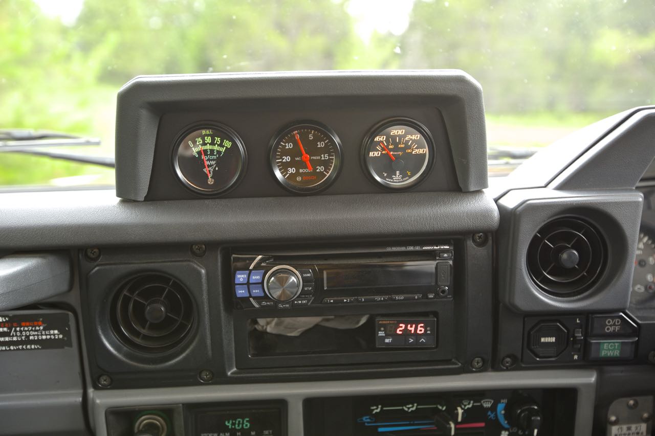

Another satisfied Auber user here. Have installed them in both of the LJ78’s I’ve had. This was my first one:
And my current setup:
