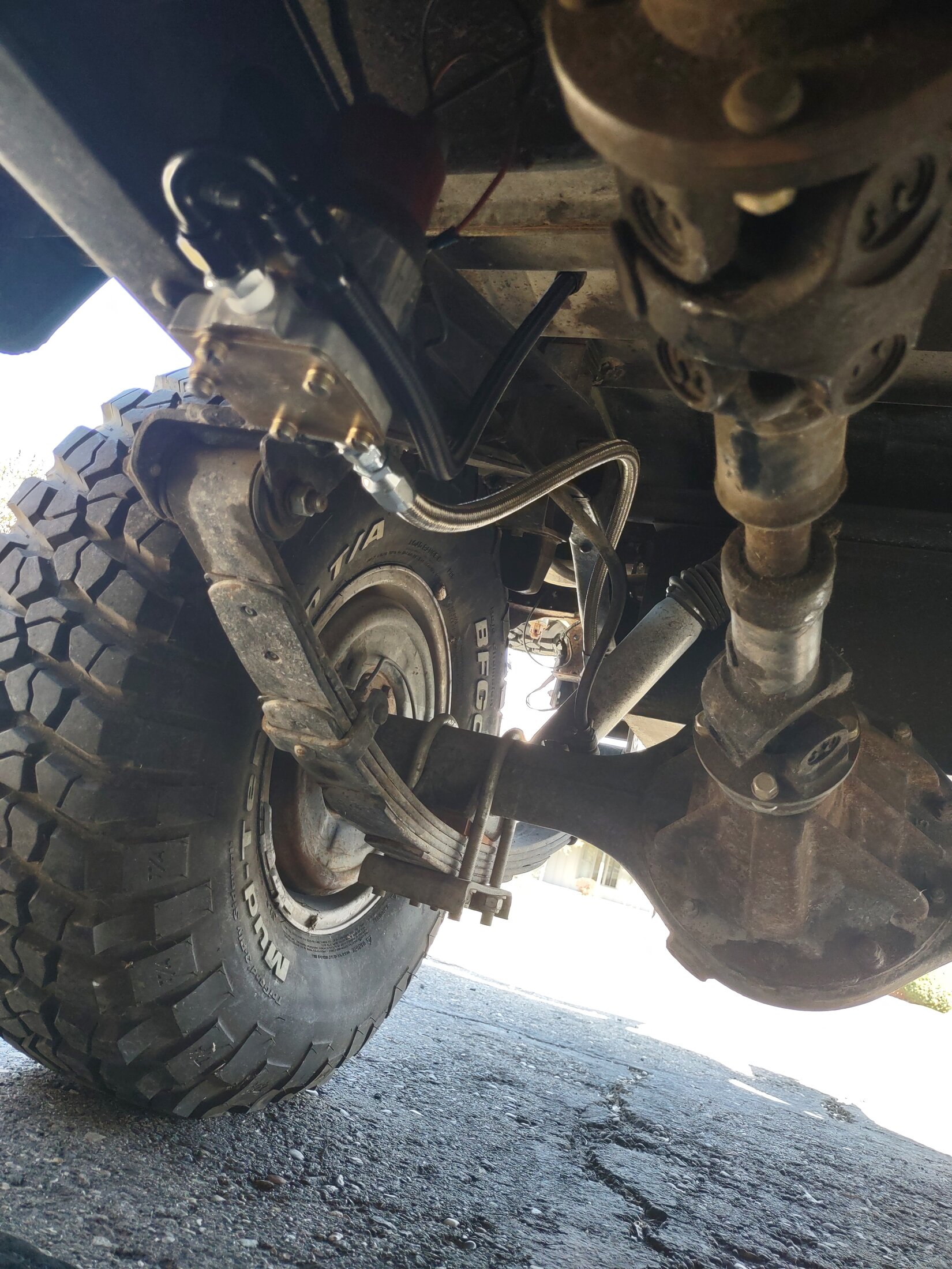

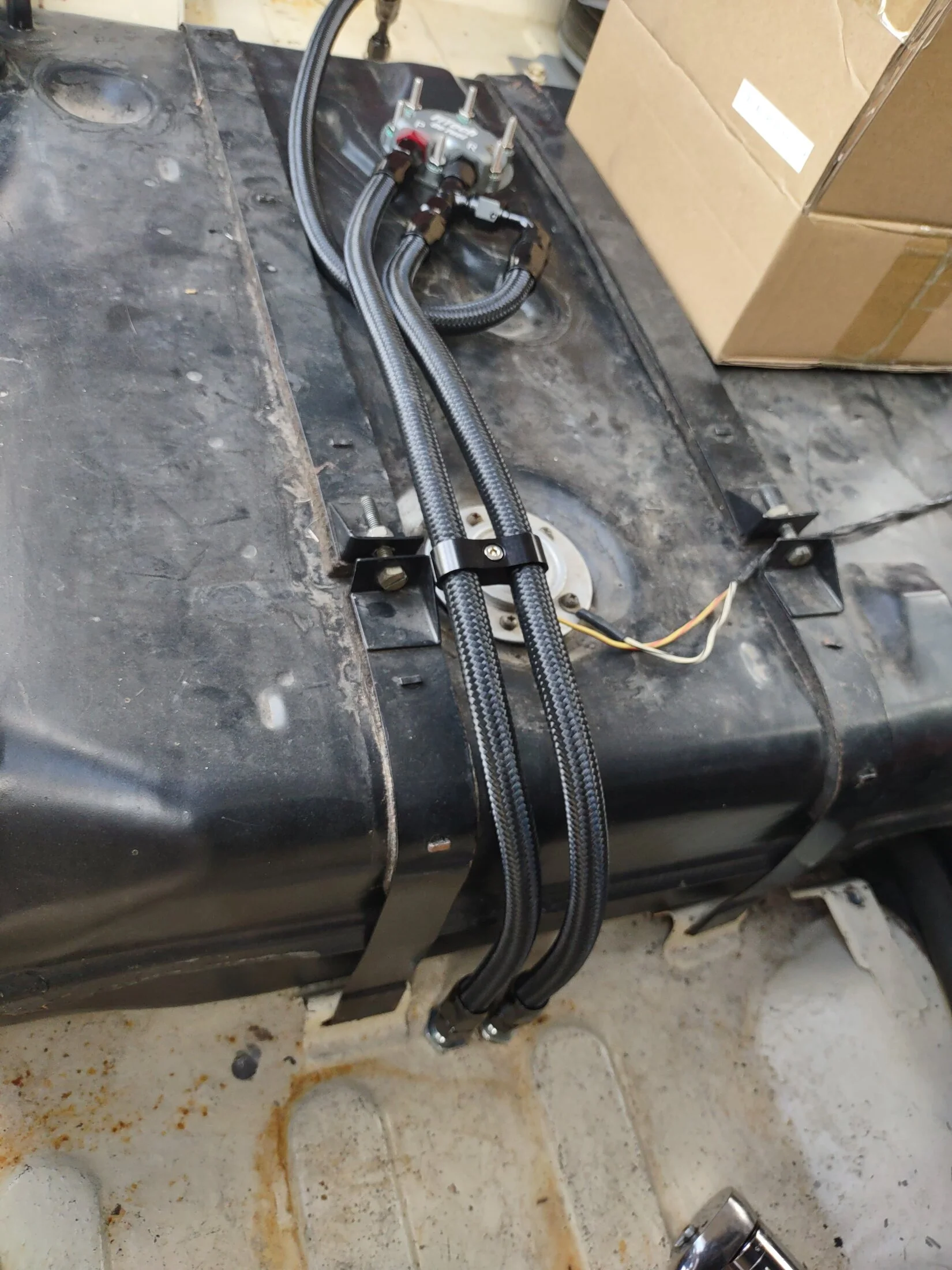

I just did this set up last year with a fitech efi kit. EFI pump in main tank in cab, holley pump sucking from secondary tank to transfer it to main tank. I T’eed into the EFI return line port at the main tank and used a check valve to prevent return line putting fuel into secondary tank.
Used a momentary switch to run holley pump so it cant be left on.
Main complaint is noise of EFI pump in the cab is pretty loud but I needed the original tank to be “catch tank” as it has level sender, secondary does not.

Thanks for the information and pics. How is the Fitech setup?
It works. Was pretty easy to install. And I have only 6-7 hours driving it in town to base opinion on.
Bought after getting tired of working on the holley 2300 on it I decided to try EFI. I am pretty holley knowledgeable but got tired of the bad gas and it sitting around causing me problems. Also wanted altitude adjusting aspect as I am in western Colorado and 4500’ -10,000’ is all in a days work.
Have hopes of tuning it to run really good. As delivered, it is a little slower than holley 350 2bbl, but not much.
