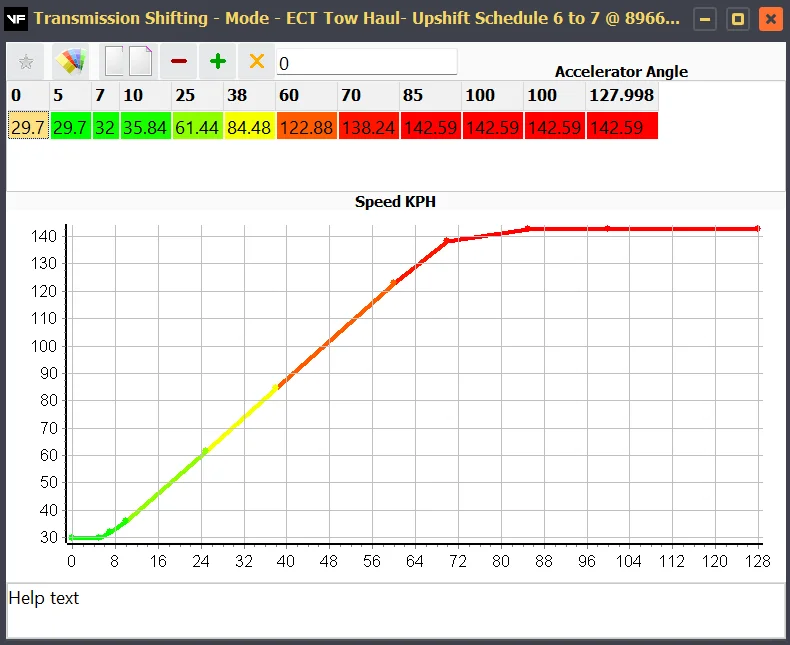

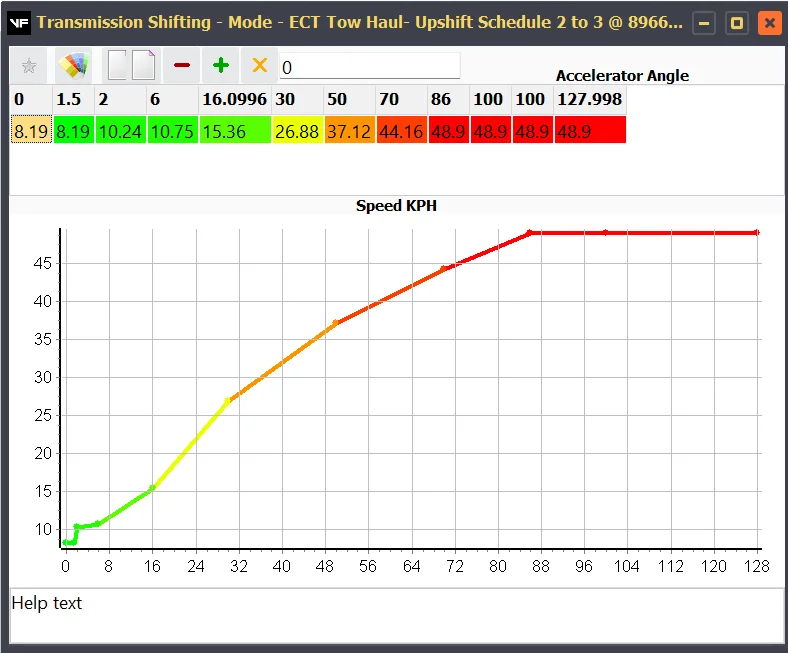

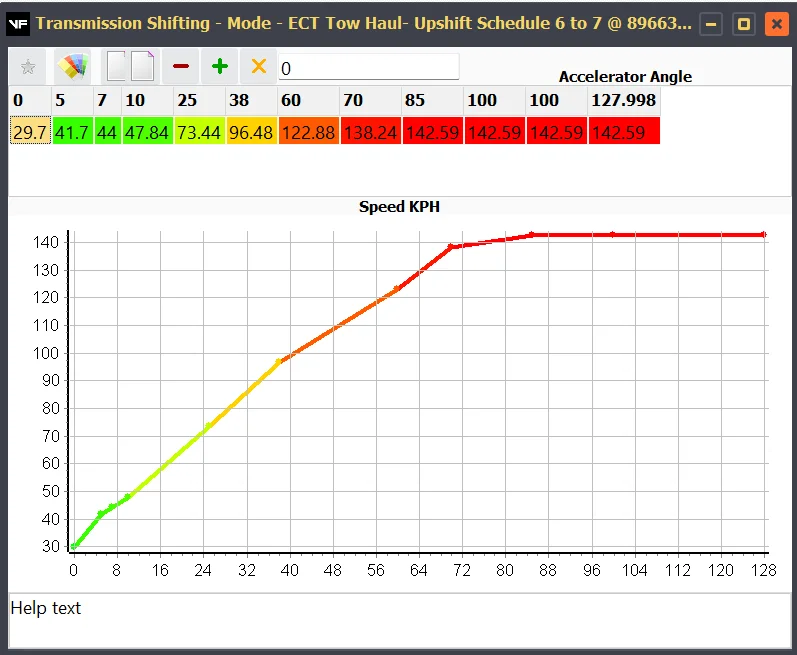

I'm pretty convinced that the ECT button in the 2021 LC200 is a placebo. I rewrote the ECT maps to see what the effect was. Basically I increased the up and down-shift speed points (except at the gear limit speeds) by 5KPH in gears 1,2 & 3; 7 KPH in 4; 8KPH in 5&6 and 12 KPH in 7 and 8. I realize this is not a very scientific approach but wanted to make the change obvious!
Result is a much different experience with the ECT button pressed!
Here are some examples:
Before:
After:
Before:
After:
