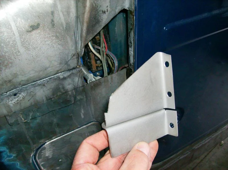

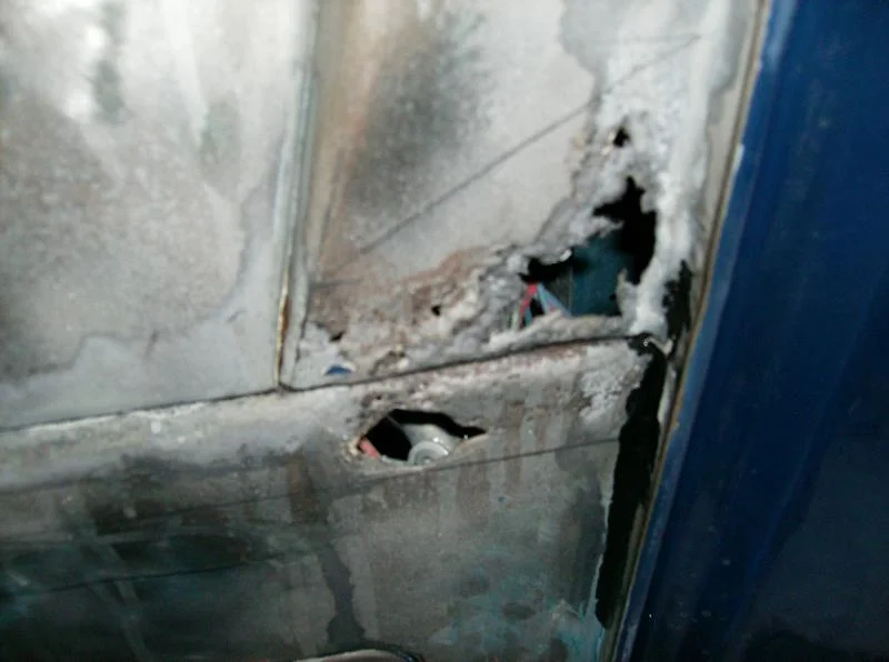

That's my fab on a different tub. Roberto contacted me to see if I could make him the same parts. I custum make pieces but there usually one offs. So I would need his tub to make it. In these cases I used a sheetmetal brake w/ machined dies to create the radius's. There's alot of measuring involved and each case is different. If I would have keep(or made) a spare as a guide/template I could have made more.

Thanks Diesel42, I am getting ready for my bodywork to go out and would rather send it out with something they can put up against the old, trace and then cut out and reweld new piece, if not my luck is they would try and fill with bondo with something behnd it. I know its not as easy as I describe above but when I go I am taking copies of your pics to show them exactly what I am wanting them to do so I dont get shortchanged. Thanks!!!

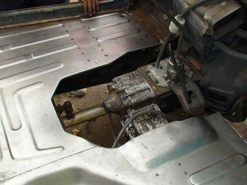

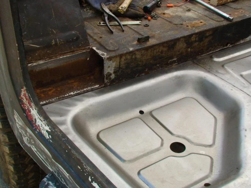

hey guys I found some pics of some job I've done in the recent past. This is the front floor for a 1973 FJ 40. I'll share with everybody this time....
check out the fit and the workmanship of this piece.
I don't see any seat supports(front left passenger) or captive nuts. I am not trying to bust your chops. Just want an answer to the upper question.
I will ask it again
Relax,
Remember that I said I do custom work? well this particular customer has a different set of seats from the original ones and will be making his own brackets. as far as the transmission hump goes, it is attached with captive nuts from the bottom. Did I ever say this was the finished work? because it isn't.
