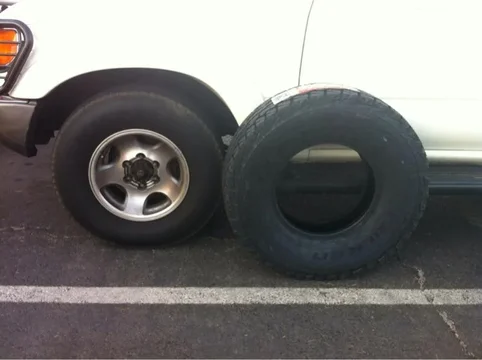

To the OP they do look nice!!Its nice having the tires out to the edge of the wheel wells.I've been running 1.5 spacers for a long while.....no problems!!I just re-torque them every time I rotate the tires.I bought (I think their called Spydertraks or something like that. I bought them from Slee)I wouldn't skimp on spacers I have seen some pretty cheap ones out there, I would get some quality ones because if they fail(break) the out come is very bad!!Failure at 70 usually = hosptial or death!!I think I paid about $100 a pair!Also the bigger the spacer the more strain you put on your wheel bearings.So I would think a 3" spacer would cause you to replace wheel bearings alot faster than a 1.5.Hope that helps!

The biggest issue with spacers is the extra leverage that they put on your wheel bearings. Moving the weight bearing surface outward while keeping the bearings in the same spot increases the load on your bearings causing premature wear. This is not a huge concern, but it will lead to changing out the bearings sooner than otherwise.....
I would imagine if you are running BIG tires like 35+, you will prob want to stay away from spacers, as you are moving lots of weight away from the bearings.
:meh: If you are running big tires, you are already putting bigger loads on the bearings. Other than the extra hardware, spacers are the same as changing to wheels with different offset.
With big tires, spacers can be a good tool to properly fit them. Picking the proper size is the issue, too wide and the tires hit the outer fender edges, too narrow and the contact is on the inside.

A little update as i just noticed this thread was pulled back from the dead, the spacers i bought back in 01-06-2011 are still running great! bought some new tires (305 70 R16's) and the truck looks just about perfect now! i dont really plan on getting a lift so for the tire size and wheel spacer it makes the tires align with the fender exactly.
Enjoy my updated pictures.
Hancook Dyanpro ATM RF10 305 70 R16 Tires with the same 1.5" Alum Ebay spacers:
