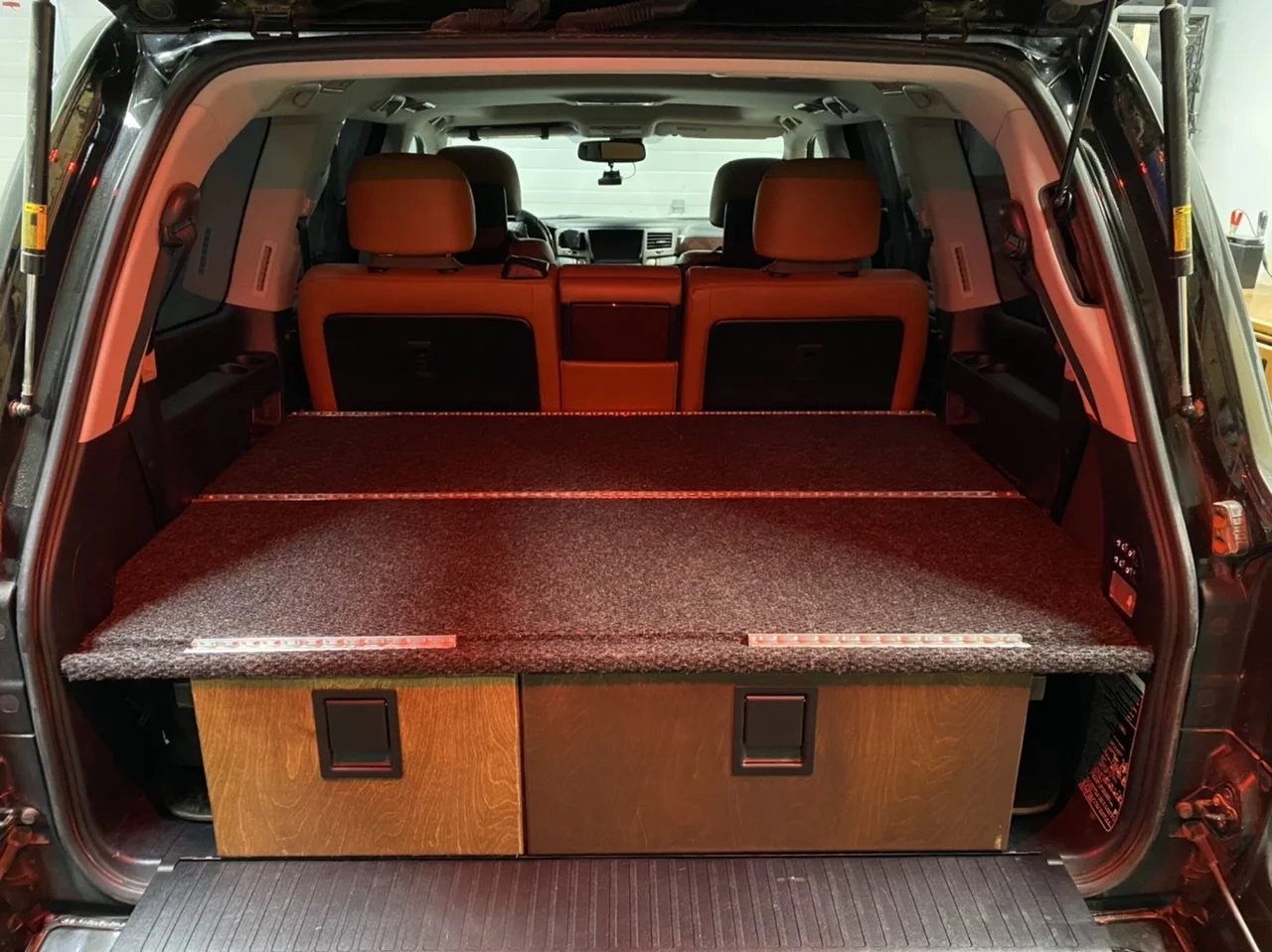

The pup recently turned 9 and is showing signs of difficulty sitting still for extended periods of time. Yesterday she jumped into the truck just fine, but 2hrs later couldn’t use one of the hind legs, and is still limping. Long and short is that the crate, while awesome, is no longer an option. The dog needs more room and more comfort.
And so, the crate and narrow drawer I had setup came out this morning, and the original drawers went back in. The entire space on top of them will now be dedicated to the dog.
I do need to get some new L track for the rear, as I used up the original on other projects.
The extra space is nice, that’s for sure.
