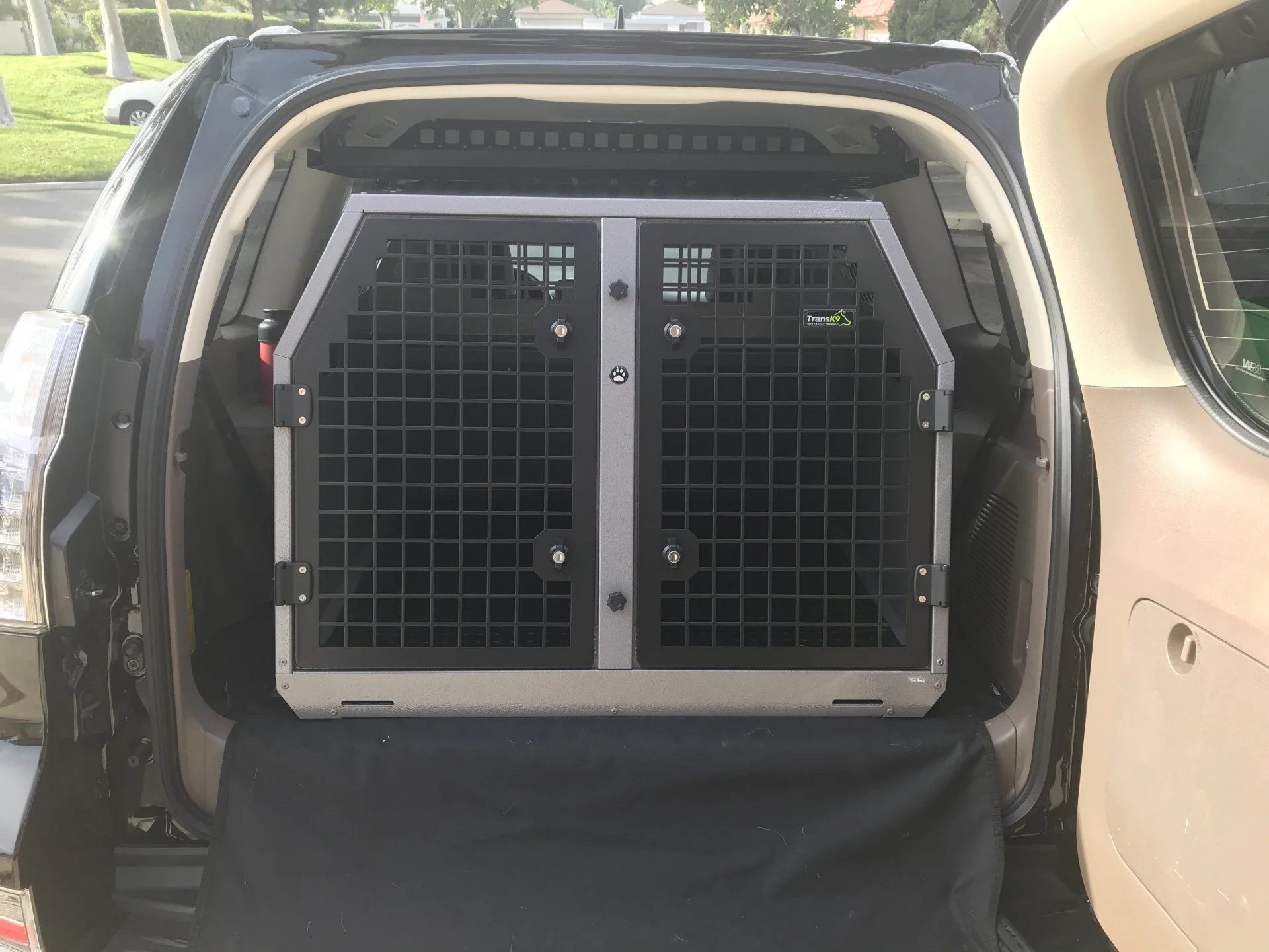

Your review on the aluminum kennel gave me the confidence to pull the trigger on one for my GX. So far so good. Thanks ESW!
The TransK9 kennels are sweet. I'd have gotten one if they were more accessible/reasonably priced by the time they get here. Congrats on it!

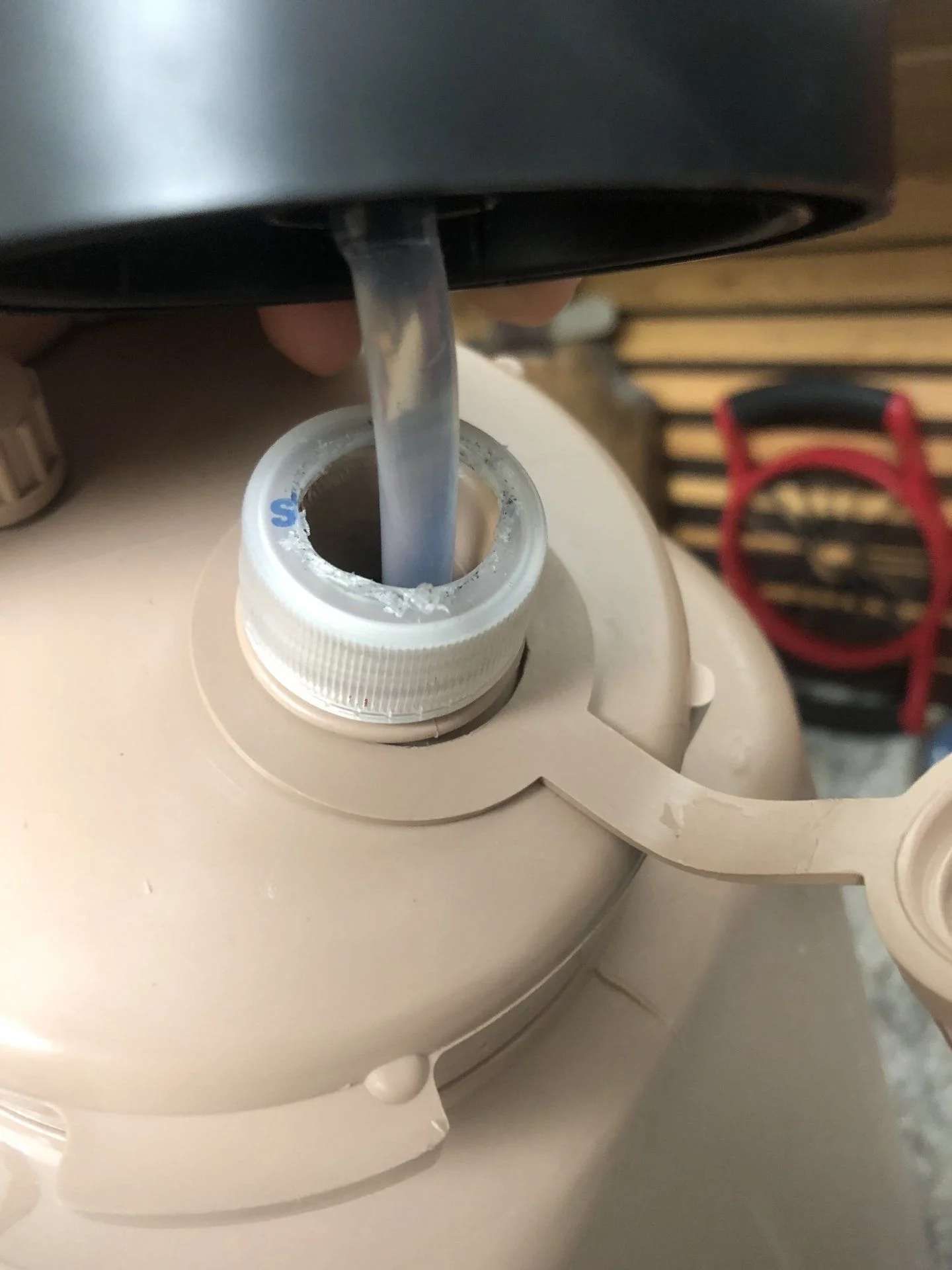

This is an old post, but was wondering: how’d you get the water pump to stay on the scepter? It keeps popping up and sliding off on mine.
Interesting you should ask that. Initially: absolutely nothing. It sat in there perfectly and did not slide out at all.
After a while I started experiencing the same issue you described, and have resorted to using a few zapstraps to keep the pump in place. I've no idea what changed, and my only guess is that temperature fluctuations somehow affected the material (size? friction coefficient?).
Well...thank you for the idea about the automatic waterer plus scepter Jerry can idea...this will be perfect for washing my hands while fishing, use at camp, etc.
however In the time between asking you for your solution to the slipping apparatus and your response, I came up with a solution you might be able to use.
The cap to a 2 liter screws onto the mini cap on the scepter. If you drill a 3/4” hole in the top of a 2 liter cap, then screw it down onto the scepter, you can then “press fit” the device into the can and it appears to hold it well.
the threads on the 2 liter aren’t PERFECT, but they work. I figure I’ll make a few of them and store them with the apparatus in the case I lose it.
Interesting idea. Thanks for the tip!
Another option may be to use a dremel and ever so slightly sand off some material from the pump's base (the part that goes inside the Scepter).
