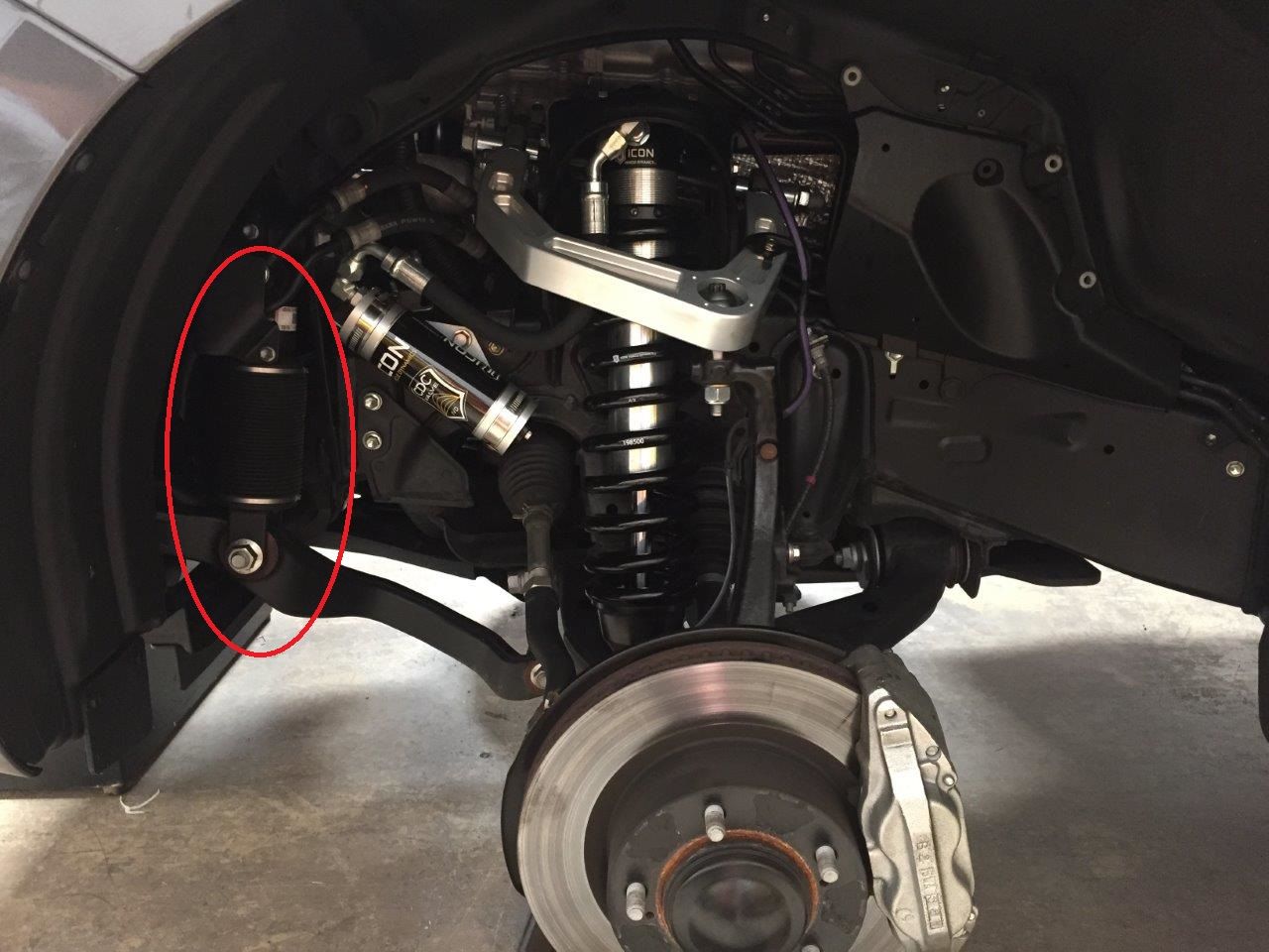

You can also look at the swaybars. If they are "normal", you have no KDSS. If you have this, you have KDSS (sorry for the dark pic):

Really? My 09 LX I just bought does not have the part circled in red on the above the pic and I am in Ca... It has a regular sway bar mounted to the frame..
gonna to have another look right now
LXs have a different type of system, more electronically controlled using the AHC. Whereas the LC's KDSS is entirely mechanical.
I should have been more specific, all USDM LCs have KDSS.
