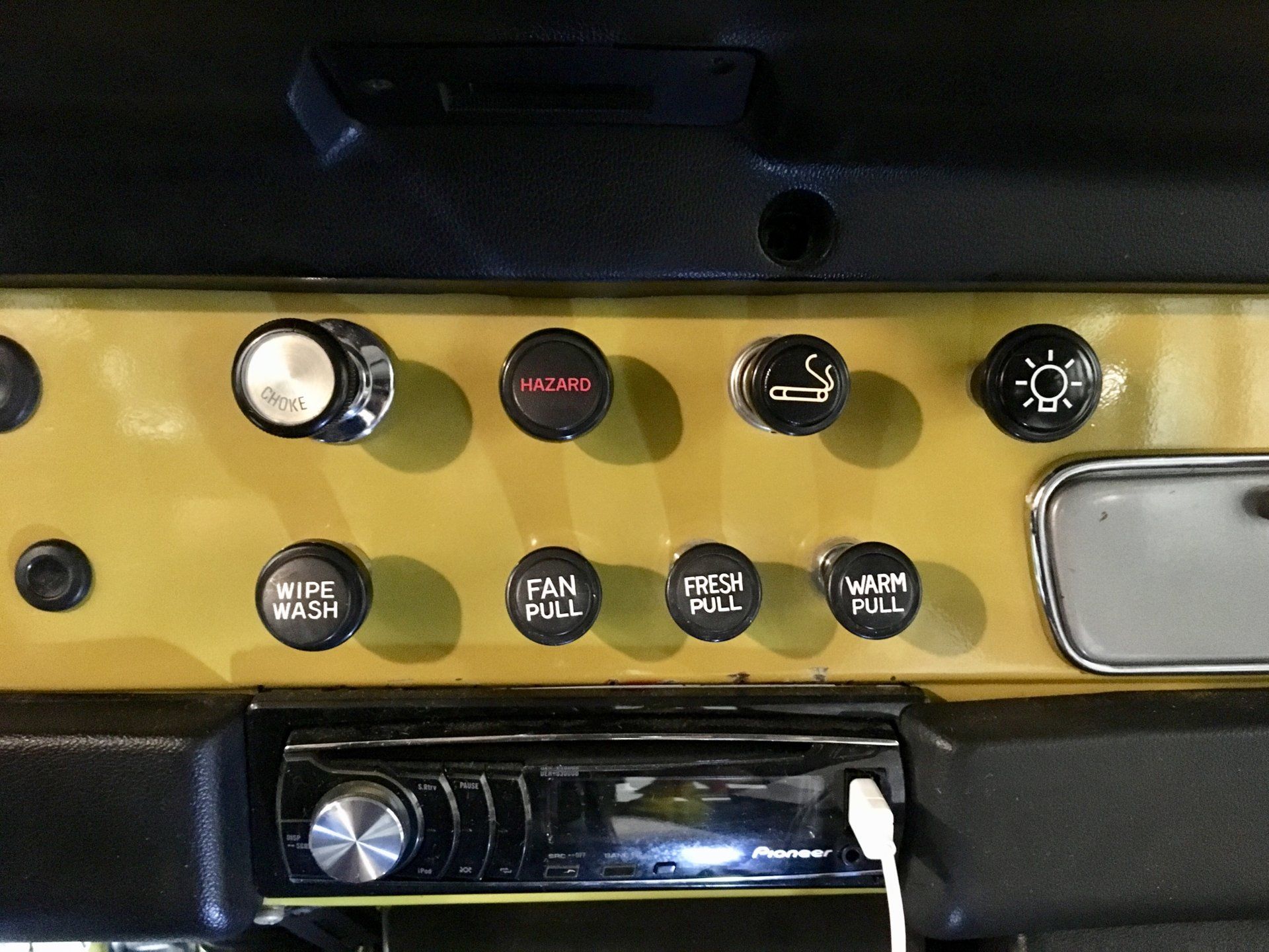

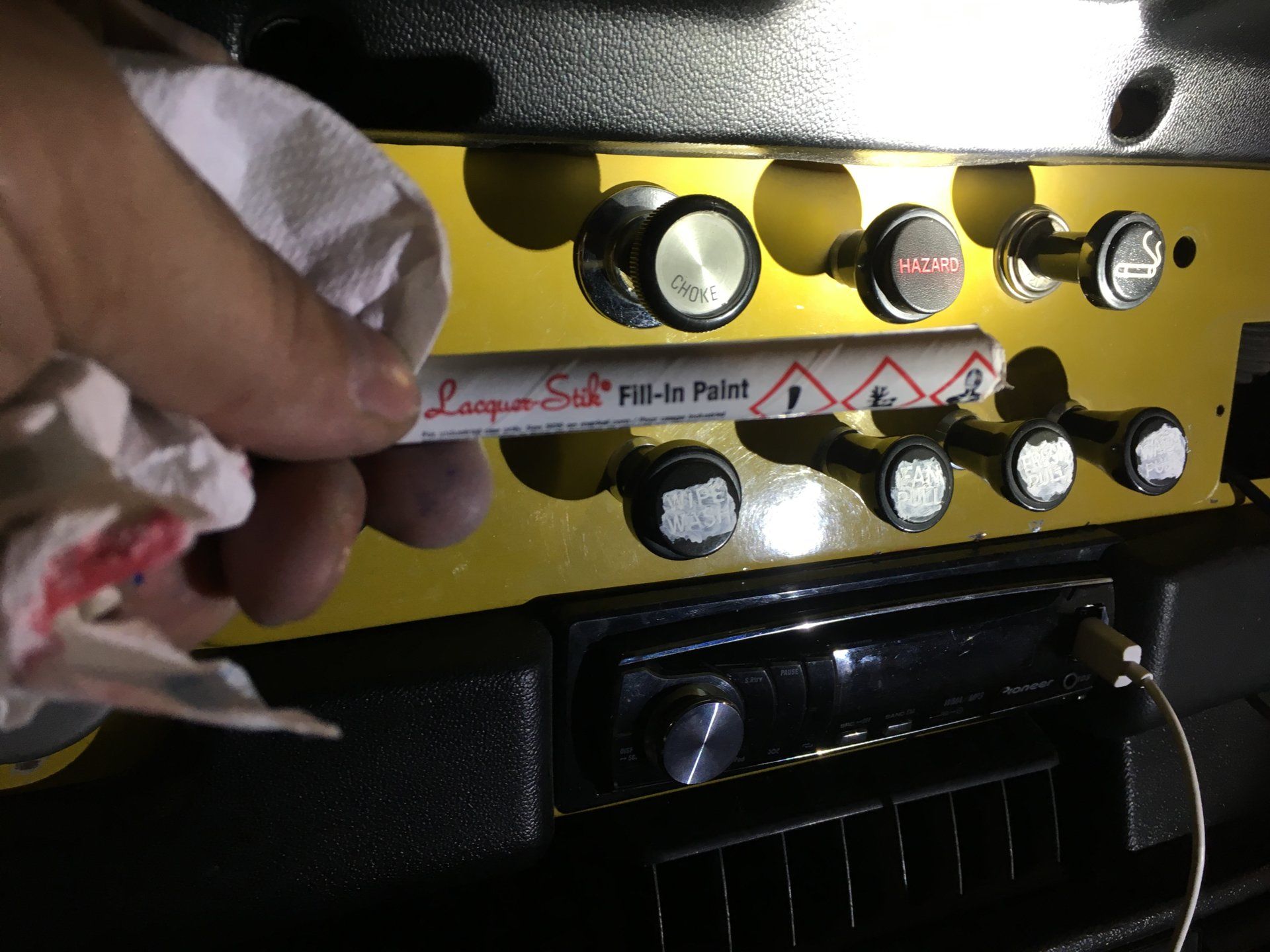

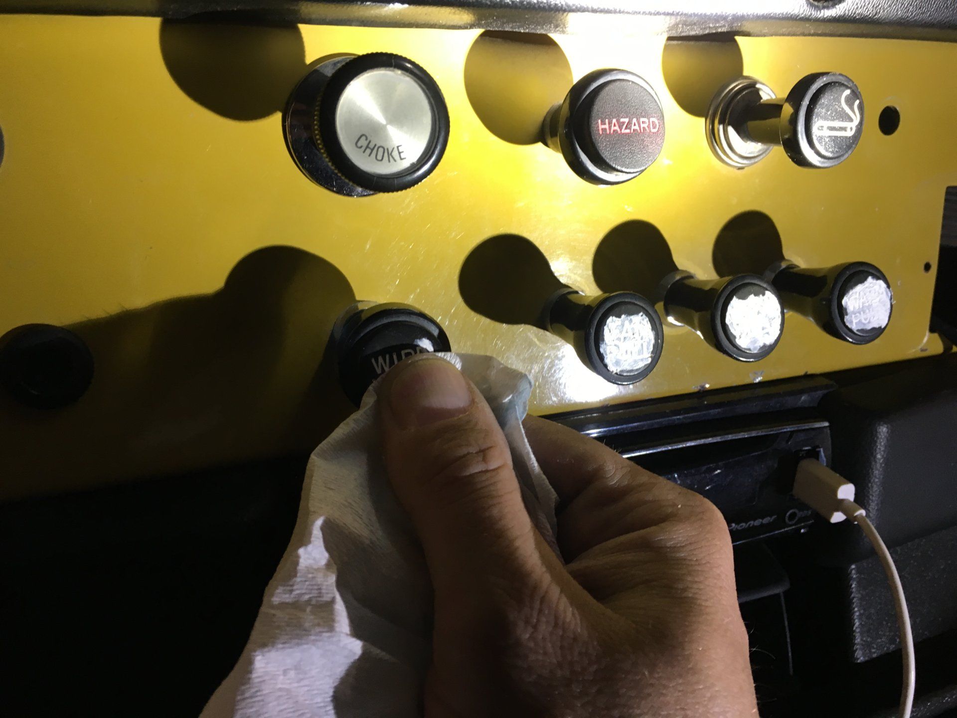

Freshened up my knobs. For the lettering on the knobs I used a product that a professional engraver recommended. He uses Lacquer Stick and it performed just as he described. Just cut the end of the stick off to expose fresh material. Smear it on the letters in every direction to get it in every nook and cranny, then wipe off with a dry cloth. Easy as that!
Wow those look great! Seems like an easier product to use than the Sharpie paint pens I ended up using
That looks easier than all the various methods I have used.
