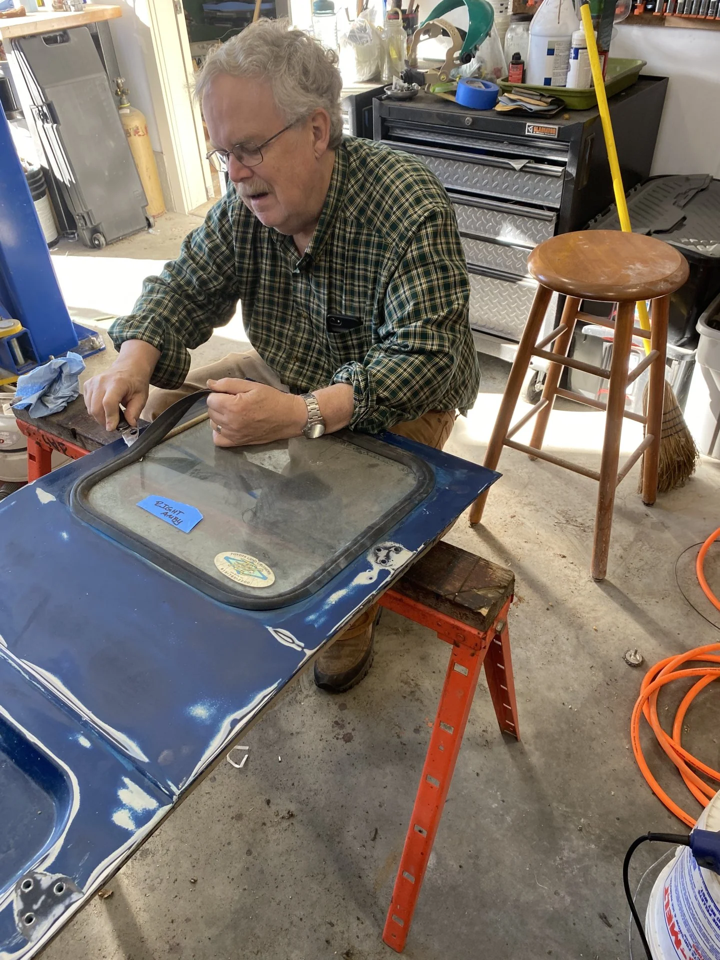

Anybody have any experience with one of these? My old man and I are stripping my 6/77 FJ-40 for a full repaint.
Looking for some tools that will help speed up the process and reduce the elbow grease needed for my pops.
