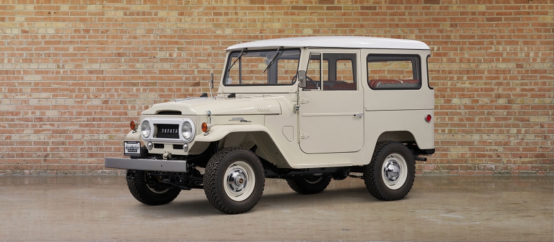

pic 42 looks pewter to me
Do you know any history on this cruiser? If this cruiser been restored, which I guess it has they no guarantee it was done 100% correct. JohnnyC was great source for factory literature. But even that I seen pictures photo cropped. Have some pictures an early soft top and later soft top of the same cruiser. Doors style was edited to later doors. I have three of these old heaters. Non were pulled by me. Never owned a pre 9/67 (68 model) with a factory. Best was one with a Nippon Denso clamshell a heater than may or any not have been factory installed.
There is an audio file with what they know of its history. They have other stuff in the range
