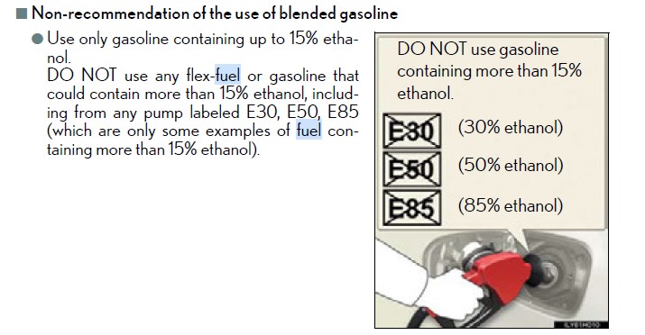

From our manuals: use up to 15% ethanol fuel is ok apparently

As mudwagon posted about different years manuals state different spec's, do you recall what year manual this page come from?
2015
FWIW, 2013 manual, pages 116 and 772 have the same graphic but say only up to 10%, and specifically state not to use E15, E50, E85, or anything with more than 10% ethanol.
Then more than likely my 2010’s manual says the same thing. I just don’t want anything to do with ethanol.
