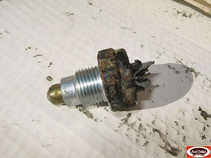

You're not alone with busting that indicator switch, I've done the same thing. Very fragile part sticking out exposed of a very heavy diff, all it has to do is roll the wrong way and SNAP it's busted. I take them off ASAP now, don't reinstall till the diff is stuffed into the truck and can't roll around anymore. A new switch is about $60 IIRC.
Mad props to The Toy Connection in Santa Clara for helping solve this issue. Thanks Jeff. If you're going to Rubithon, look for his badass '60s Yellow Toyota Stout with a flatbed, lockers and 37s...
