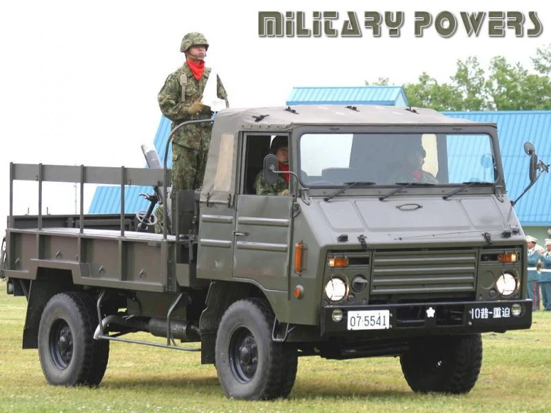

There is also a miltary version 4x4 with a single cab which looks nothing like a Dyna

They did a Dyna with Mega Cruiser underpinnings. It uses a 15B-FTE. The military version also uses the Mega Cruiser parts.
I would love to get my hands on either of them

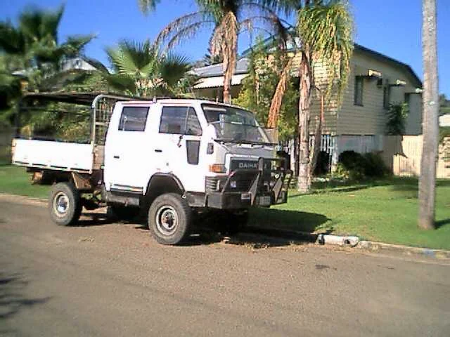

I dont know where I got this pic from but I think its also 4WD(converted)
very cool truck.... on the list of "someday I want...."
That is a nice Dyna there, Rosco. Any other photos or info on that truck? It looks to be a nicely set up rig.
