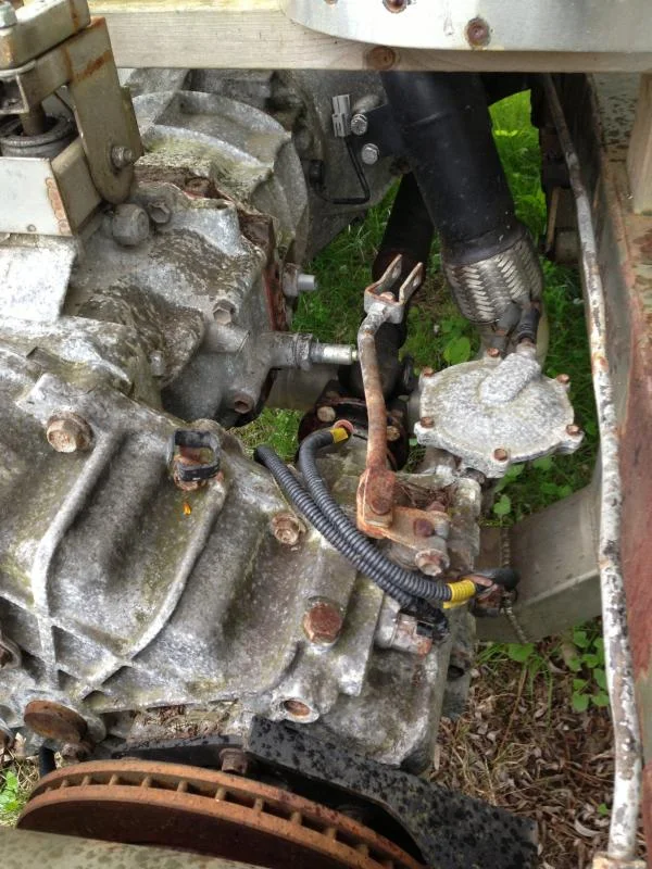

  1. I have plenty of space between the box and the rail for a sideshift like the Dyna one, I'll snap a pic later.

Here's a pic as promised:
Damn, I need to get this thing under a roff! a 1 year stand still while building house has taken it's toll! :-(
