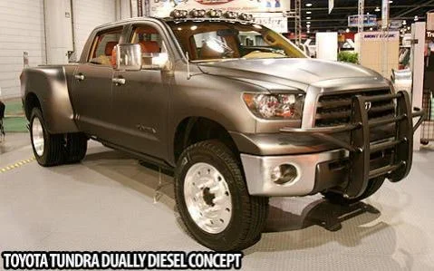

jakedwilson said:
It's definitely not as nice as this one...
That's a beast... Fell out of MadMax movie!

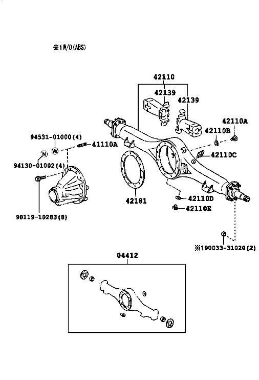

A factory 10.5" full floater would be a step in the right direction.
Huh.
I didn't know there was such a beast.
What applications were this axle available for? I don't see many second-gen Tundras around with a FF rear.

You won't see any, as Toyota has yet to use it on the 2nd gen Tundra. They have used it for years on Dynas and such. If we ever see a 3/4 ton, it might have this.
ah, so it's kind of a unicorn part, then.
It would be pretty cool to get a hold of one, but judging by the bodywork quality of this pictured Tundra, I'm skeptical the owner cared that much to track down a Dyna axle.

The 10.5 full floater is a unicorn in this country. It wouldn't be terribly difficult to modify the semi float for full floater duty, though.
However, we could easily track down full floating Toyota 12" rear ends from Hino FA and FE trucks. They are like a giant ford 9" with 3 bearings for the pinion gear. Might be Toyota's 1 ton rear end.... some day?
