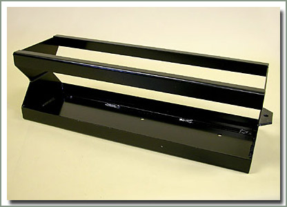

dual Battery tray FJ40
the manafre is like the one I just found on SOR.com
does the 4plus fit a 76 FJ40 with 2f engine with all the smog stuff on it?
You have to move the charcoal can downwards a little. The front battery will be very close to the alternator.

Why wouldn't two group 34 odyssey batteries fit on the dual group 34 optima tray?
I don't know for a fact that they wouldn't, but it looks to me like his dual Optima tray has clamps on the bottom to fit the weird shape of the Optimas, whereas the Odysseys are a more conventional rectangular shape.
I just realized these are mild steel not stainless so I adjusted the comment above.

I have not purchased one yet. I bought a Red Top and after the install realized they are much shorter than the typical battery and my top bracket runs out of thread to hold it down. Trying to decide if I should get one for a single battery with the intention on installing a second battery later on. They also have some clean aluminum battery trays on ebay that attach to the bottom of the battery which would be nice to get the rods and clamping bracket out of the way.
