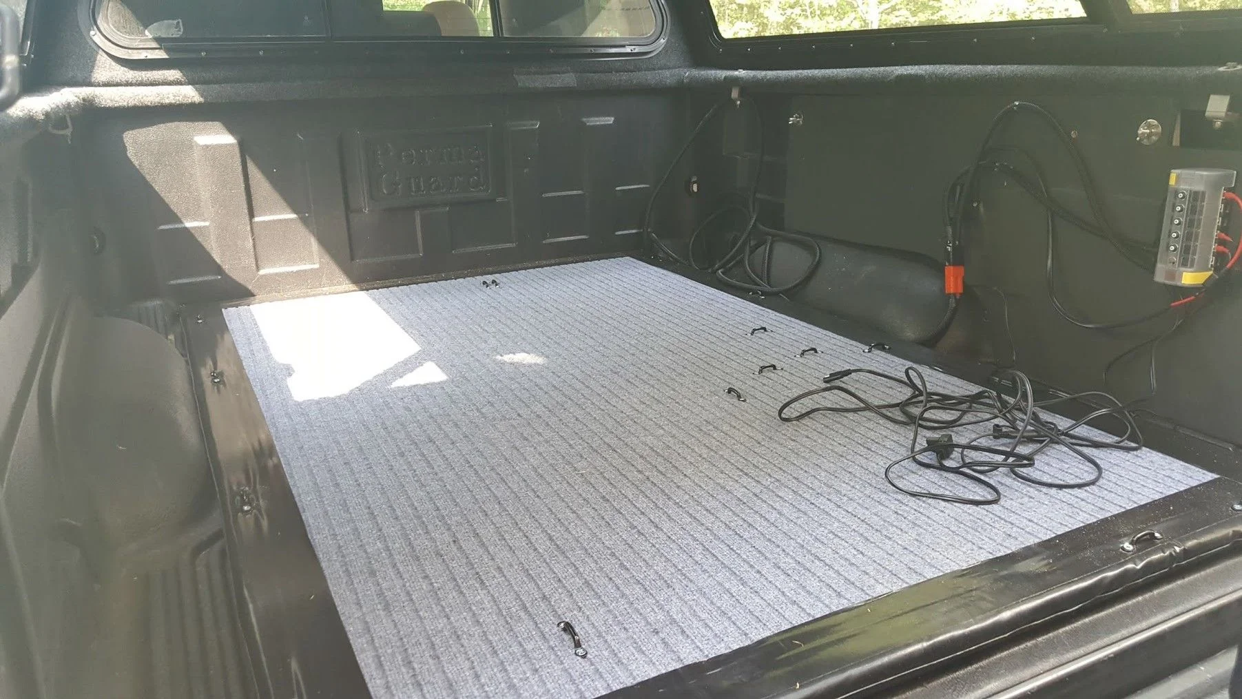

But I'm confused now. I thought you had it working. Where does the truck bed board you show, install? Gotta pic?
Andrew - The bed board installs on the passenger side of the truck bed. The 6 AWG comes from the front house battery, under the cab, up through a hole in the bed and then on back to the bed board. The bed board houses the breaker circuit board that the house battery line goes into.
I have too much slack in this main 6 AWG line right now. I am waiting for more 6 AWG PowerPole connection ends to come in and then will cut it down to fit better.
Got it. I thought you said something about the mounting board being on the floor and I didn't see how that would work. The vertical mount is good. The footman loops tie down the fridge. After some wire clean up, that's going to look nice.
Yes it will. Mine is backfeeding through the fuse panel right now and it works fine, though mine is a fuse not a breaker but it should not matter.
