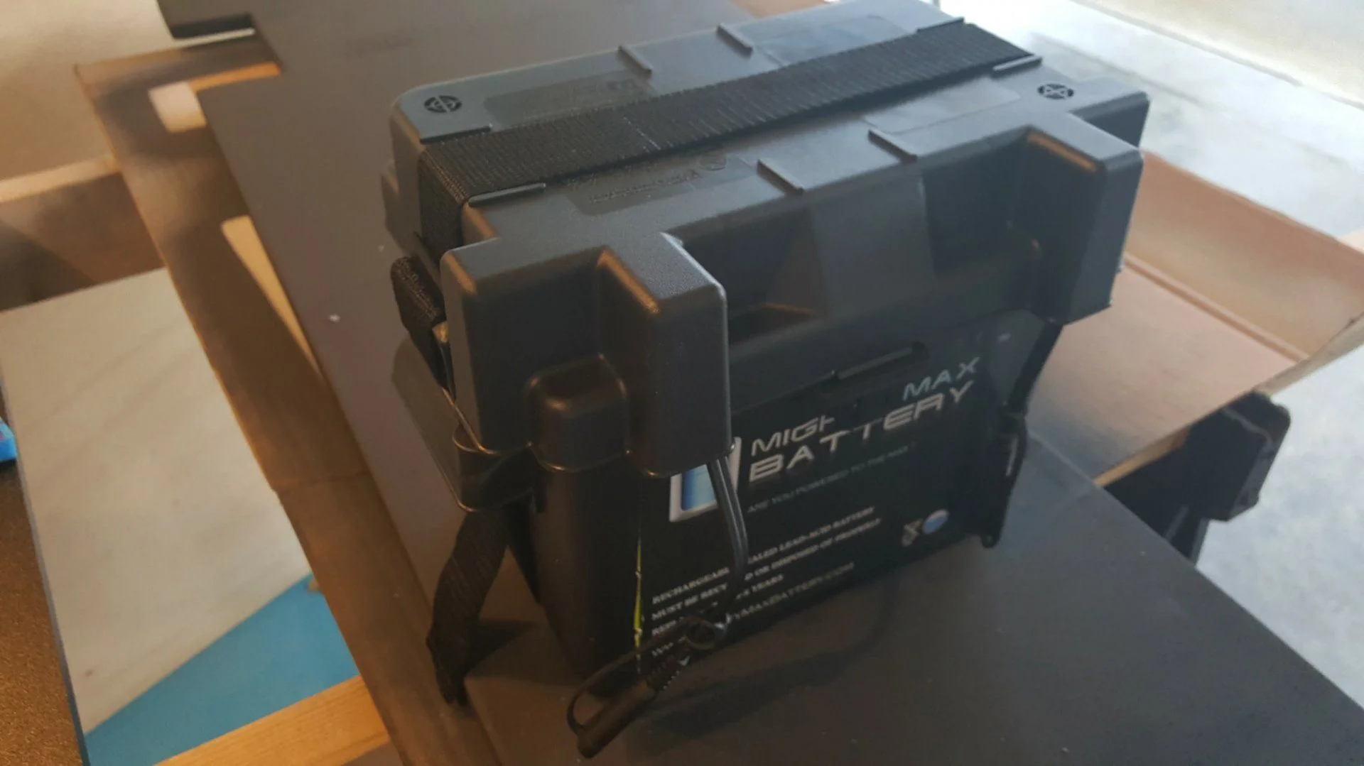

Got in my new battery boxes last night along with my black cutting board material. I have almost all materials now. I am missing some terminals for 6 AWG that are on the way.
I decided to move to 6 AWG for the line from the house battery vs the 8. I have other uses for the 8, anyway now :)
Cut and prepped the cutting board (HDPE) for install. Will connect the two boxes together along the sides back to back with terminals in. Drilled holes in the HDPE for bolts to tie together.

I got my battery box in for my Odyssey PC680 and did the following to it as a spacer. This will be strapped down behind the ARB.
