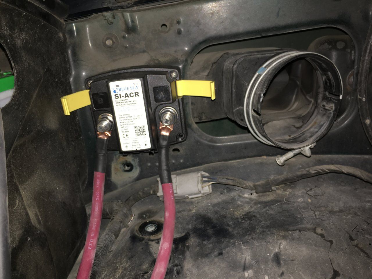

I mounted the ACR on 2nd battery box (LH)
Running my wires in Radiator support.

I mounted my Blue Sea on the passenger side fender.

It's my understanding that the Blue Sea 1st chks voltage on primary battery and when it's full it switches over to charge the secondary battery.
Can you explain how they are connected?
The SI-ACR is just a relay with some intelligence. Once it trips "on", you've shorted the two batteries together. It's not an intelligent charger or current limiting device. Your SLI battery and alternator begin dumping current into the DC, invariably draining the SLI battery some. Unless I am missing something.
That is correct. It isolates the two.
Negative terminal to negative terminal.
Positive terminal of main batt to Blue Sea ACR then Blue Sea ACR to house battery.
