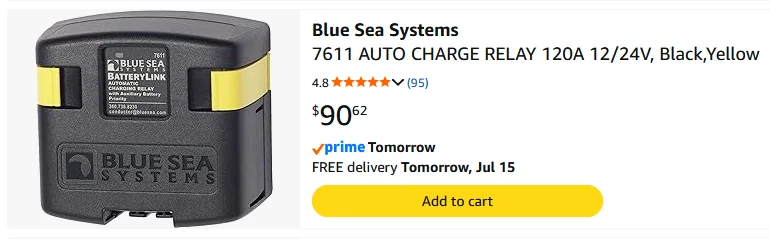

I'm looking to mount a second battery wired in parallel with the primary battery on a smart switch... I have the same type setup on my 470, and it's nice to know that I have extra amps available etc....
First get a Noco which is better than a Second Battery to Jump to Start. $100 on Amazon - GB40 Model.
Figure out where the 2nd Battery will be Mounted.
Then Get this:
This is both Cheap and Reliable.
Make your Cables and Crimp the Ends. Get a Cuter & Crimp Setup on Amazon.
Add Inline Fuses Close to Battery.
Or Buy a Kit for $600

It's not the parts, I have the blue sea charger on my other truck with a manual switch in the cab... I'm wanting to see mounting locations and battery trays for the second battery... solutions as everything is very tight under hood, but I do think some items could be relocated to make room for it. I also already have a NOCO in every vehicle I own.
