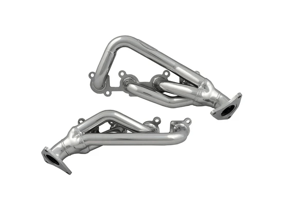

these are mild steel and for left hand drive. I read on one of the AU manufacturer's site that they recommend a ecu tune to reduce risk of cracked headers. if anyone has used these i'm interested in your results.
they might have dt's in stock...
I don't think these fit. the quality is suspect. it sounds like you can weld, perhaps you can make them work. do any of you think it's worth making these fit?

Those super cheap ebay stainless are real interesting for the price. If the output flange lined up this might make a serviceable spare for the rt side... for that price if I can confirm the output flange alignment I might be willing to give it a shot to see what we find out.
fyi...the rhinos are 200 cheaper on their site. perhaps they'd sell them without their cats and you could get them cheaper. my main beef with them is they're not stainless. emissions is a concern.
Rhinos aren't emissions complicated they come with a downstream O2 spacer to fool the computer. Also saw in another thread that they were rubbing in someplaces.
