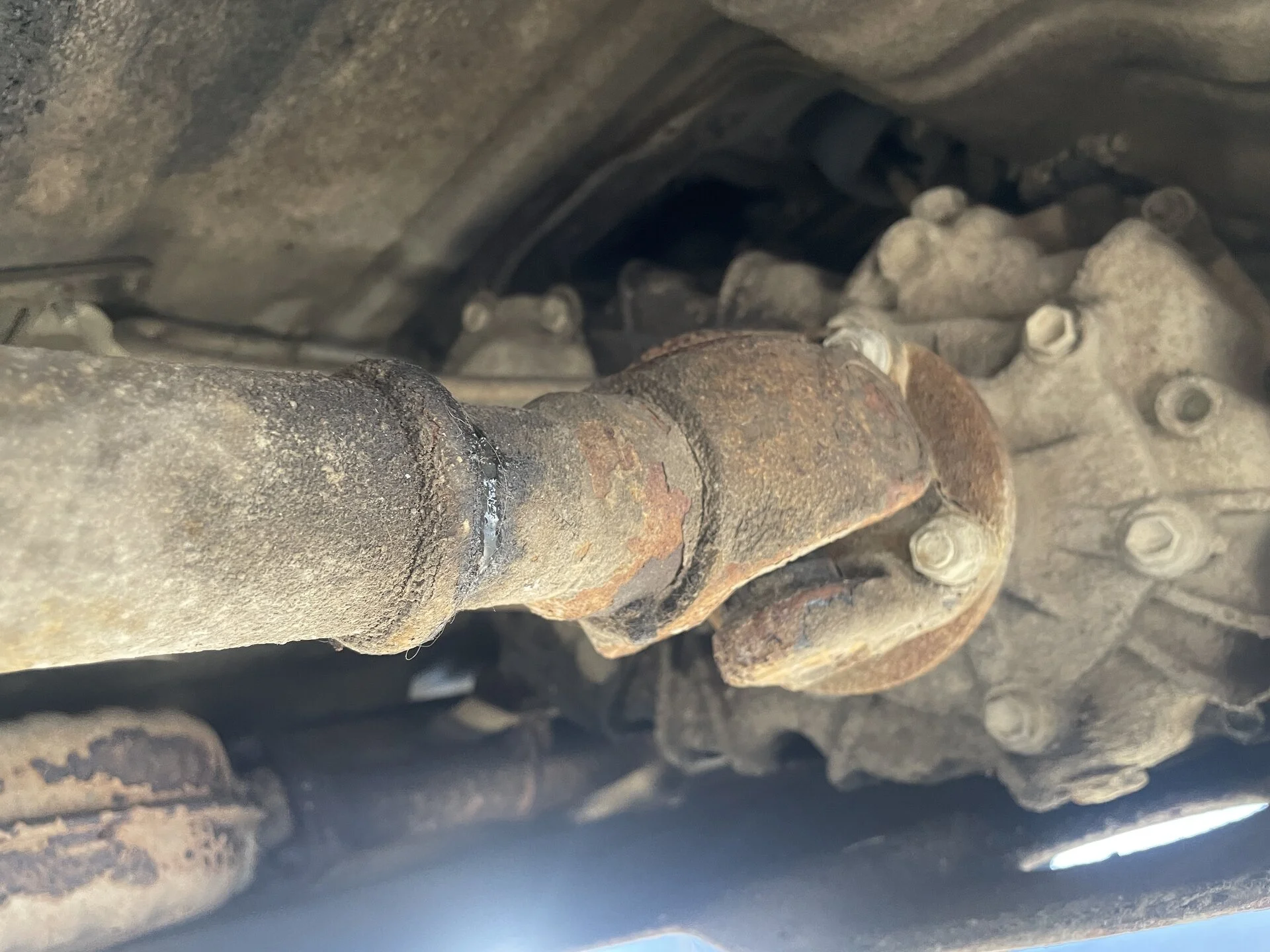

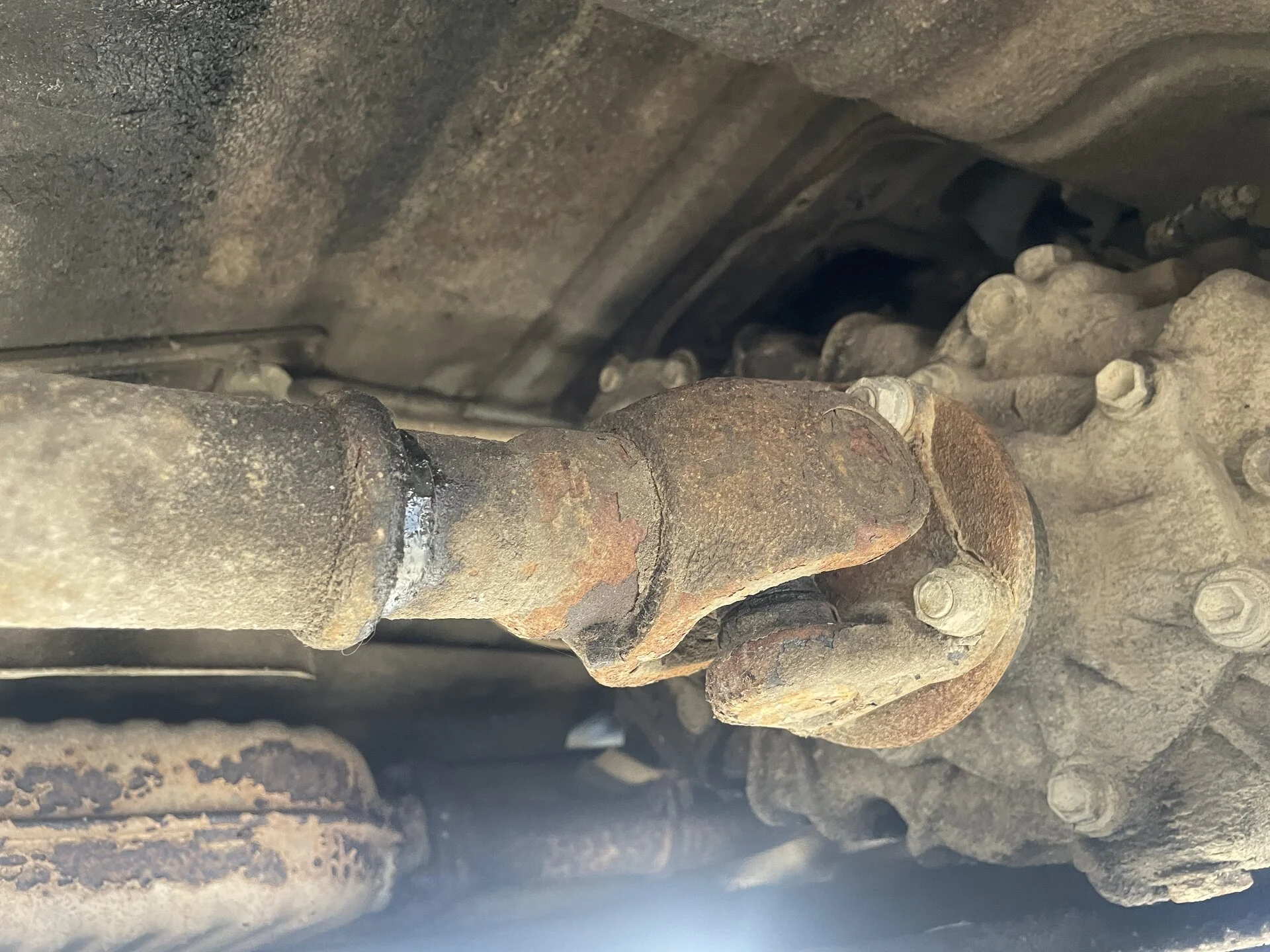

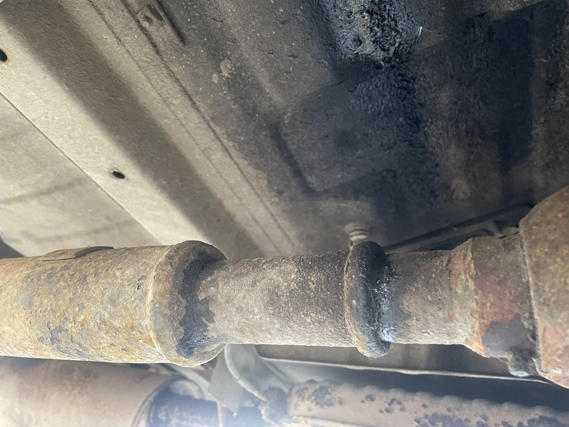

Excess grease comes out and gets flung.
Normal.
It ain't really a leak. That is just the grease on the slip joint being messy. Possible over greased.
Mark...
that shaft will go in and out depending on what bumps and dips you go thru.
it will leave a slight film of grease behind
