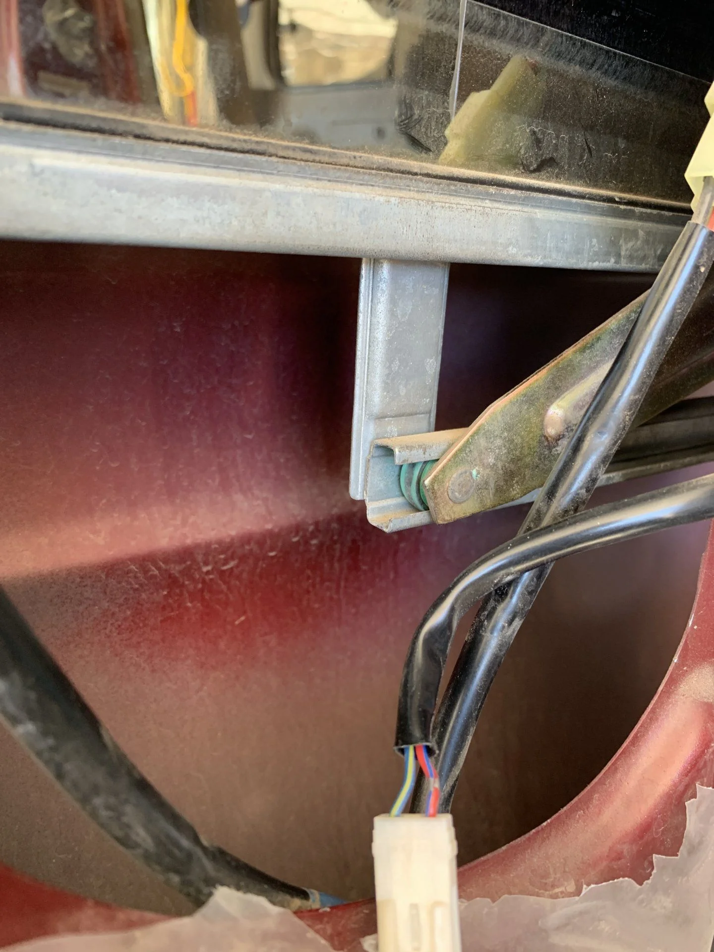

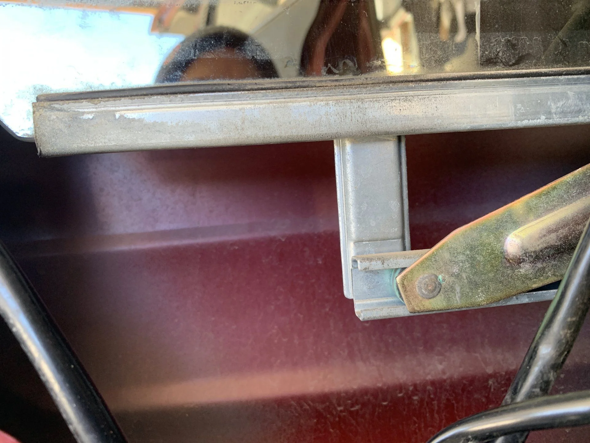

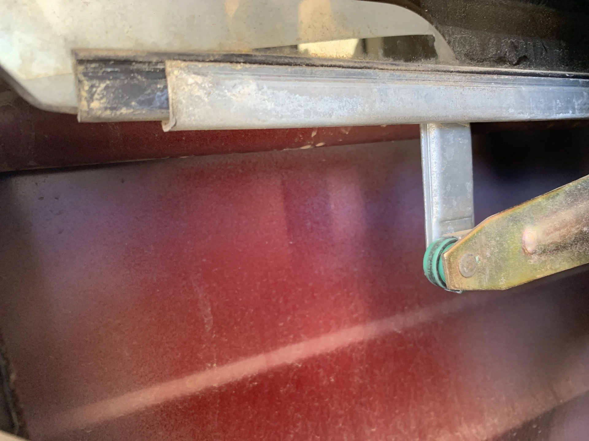

My window came off track am I 95 Land Cruiser. It’s a driver side passenger. Are there any tricks to getting the lift slide mechanism to slide back on the window? As you can see the roller almost comes out the end at midpoint. I’ve been trying to tap it back but you’re nervous about shattering the window.
Nvm Got with some vigorous well placed hammer to said mechanism and all is right in the world again!

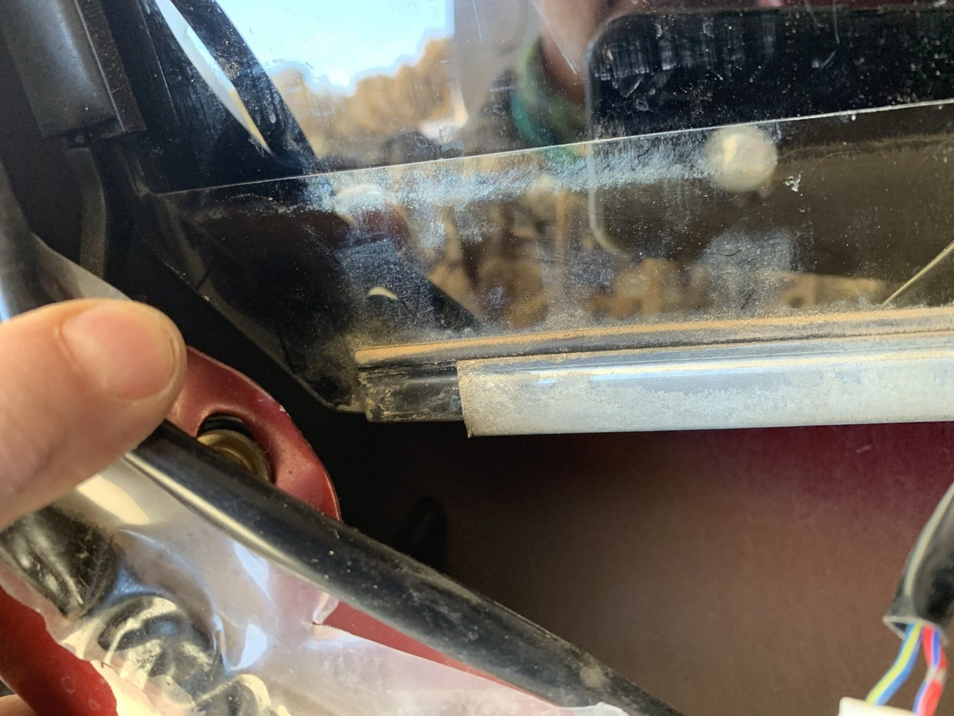

When mine started doing that I pulled it out, removed the rubber strip and installed it using windshield adhesive. Been fine since then. Only going to be an issue if I break the glass and then it just means I have to scrape the glue out to get new glass in.
I'm having the same issue on the same window. I've gotten it back in 3 times and a few weeks later it pops out again. Anyone have a trick for keeping the window locked into the tray?
The FSM answer is replace the lower bar and weatherstrip. I tried bending the track to clamp the glass tighter, cleaning the weather strip and several other things which resulted in foul language. A new lower bar and weatherstrip solved the problem permanently. I literally fought the old parts for hours, without success. The new parts took, literally, five minutes and held just as promised. That was last year and I'd completely forgotten about it until I read this post. That's how well it worked.
I tapped the track back on the weatherstrip and hopefully it’s going to hold out otherwise I’ll be in your position and I ll need a new track and weatherstrip. I’ll see how long it holds out. I do a lot of four wheeling that’s very bumpy so only time will tell
You can also pinch the end of the roller channel a bit to keep the wheel from slipping out of it.

I was able to slide the glass (slide it in the channel) towards the rear of the car. This allowed the roller wheel to not fall out the end.
