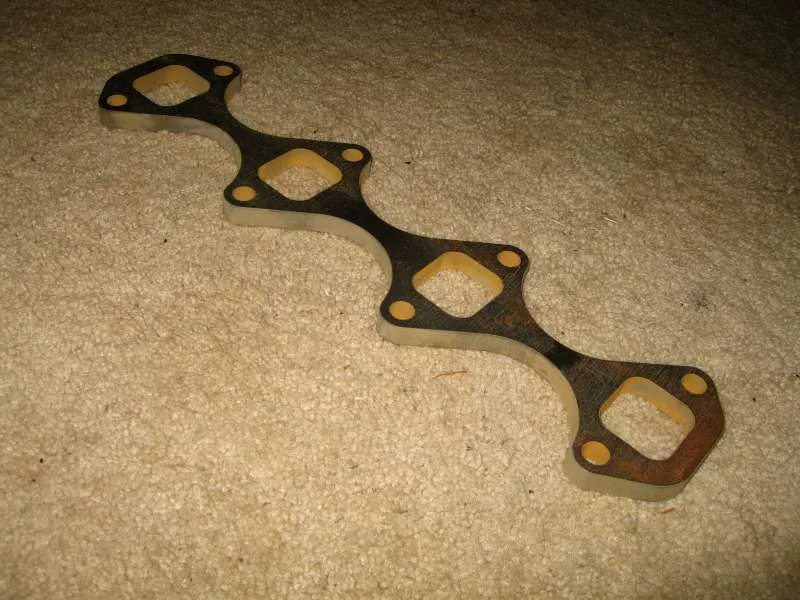

2) My flange. I posted the dxf file for this in my other thread (https://forum.ih8mud.com/diesel-tech-24-volts-systems/418145-3b-exhaust-flange-drawing-cad.html), I have my go-to waterjet guy cut it in 0.5" mild steel. For what its worth, if anyone in the Bay Area needs waterjet work I highly, highly, highly recommend Mark at Triton Waterjet (Triton WaterJet - Water Jet Cutting and Abrasive Jet Machining, Northern California) - he does all of my gauge bracket products too and is awesome to work with. I s***-you-not, I sent him the file on Monday, accepted the quote on Tuesday, and got the UPS package with the flange on Wednesday; unbelievable! Price for the flange, inc material, $70.

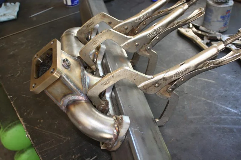

When you get your T's and Elbows.... post a pic pf how they fit on that flange, I'm worried you might need a bit more meat around the edges near the bolt holes. (nothing more weld wont fix though)
Mine was close....

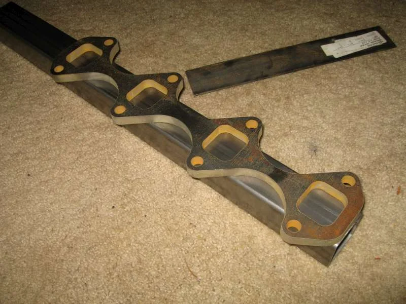

-$12 of mild steel 2x2" square tube plus a short length of 1/8" thick flat stock
Behold the quickest, simplest, (worst?) 3b turbo manifold EVAR. I've going to cut round holes in the square tube and then weld the flange over them. Turns out a 1.75" hole, which is the biggest that fits in 1/8" wall square tube, juuuuust clears the opening of the 3B ports. :grinpimp:
Very nice, two questions where are you going to place the welds with no stand offs between the head flange and the square manifold? Most turbo mount flanges are welded at an angle for ease of install how does this configuration line up the exhaust, oil lines, and intake piping?

Are you going to weld around the interior of the ports?? or just around the exterior.. is there any risk of rust / corrosion / flaking between the flange and the tube long term that can then get into the intake area? and pass through the cylinders.. just a thought.. maybe crazytalk.. maybe worried about nothing..
Jim
a) I'm going to weld around the outside perimeter of the flange.
b) I'll mock it up in the next few days, fingers crossed!! I'm prepared to add a standoff with an angle built in to the turbo inlet flange if necessary.

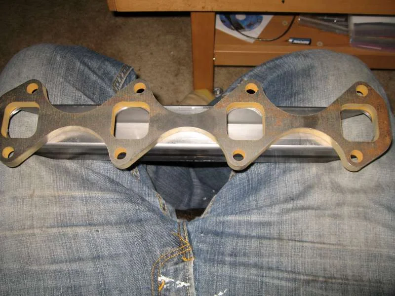

Pics #1 and #2 show the turbo in roughly the position and orientation it will be in assuming that I build the manifold in the simplest possible way: without any angle on the turbo inlet flange and with said flange centered on the manifold. Some thoughts:
  • Its hard to see, but the compressor inlet is actually well above the alternator, which is both good and surprising given that my turbo will be lower than most. However the banjo bolt for the vacuum pump connection has a funny little heat shield built onto it which interferes with the turbo - the solution is to just rotate the banjo so it points towards the fender instead of the firewall.
  • The inlet is slightly tight to the stock airbox (which I will not be replacing). My manifold will move the turbo 0.5" closer to the block than it is presently, so I don't think this will be an issue - I'll either use a tight cobra-style elbow to route the duct upwards, or run a flexible duct underneath the airbox.
  • I think I might not clock the turbo afterall - doing so would mean I have to make a new wastegate bracket, which would contradict my MegaCheap philosophy. The compressor is positioned almost directly opposite the inlet venturi, so I'll just use two 90deg elbows.

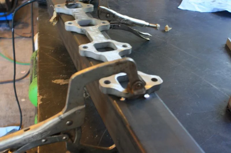

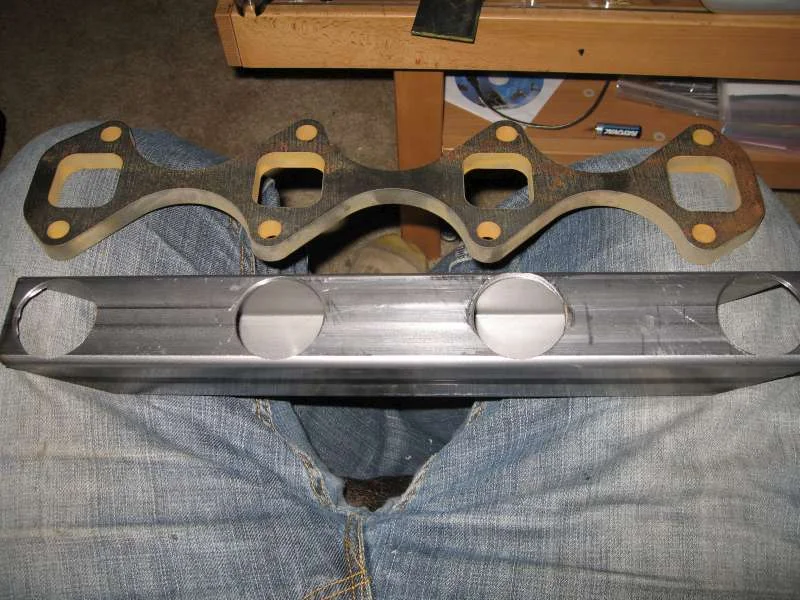

Pic #3 is the result of 5 deafening minutes with the angle grinder.

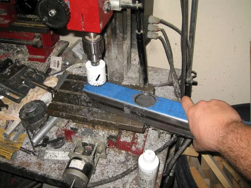

My big fancy drill press is not fancy enough to have variable speeds, apart the five or so speeds you can achieve by moving the belt to a different pulley... turns out the lowest speed it can achieve is 650rpm, which is wayyy too fast to cut a 1.75" hole in 1/8" steel.
I tried to cut them with a cordless drill. Um, no.
So I'm left making these holes on the smallest machine in my garage because its the only one which can turn slow enough - the 1/5 HP CNC mill I use as an engraver for my knob business. Doh!
Anyway, here are some shots of the hole cutting, and the finished product showing how a 1.75" hole lines up with the 3B ports. I may use a die grinder to clean up the very minor overlap at the corners.
... or I may not. :meh:
