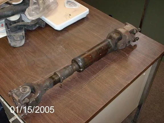

Sorry, as I'm not very familiar with 60-series and this may been already addressed, but if you can help me I'd much appreciate it.
What years and models of the 60-series had Double Cardan driveshafts?
I need such driveshaft, but so far I'm keep getting to standard slip ones everywhere I look. I'm sure that I've seen Double Cardans on 60-series front ends, just can't recall what model and year it was on.
Pictures from the web:

Models with H42 Non-spacer transmissions have DC driveshafts.
That is what I have. So anything 1984 and older should have them. Possibly some early 85's (the spacer transmission was introduced sometime that year)

So '80-'84 for the year. What about models, FJ60, HJ60?

Europe and general country´s every BJ, FJ, and HJ from 80´to 87´with a 4 speed mtm.
USA and Canada every BJ and FJ from 81`to 84`with a 4 speed mtm.
