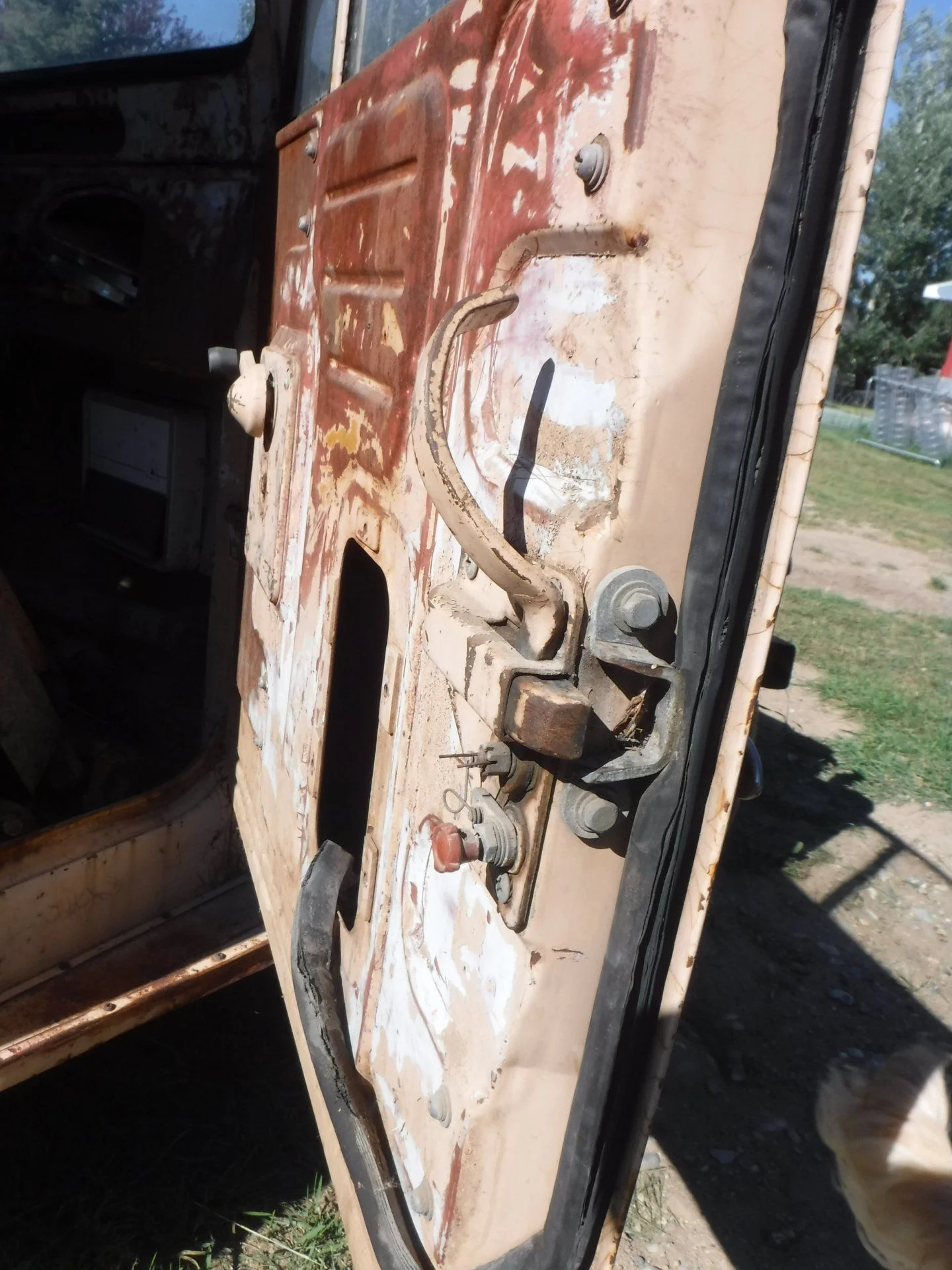

I'll try and get some pics tonight when I get home.

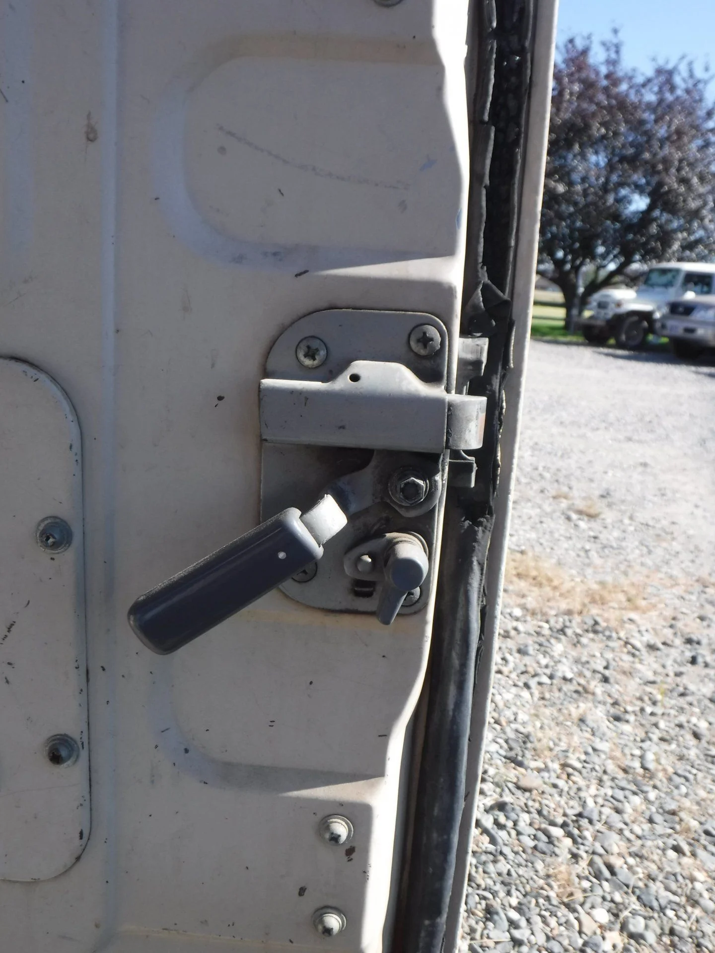

@tuckero23 yep those are the early oddball latches

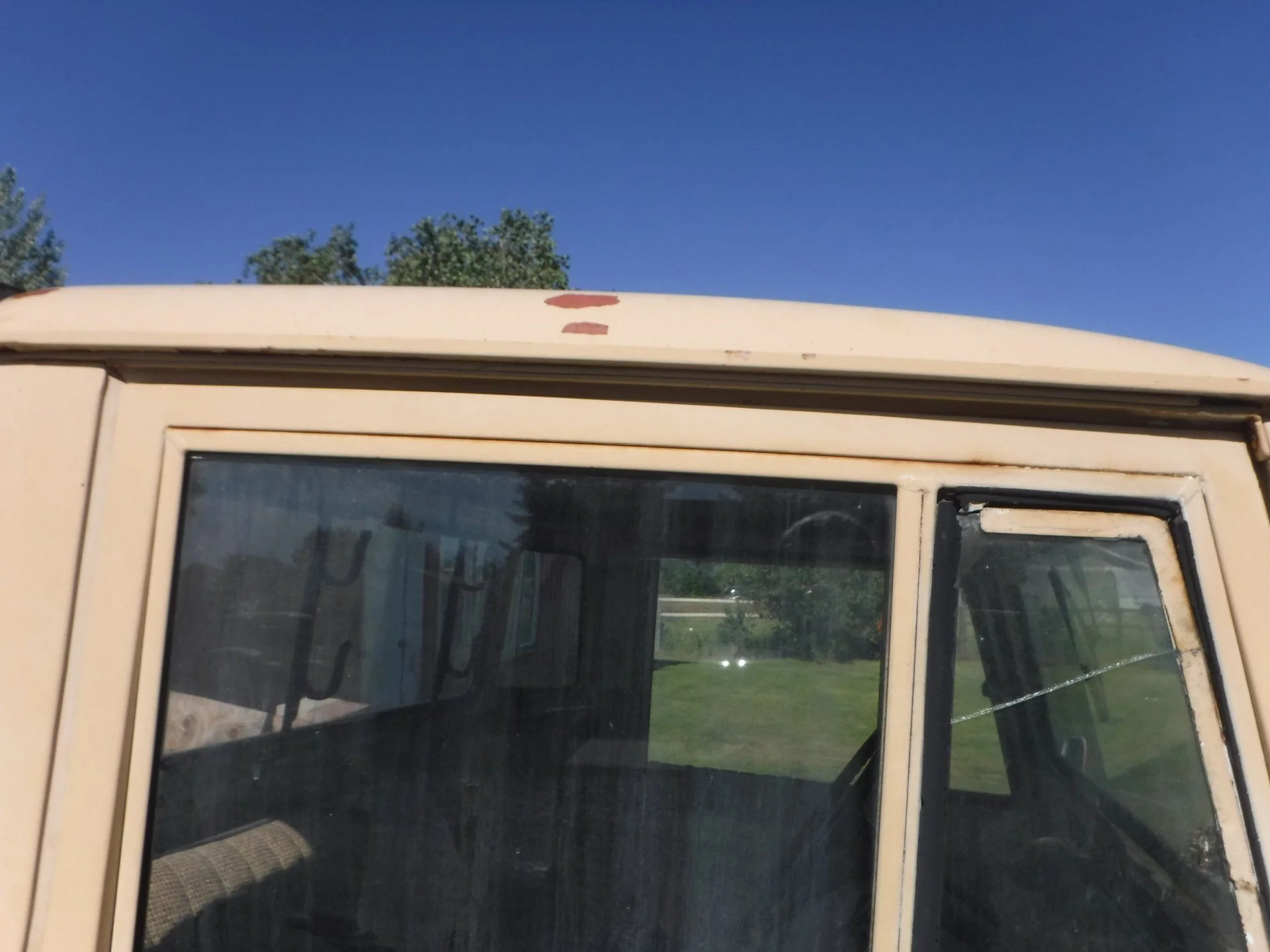

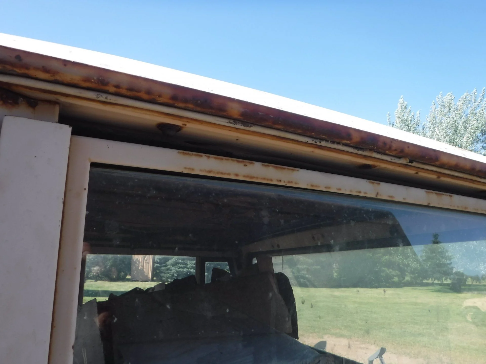

here's pics of my early 63, mine have roll up windows
the top of the frame is different

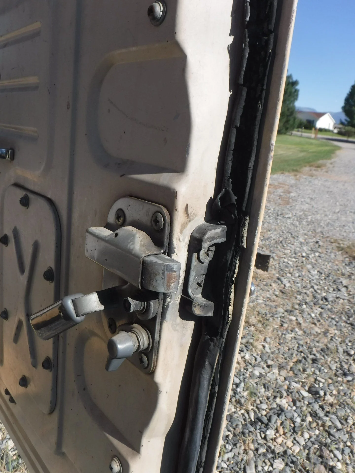

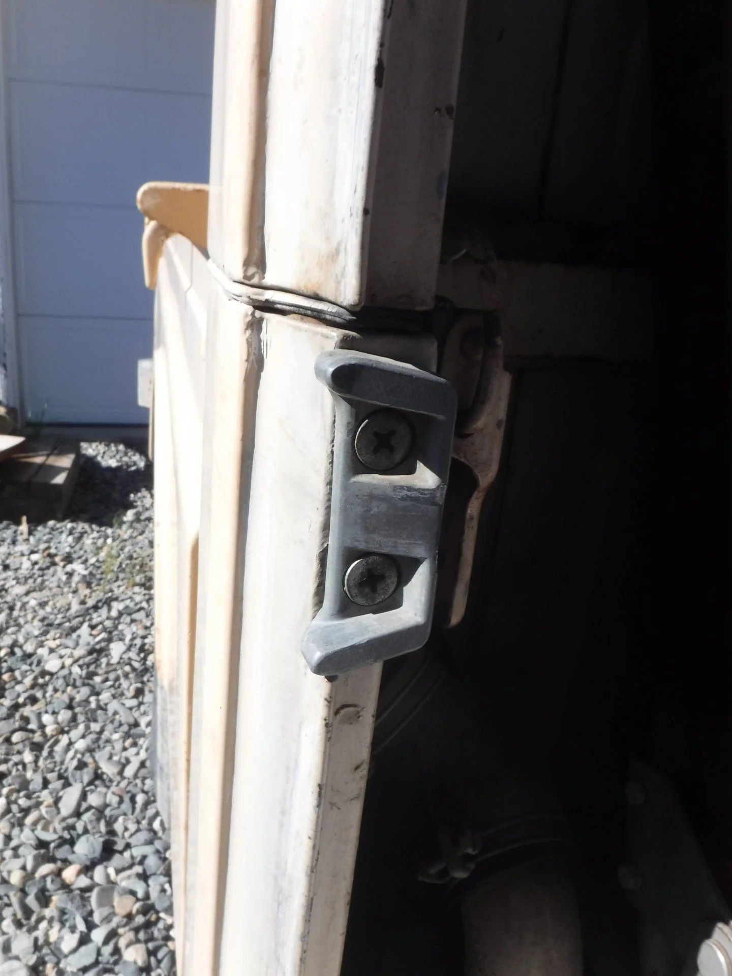

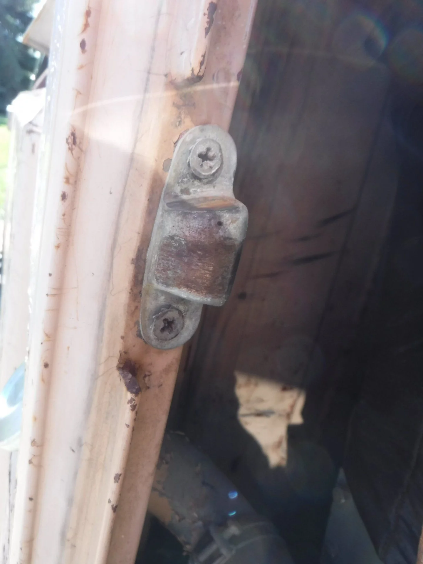

pics of my 65
the screw spacing on the door jamb is different between these 2 versions, so what I was originally thinking the doors may not interchange without some modification, the latches won't swap and the catch piece on the jamb won't swap without work
see the top of the frame has an extra piece across it
