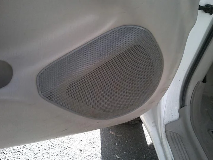

Underneath the fabric is grey perforated plastic with a light glue stain as mentioned above. How ghetto it looks is very relative to the condition of the rest of your interior. It's not that bad-looking in a 13 year old truck but in an '05, different story. I'll post pics later today so you can see.

Picture attached - you can kinda see the yellowish glue swirl but it's definitely an improvement over ripped fabric. Plastidip sounds promising but I wonder if it would clog up the perfs. Painting these covers is the kind of thing that would be nice but is way down on my list.
I did and painted them flat tan after they were cleaned
I think they look pretty good. There are a lot of different tans on the interior anyway and they match pretty well. Much nicer than the fabric that used to cover them.
