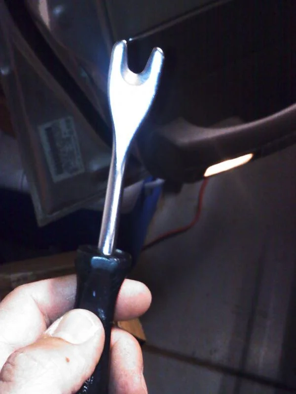

There are a couple of tools you can buy that make removal of the pop-in clips (on the back of the panel) a breeze.
Glad you mentioned that. I have a mechanic buddy and he loaned me the tool I have pictured below and it made unseating the pop-in clips a breeze.
By following this procedure, the door panel removal is less than a 5 minute job, thanks again dnp! :clap:
Sorry for the picture quality.......cell phone.
