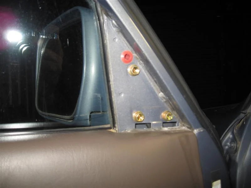

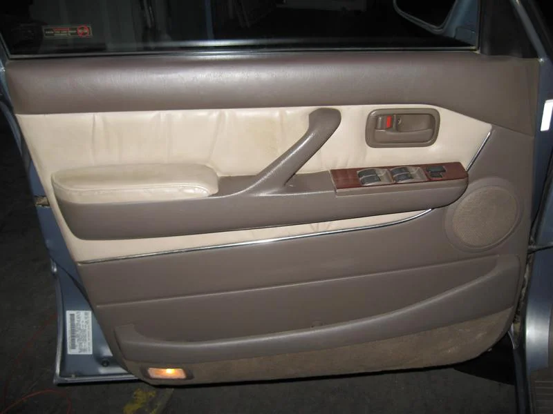

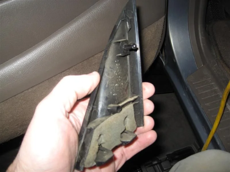

1. Locate the small, black "finishing" plastic triangle on the top of the door panel (at the leading edge of the window - see the upper right side of photo 1), and pry it off. (Photo number 2 will show you the back side - just so you'll know how it's affixed to the door). It would probably be pretty hard to do so, but be sure not to break off the little plastic connector on the top.

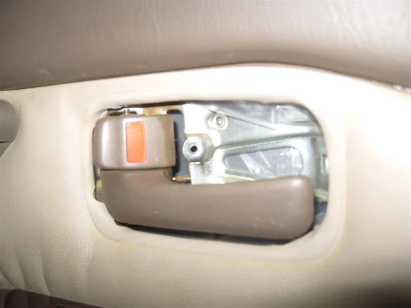

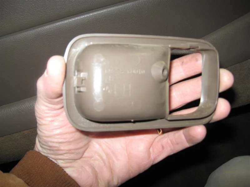

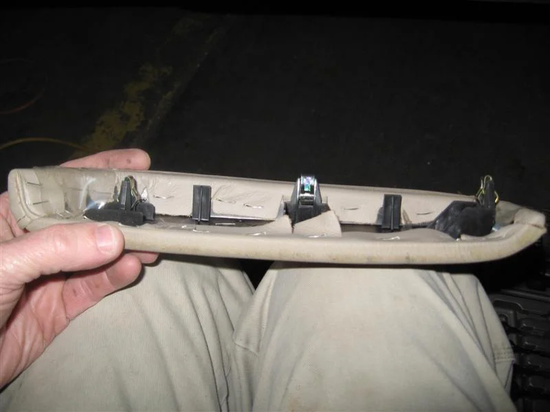

2. Remove the screw in the inside door handle trim (See second photo for how the back of this piece looks) Carefully pry the upper trailing (rear) edge of this piece out from the door panel. Note in the second photo that the front end of the back of this piece has a little nub that keeps it seated, so the rear of the piece needs to be pulled out first)

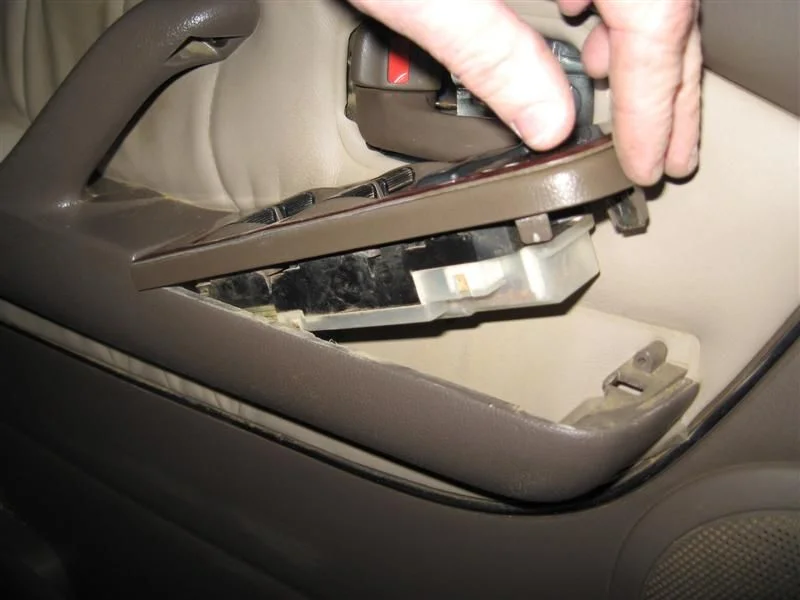

3. Carefully slide a flat tool under the leading (front) edge of the window/door switch panel. Gently pry up on this piece, being careful not to scratch the plastic. There is a spring-type clip near the front edge, so once this releases, you can pull up this panel to reveal the underside and wiring. Before you go any further, let the window all the way down. It’ll make things easier at the end. On the underside of the window switch wiring connector (forgot to take a photo), there is a “button” that must be depressed on the plug to allow it to release from the power window switch. Press this button, and pull out the wiring plug.

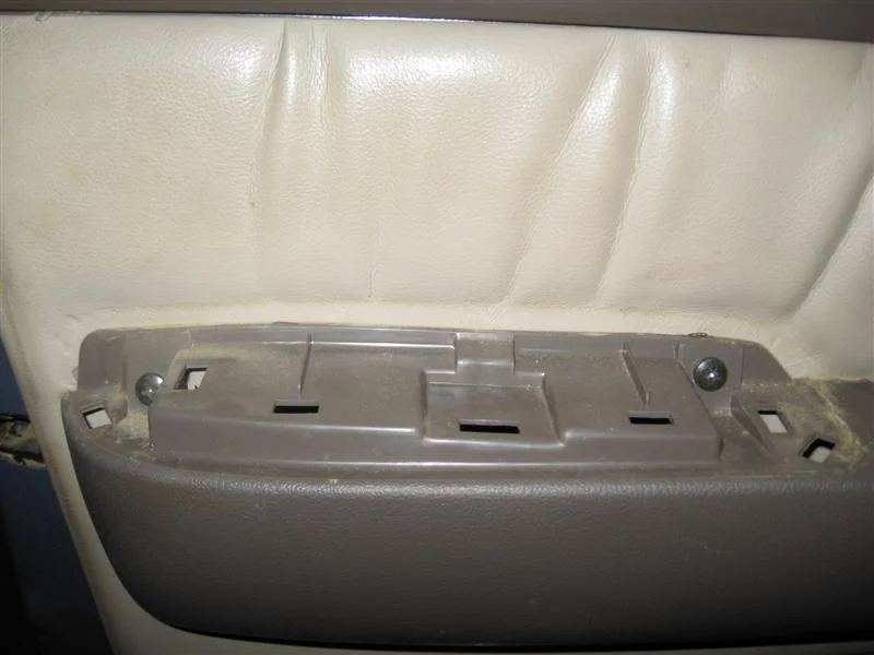

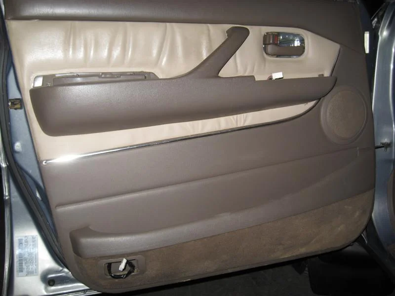

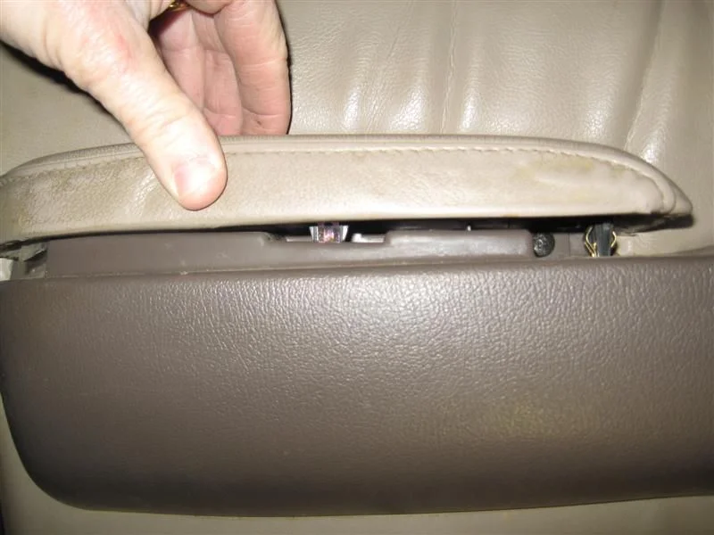

4. Carefully slide a flat tool under the trailing end of the door arm rest, and pry it up - be careful not to scratch the plastic). There are three spring-type clips on the arm rest (see second photo), and they just pop out. Once you’ve removed the arm rest, remove the screws shown on either end of the arm rest base on the door panel (see photo three.)

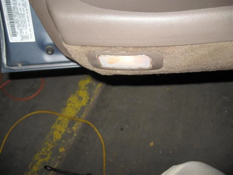

6. Remove the light fixture at the bottom of the door panel, and unplug the wiring to it. (NOTE: it may be easier to remove this light fixture after you pop loose the rivets found in step 7. The lens is held on in a way that it’s easy to crack unless you pop out the entire light housing before you remove the lens. I don’t know the best way to do this, so some of the other people might have some suggestions on this........If anyone has a good suggestion on this, let me know, and I’ll update this thread with your recommendation. Thanks.)

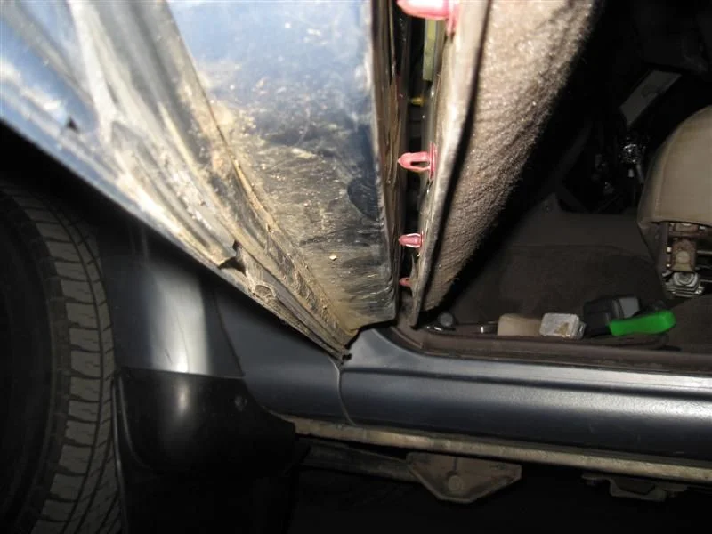

7. There are 13 pop-in “rivets” on the back of the fiberboard door panel backing. Remember this IS a cardboard-like panel, so be advised that it IS possible to pull the panel in a way that tears these rivets off the door panel (I did so on a couple of them, until I figured out to pry the door panel very close to each rivet - unfortunately, until I did this the first time myself, I didn’t know how many rivets to expect to find). Once you’ve popped all of the rivets loose, simply pull the bottom of the door panel away from the door a short distance, and lift the leading and trailing edges of the panel straight up. If the window sweep catches on the upper part of the door, just move the door panel bottom a bit closer to the door and pull up again. It should come off without any real problem.
