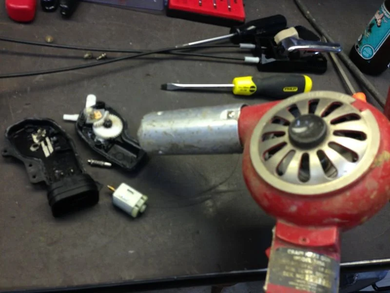

Guys, THANK you for such a great write up. I purchased a few replacement motors and attempted the fix tonight. The best trick in the book was to use a hot air gun to raise the temp of the lock assembly and it snapped right open. I also found that removing the exterior handle allowed me to remove the clips without breaking them.

Enjoy some photos of my work.

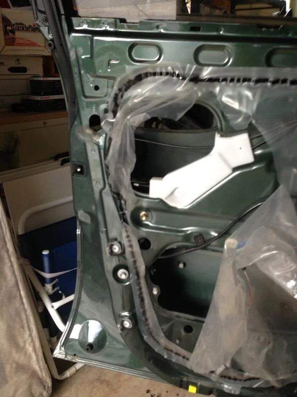

what timely post...I said screw it yesterday and got it off. I left the actuator in the door and managed to undo the screws and get the shell/clamp/ out.
How in the world did you manage that? Did you unscrew the actuator, and kick it sideways to undo the screws on the side of the clam/shell ?
I have my door half pulled apart right now. I'm ready to pull the entire assembly out, but I have to drive somewhere shortly. I'll be pulling it out later this evening or tomorrow morning.
Most of this process has been fairly easy, but trying to put the details together on how to pull the actual actuator out has been a little sketchy.
Swapped a bad motor out today.
Thanks everyone who took the time to take pictures and explain things.
The hardest part to me was getting the actuator out, and getting the clamshell apart.
To remove the actuator from the car, you must unhook the two top linkages to the exterior door handle, the white plastic shroud over the cables to the lock/inside handle, disconnect the cables from the inside door lock/handle, unscrew the window track bolt, and 3 screws that hold the actuator in place on the door. At that point, you should be able to slide the actuator down and out of the lower hole. Unplug the wiring harness at some point as well.
For opening the clamshell, just heating it up was not enough for me. I tried screw drivers, chisel, love taps, etc. After I let it sit in my dehydrator for an hour or so, I used an Irwin quick grip clamp. I clamped the clamshell in sideways where one side was touching the top piece, and one touching the bottom and began cranking down with it. This did end up with a small amount of breakage, but I used the same epoxy to put that piece back in as I was going to use to seal the lid back up. I also was unable to just use a little epoxy in a few places. I tried this and the motor just opened it right back up.
A special thanks to JonHaris for taking the time to stock the motors and provide assistance as needed.
I could not get epoxy to hold the clamshell halves together. So I added a loop of wire and twisted it tight. Sorta redneck. Worked great.
