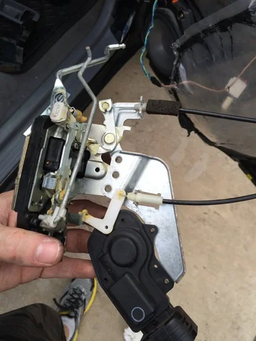

Just replaced passenger side actuator and there's a very slight rattle when closing the door. This was at the bottom of the door...
Anyone remember where this goes? I really don't want to pull the other door panel looking for the match.
Thanks.

Not a big deal. It covers a nub end. You'll never know it's gone......
Thanks very much. I think I found out where it goes. There is a external nipple on the actuator motor case that leads to the inside rear of the motor. Maybe for condensation drainage or avoidance? My case had water inside, a lot, so much that the motor was very rusted and seized.
Now I am putting everything back together and would appreciate some help with a question: Does the lock actuator assembly go on the inside of the window guide or does it go on the outside of the window guide (outside being the outside of the Land Cruiser and inside being the passenger side of the door)? Thanks for all the post. They were invaluable.
Outside, I remember it took some finagling (spelling?) to work it back behind the window guide. Then I realized it was pretty easy to just remove the single bolt holding the window guide. These might help:
