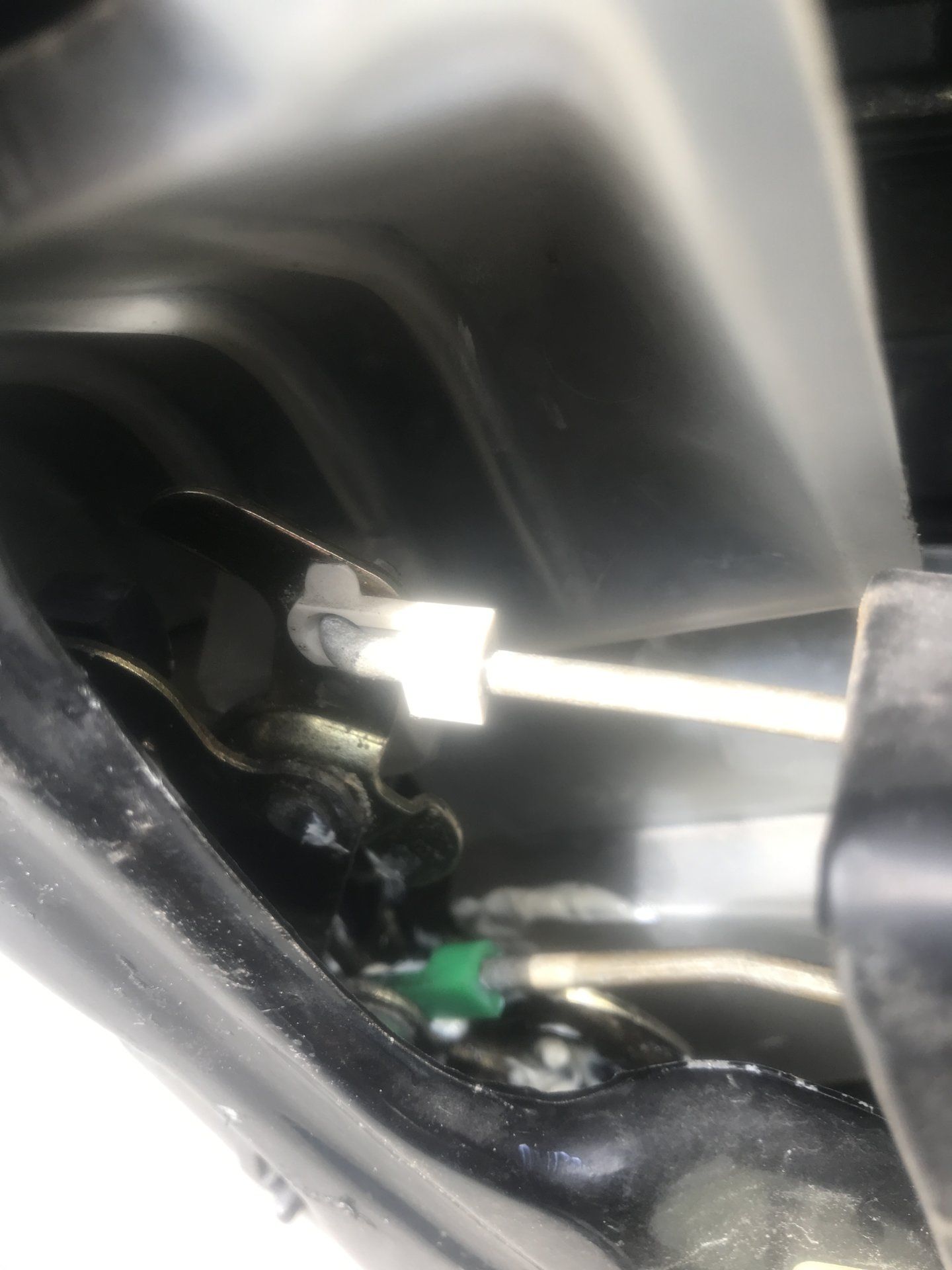

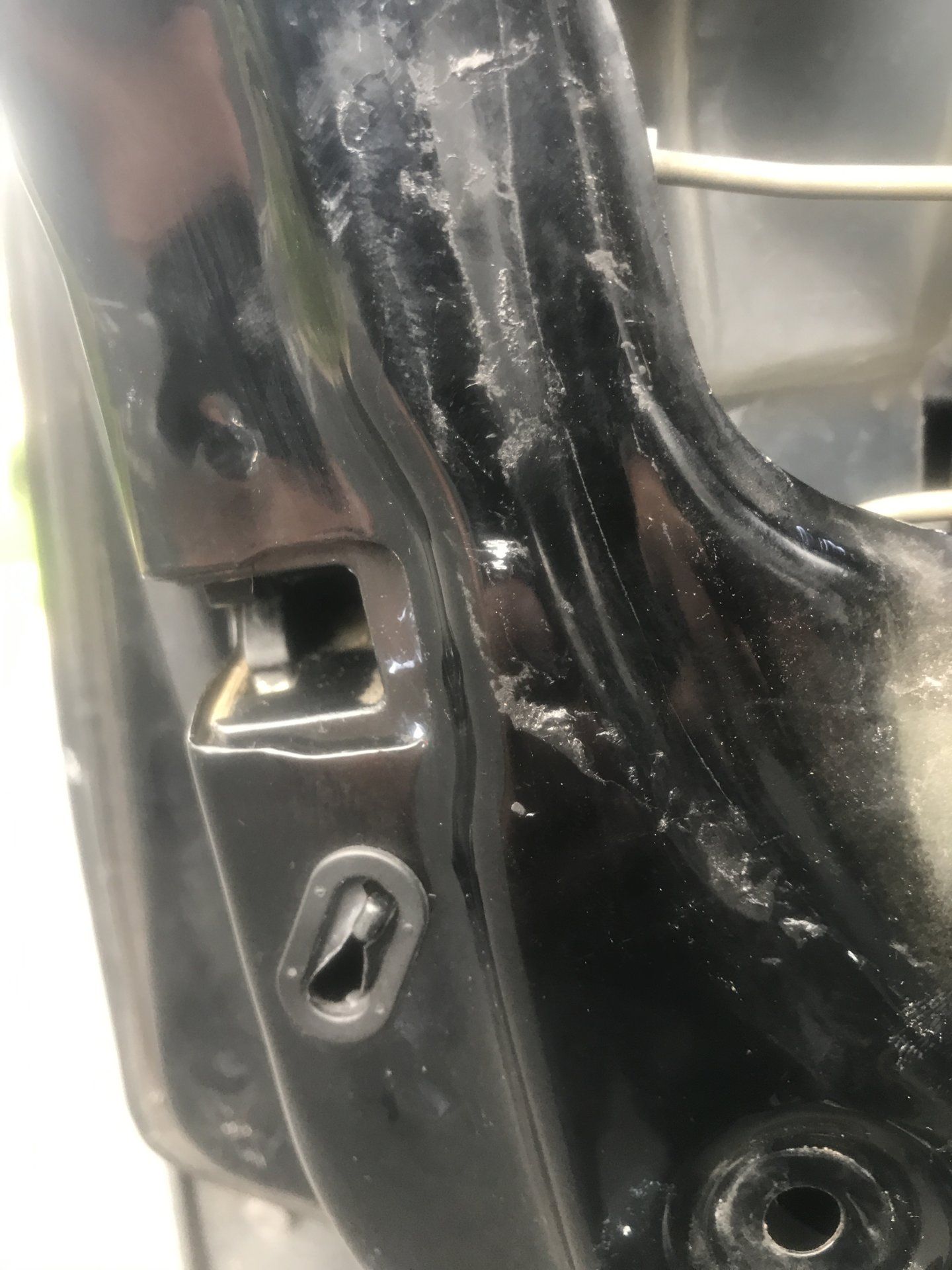

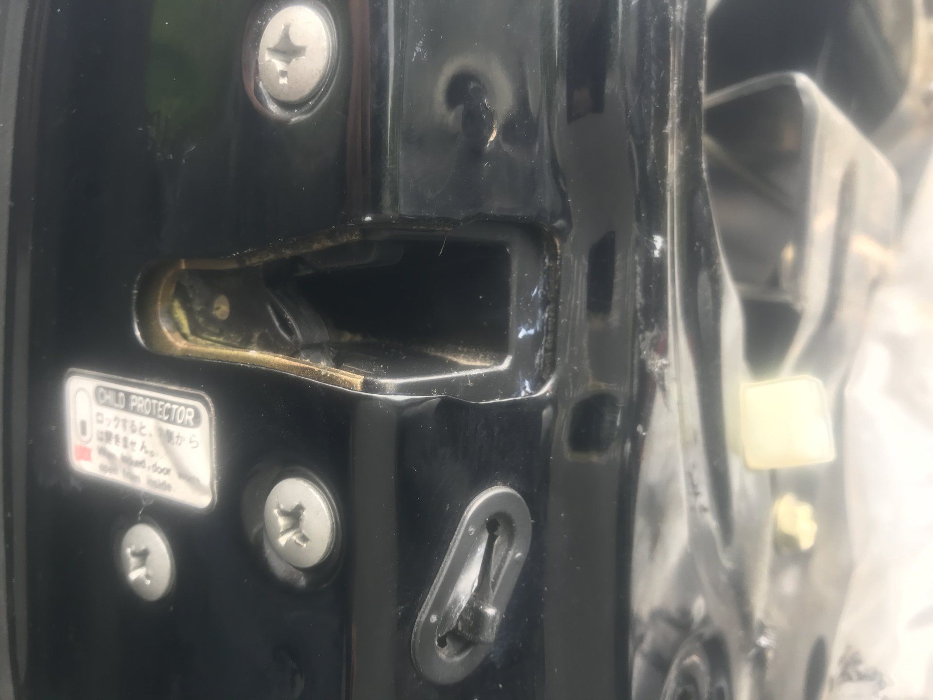

i’m testing the left rear door lock after installing a new lock actuator and i’m not sure if i need to “set” the lock mechanism at the end of the door or if i need to reattach the wires with the handle extended (or something) or if i have something out of place (or all three).
right now with the doors closed the rear will now lock and unlock when i use the DS controls (previously the rear DS only worked manually).
BUT when i try to /unlock/ the door with either the interior handle or the exterior handle it will not open even though the door lock thing is in the unlocked position.
i did feed the exterior door handle out with the whole assembly because i couldn’t get one wire unhooked but i am hoping i don’t have to get it and re-arrange great whole set of mechanisms inside the sheet metal if at all possible.

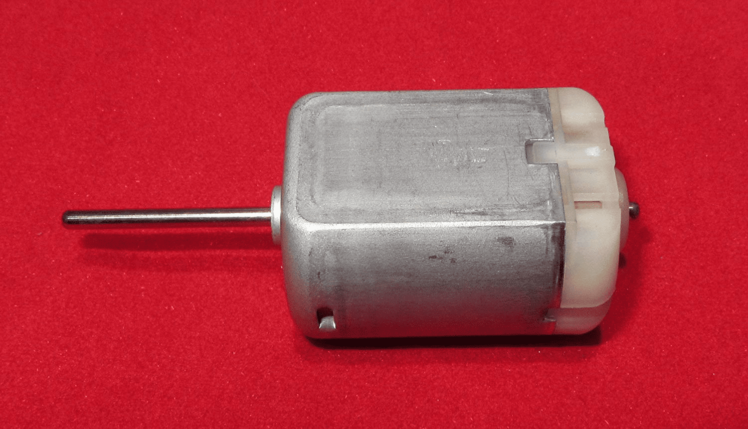

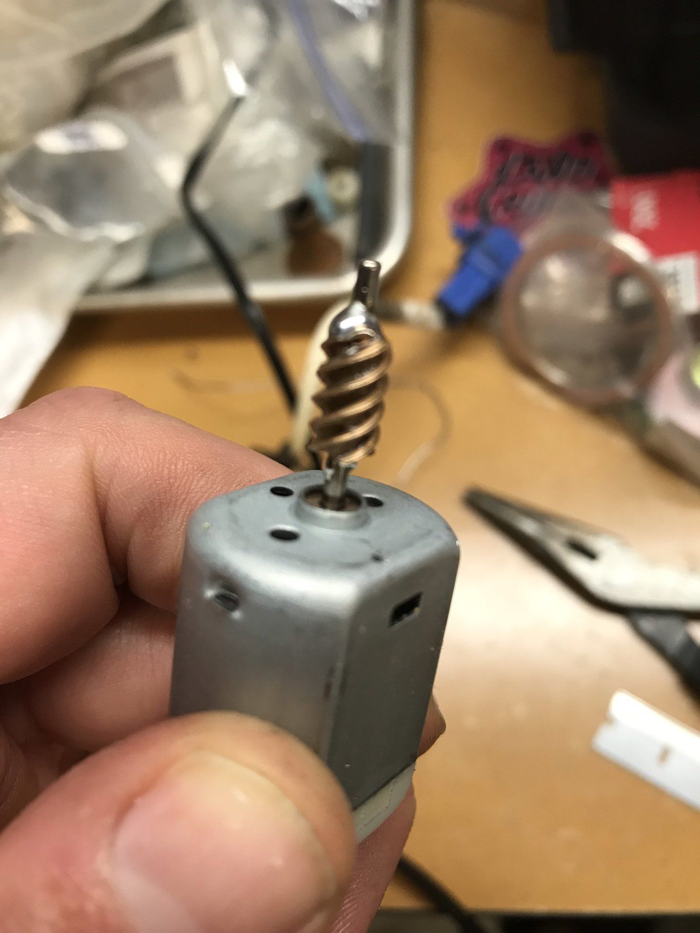

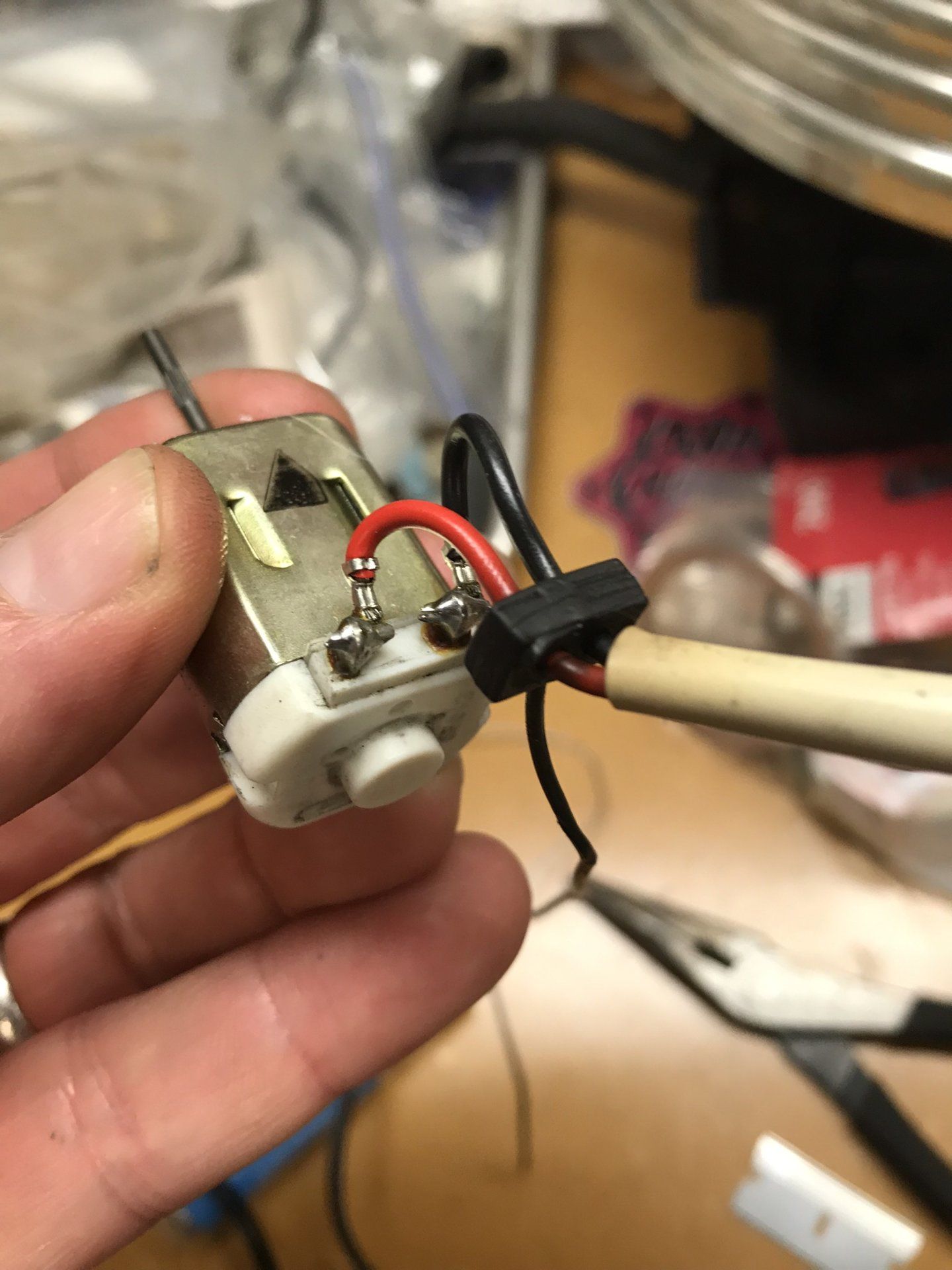

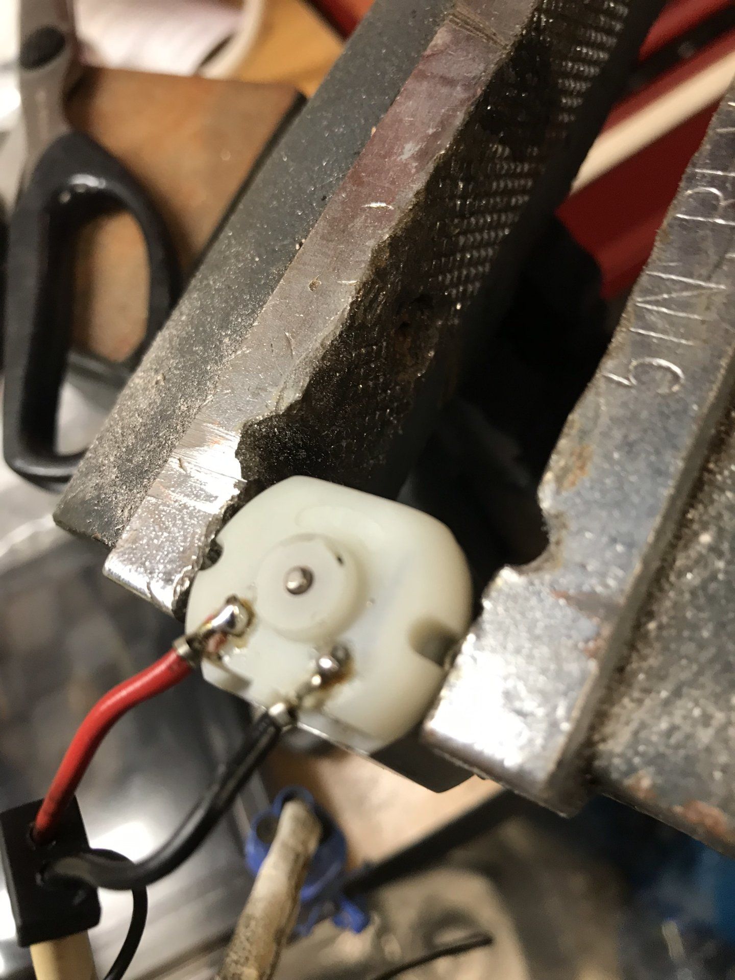

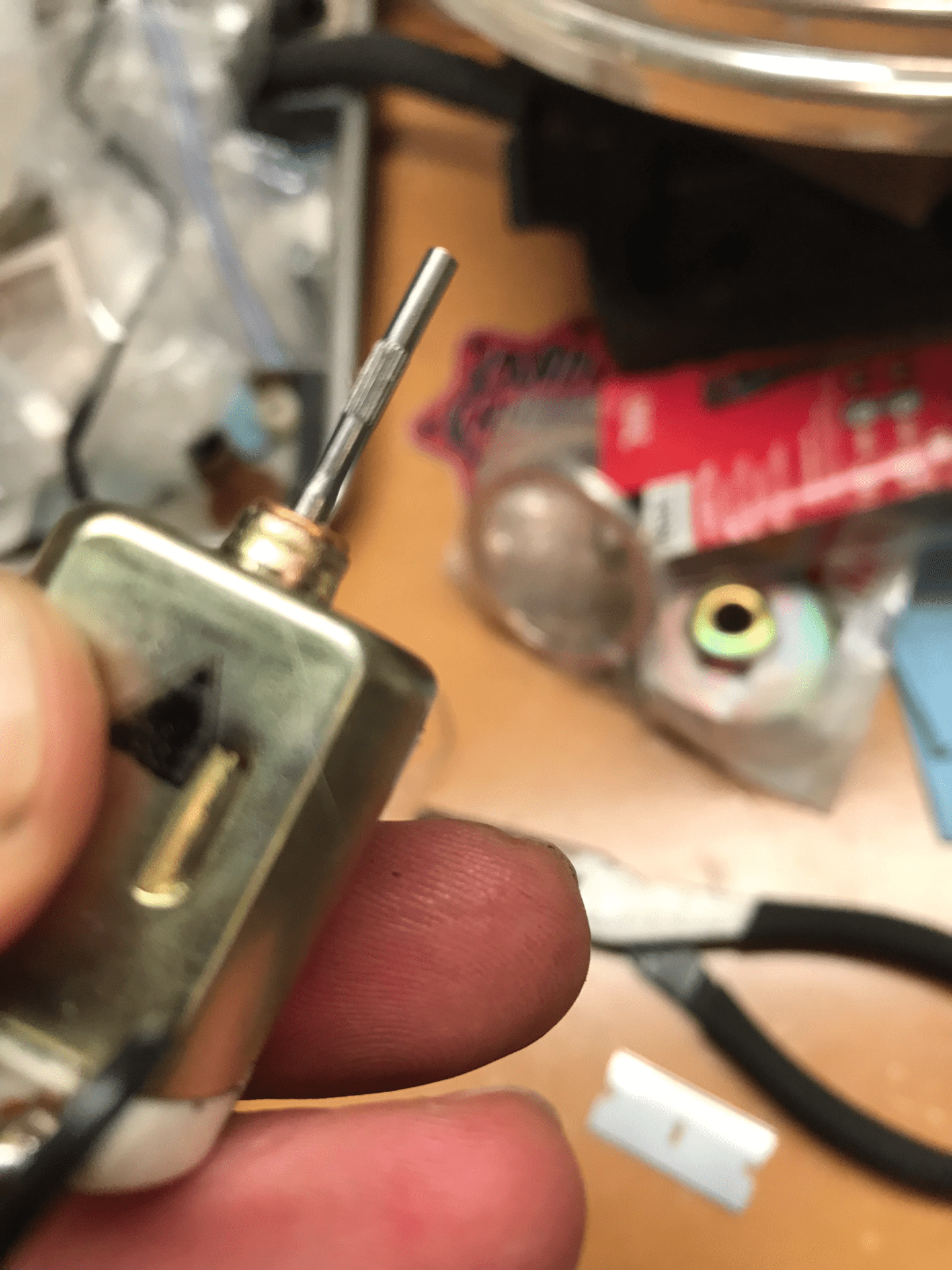

So went a different route based on some other post from the 100 series section as my motor was burned up. If you open up the actuator per the Texas Know How video the motor is easy to replace and cost like 6 bucks on Amazon.
Motor FC-280PC-22125
I bought this tool to pull the gear. You can find them cheaper but the less expensive ones are shipped from China. Last item I ordered from China never showed up.
1982180
The first picture shows the original motor. You can see the shaft has splines (?). You can see in the second picture the new motor does not have splines. Third picture shows the gear soldered on. A small zip tie between the gear and the motor kept the gear in the right location for soldering and was easily cut off after the gear was secured. If there is a better to do this way I am open to instruction. New motor also does not have the little bridge that the wires attach to. Mind the polarity!! I had to switch the wires at the plug because the way I attached the wires cause the lock to unlock when all the other locks locked. It is a tight fit putting the motor back it. Put in the wire end first and it will go in fine. Definitely louder that the others but works like a champ .

BTW here's the 3rd picture from above. I'd posted too many pictures.
Hey @Cruiser804 how did you fit the worm Gear back on to the motor.. was it easy to just put it on the new motor shaft? or did you have to Heat the worm gear and then fit it back on to the Shaft? I cannot find anywhere on the internet on how to fit the gear back on the shaft..
I have ordered the Gear removal kit you have and a similar motor you have with the straight shaft. I am guessing I need to get gear out from my old motor and put it back on to the new motor and put it back together. Hope this works. I love fixing things that are needed instead of buying a whole new DLA assembly.
TIA.
Thanks
its been a while since I did this but IIRC I did not have to heat it but it may have required some encouragement

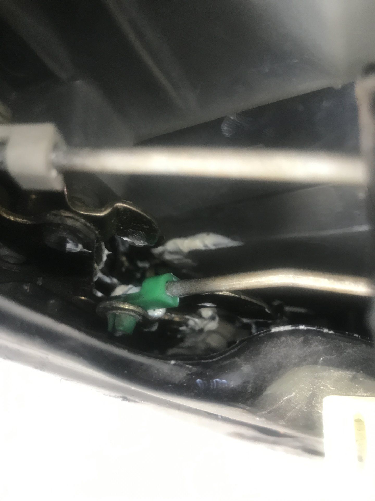

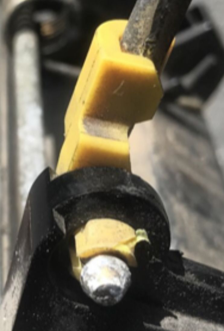

Reviving this in hopes somebody has advice for getting this bugger off. Flipped up the yellow clip, but WD40 didn’t do the trick for me, and this rod does not want to come off. Anybody else struggle before finally getting it off?
IIRC, looking at the photo below, first push/pull the top of the yellow clip away from the rod (to the left) while holding the rod
with one hand and pulling the yellow tabs that run along the side of the rod with the other.
Then pinch the round plastic halves that encircle the short section of rod that goes though the hole in the black plastic piece.
You may need a small pair of needle nose pliers to squeeze the clip halves together inward toward the rod, then push/pull the short section of rod out with the yellow clip (push them both out together from the black plastic in the photo below).
with one hand, pulling the yellow tabs that run along the side of the rod with the other.
Thanks Kernal. I tried the pliers but the yellow clip doesn’t squeeze through for me either. I ended up removing the entire door handle like OP did to get the actuator out. Oh well!

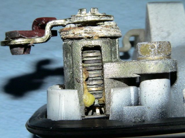

@Seabert : The silver lining is that with the (front) door handle removed you clean the lock cylinder a bit easier with an aerosol cleaner, ie: blast the cylinder clean via the key slot, tap, turn the key, spray, tap, repeat, repeat, repeat, followed by re-lubing the lock cylinder.
IME the original grease will have turned to something like candle wax by now, so removing that dried out grease followed by a quality lock lube you'll be good for a long time. FWIW KRYTOX (PTFE) grease won't ever dry out, it's expensive but you don't need much. I disassembled the driver's side door lock cylinder on my 96 Model 14 years ago, cleaned and lubed the cylinder with KRYTOX, and it's still smooth as butter.
For those who've never seen what the original door lock cylinder looks like after 20+ years:
IME the original grease will have turned to something like candle wax by now, so removing that dried out grease followed by a quality lock lube you'll be good for a long time. FWIW KRYTOX (PTFE) grease won't ever dry out, it's expensive but you don't need much. I did disassembled the driver's side door lock cylinder 14 years ago, cleaned a lube with KRYTOX, and it's still smooth as butter.
For those who've never what the original door lock cylinder looks like after 20+ years:
