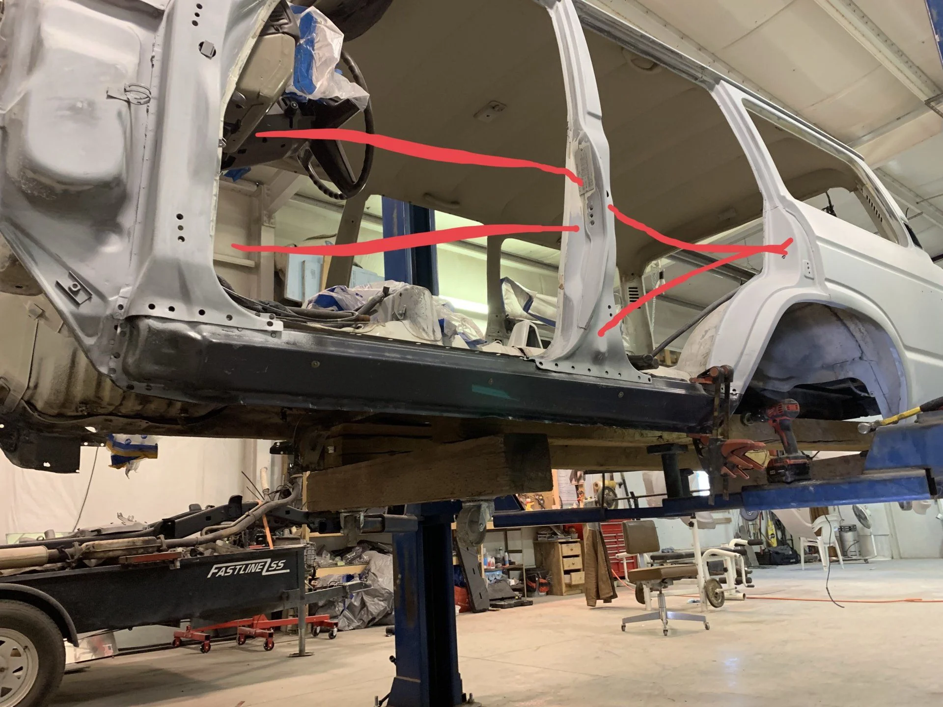

Hey y’all, I need bolt hole to bolt hole distance for the doors so they align properly after replacing the rockers. I don’t want to go through the trouble of replacing these rockers and then have the doors not shut right.
Thanks
Here is a pic
I highly suggest you find/beg/borrow doors and hinges and mount it all up. Or, weld the rockers at both ends and leave 'B' pillar un-welded until you have installed the doors. Fitment of doors it too critical to leave to measured dimensions - you need actual doors in place.
10-4 I have the doors. I’ll use measurements and self tapping screws to hold it into place. Put the doors up to test it and if it fits, tack in the rocker and pillar.
