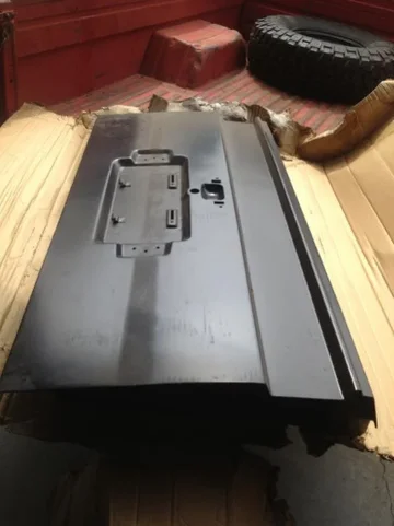

Wound up with a new gate that the original sales ticket stated "78 FJ-55" (has vin on ticket too, which I need to find, to determine production date).

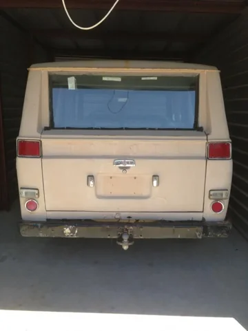

Keep in mind, part of a package deal, but originally intended for the 72 strict resto, to replace this tailgate.
I'm sure you can see what's wrong with it, considering a 72, but at the time, I assumed it was an OE 72 tailgate, which this would've matched, once I cut the embossed off the older out and sectioning into it.
(^^again, ticket on new claims 78)
Then yesterday, Texican posted a 78 for purpose of determine paint scheme accuracy and it is the later style gate. (On left).
All that said, I can't use the new gate on the 72 since the lights aren't correct and don't have need for new gate on 76, since it's not in bad shape, as far as I can tell.
Have a 71 gate for 72 that is accurate, so now have an unknown, or incorrectly dated gate per invoice, and reason for querying.
Need be, will use on 76, but don't think need exists, so not sure what'll become of it.
forgot all about the tail light change in 78 and 79...the new gate you have must be for early half of 78...I think the TL change up was in sept of 78. toyotas mid year change ups sure did cause some confusion over the years. the production year for a given vintage ended in august, with the next years model starting production in september...who's gunna be the lucky bastage what ends up with the NOS tailgate?...FWIW, the earlier gates would work on the later models albeit with an offish appearance
