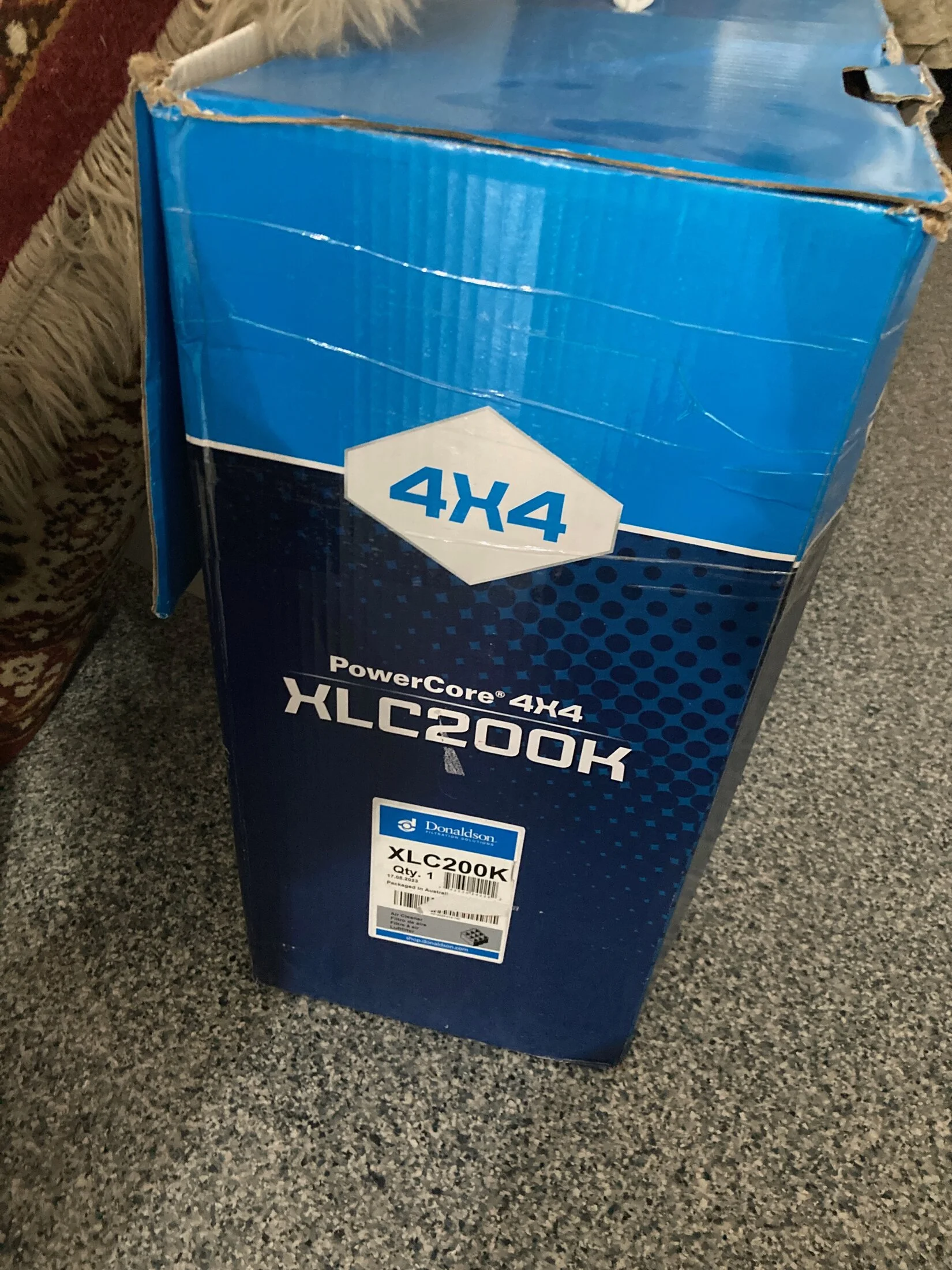

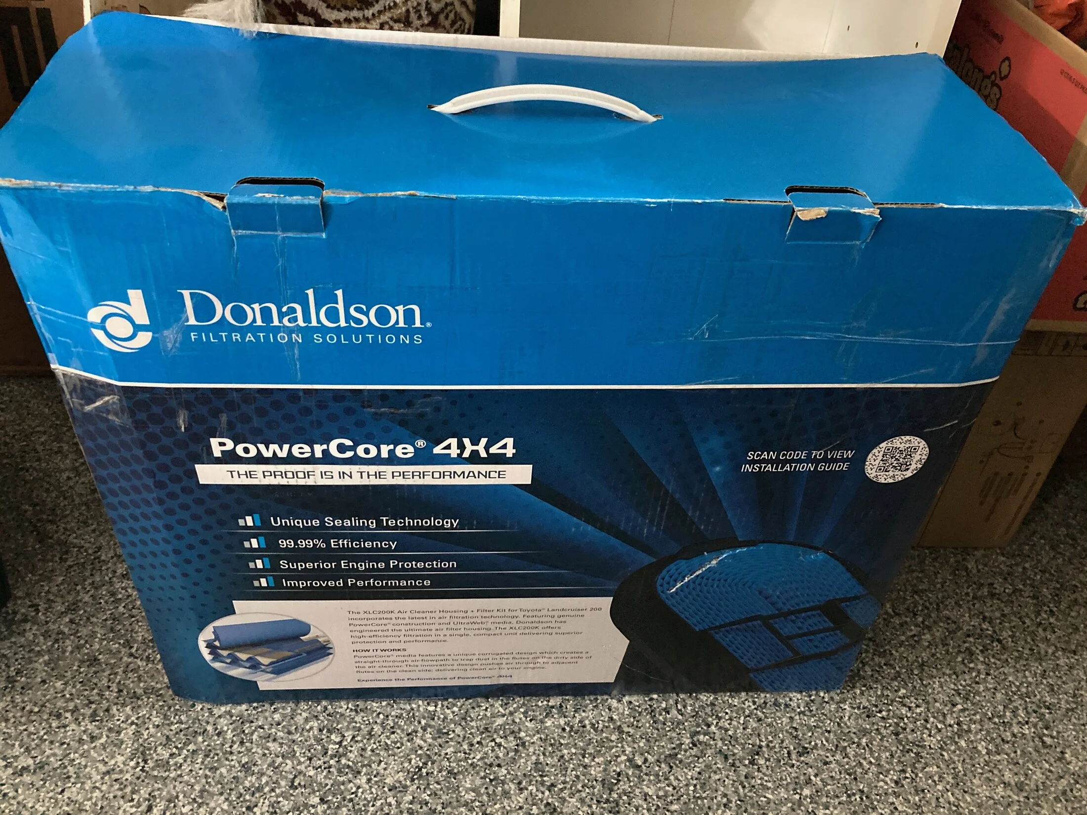

I ordered the only type available shown below in my garage. It is specifically designed for the 4.5TD but can be used in the 4.7 and 5.7 gasser models. There is a rumor they don't work for the gassers but I have read someone (here on mud possibly?) who has done it. Hope that helps.
