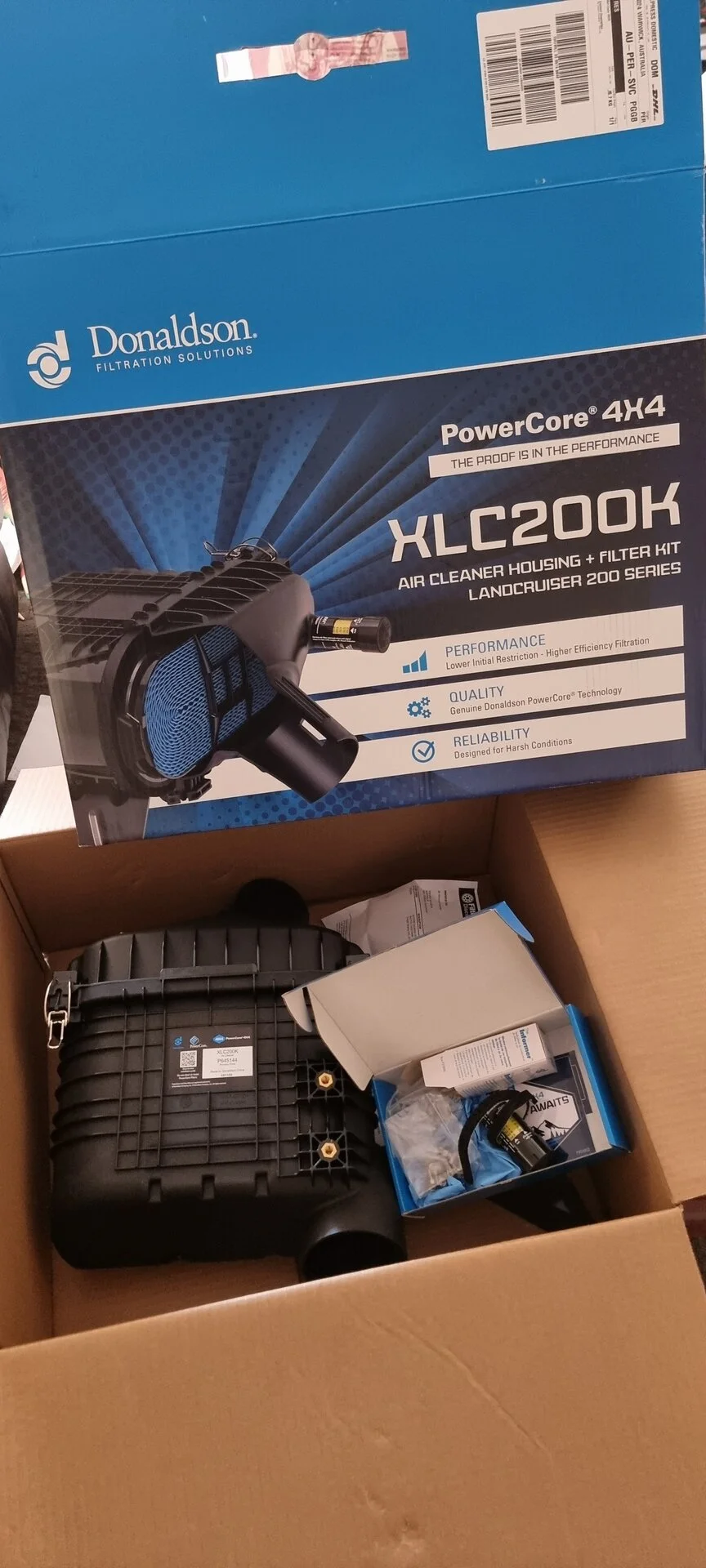

I received my Donaldson XLC200K filter kit recently, and proceeded to install to my AU LX570 today. As expected it fitted without any unexpected issues.
The inlet matched my Safari snorkel hose, the outlet orientation was suited to the 3UR intake, the MAF direct fitted fine, and the overall height just cleared the hood liner, just. Overall the quality and appearance is OE, very nice.
However, beware the Donaldson outlet OD (designed for the diesel) is 4mm smaller in diameter than the OE Denso outlet, so the intake hose needs a suitable clamp to make the seal properly. The LX cosmetic dress panel will not fit as the filter canister height is 20mm higher than the panel height.
Also in response to Brian’s query above, the ID of the tube where the MAF sits is around 2.4mm smaller, so potentially the air flow calcs might be a bit off…? I believe the 4.6 and 5.7L both share the same part number OE filter lids.

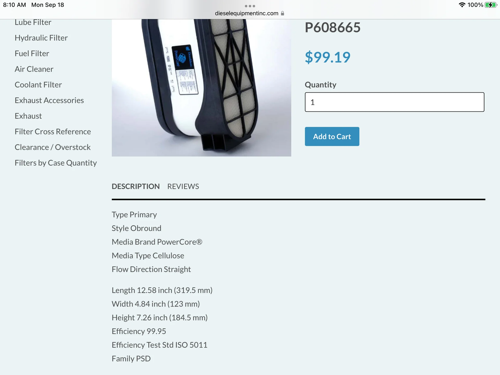

By looking at the Powercore filter size, it can be determined that Donaldson based this 200 Series unit on the Powercore PSD09 Air Cleaner. The PSD series comes in various sizes and configurations. There are also several different filters of varying efficiency and flow capabilities.
Do note that the filter for the 200 kit appears to be specific to the application. The off the shelf PSD09 filter will not fit it.
