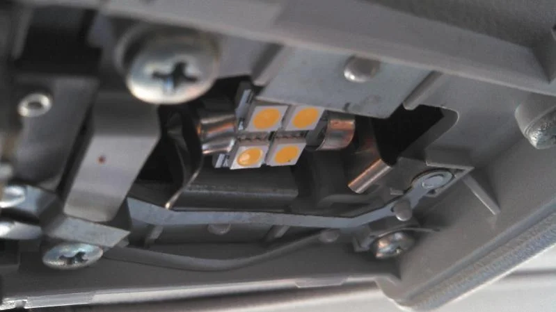

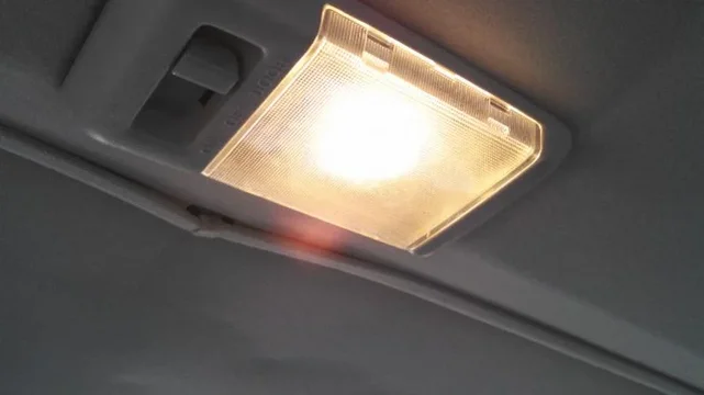

Yeah i had checked every door switch and that all screws were grounding the fixtures and the fuse for dome lights. Fix was get rid of OEM bulbs and install LEDs, now they work great !! who woulda thought $4.87 on eBay would make it light up nice and bright.
