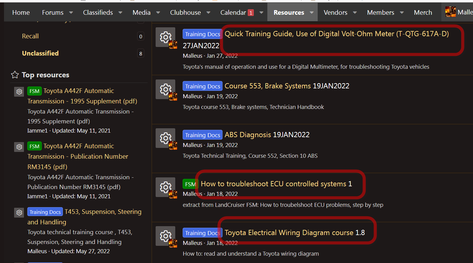

There are Toyota technical training publications, if you want to know how Toyota goes about it. I'd start with the Electrical Wiring Diagram(s) for your truck(s). The first several pages explain basic troubleshooting. There are also Toyota publications on how to use a digital multimeter (DMM) for troubleshooting Toyota systems.
Look in the Resources section under the heading "UNCLASSIFIED":
This is a great starting point. Thanks - So cool that Toyota has publications on how to use the DMM among other things!
