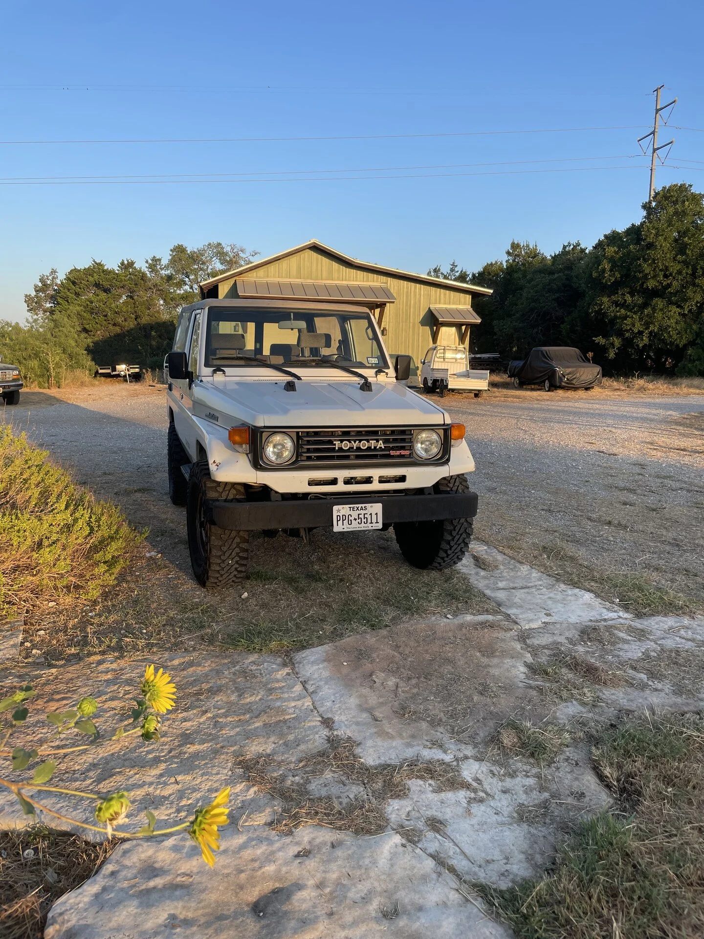

Yeah, I have a homebrew HDJ74.
It started life as a RHD BJ74, and over several iterations of its life, now is LHD, 1HDT/G turbo, front coils, factory a/c, and a soft top conversion.
You have to build something like this or have someone build it for you. Several fun tokens, for sure.

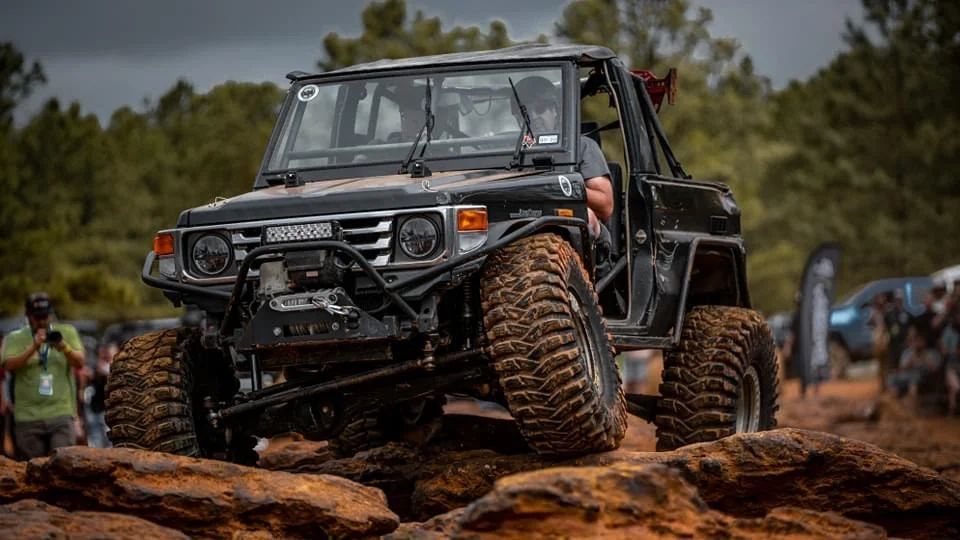

Then there is also this thing if you want offroad capabilities
@joekatana you KNOW how bad I want that crawler to come live with me. You also know just how bad the timing is right now!
