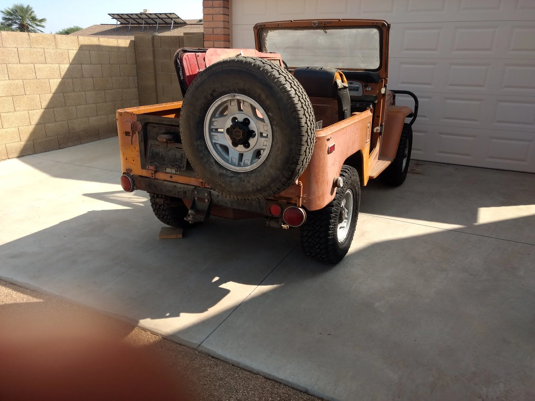

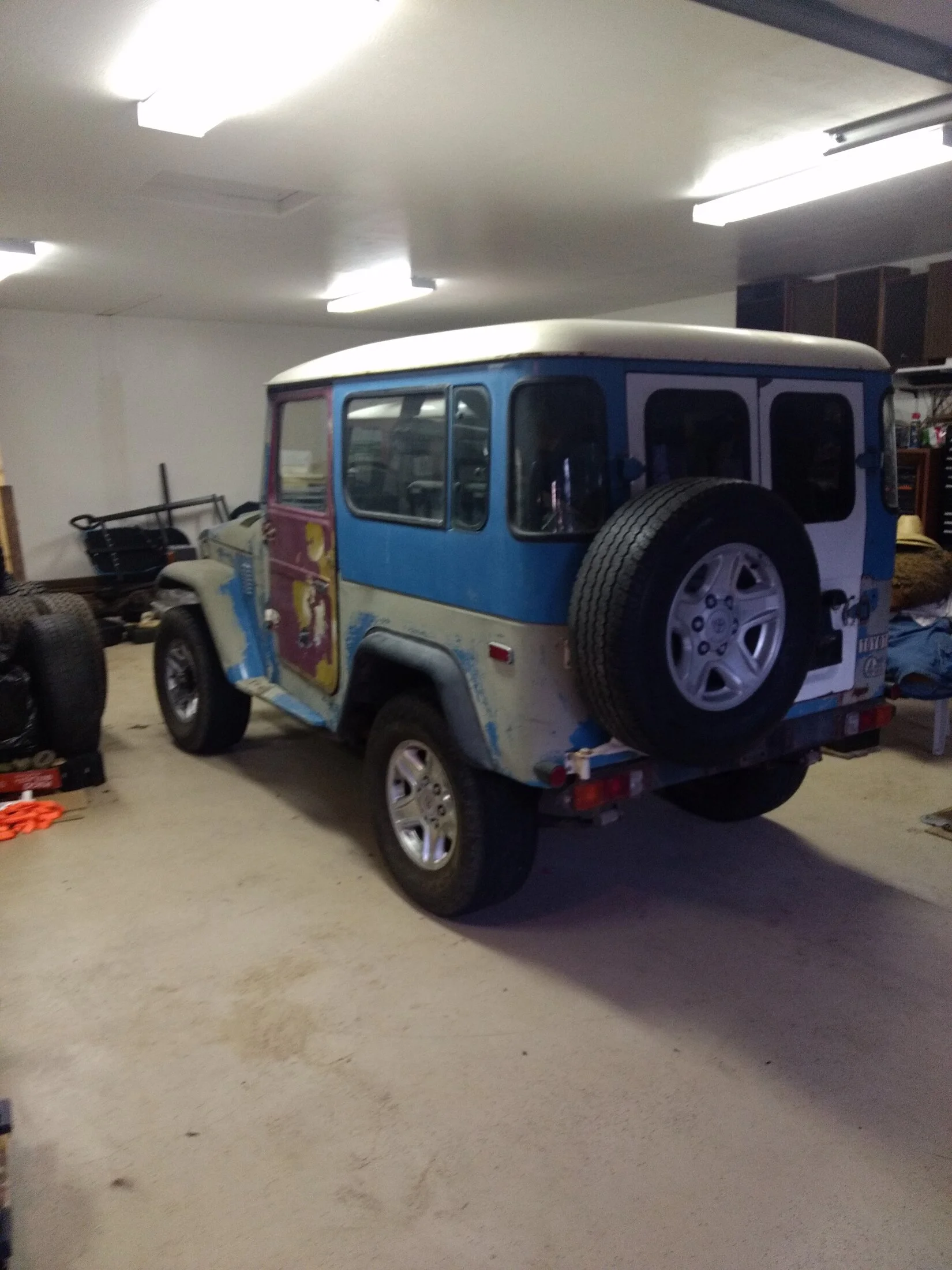

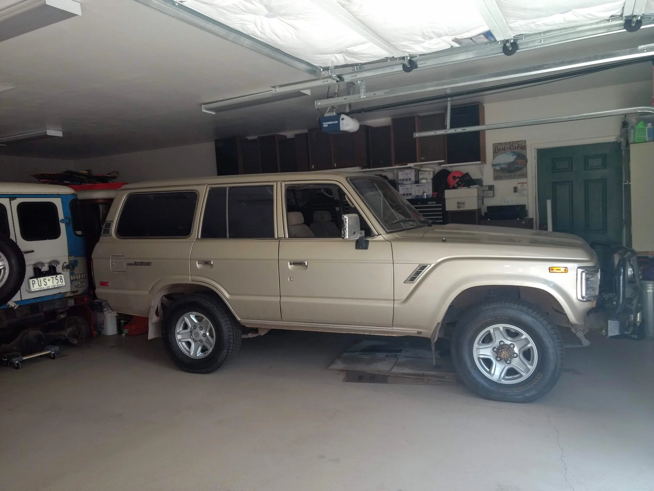

Center hole probably big enough but have never found later Toyota wheels that the back spacing cleared without spacers on the front axles.
All three of these required front wheel spacers. 40s also needed them for the spares tire carriers. Sequoia could have 17". But even if they clear dished that far with the larger diameter would restrict steering. Particularly on the driver's side with the stock steering. Would hit thew drag link.
